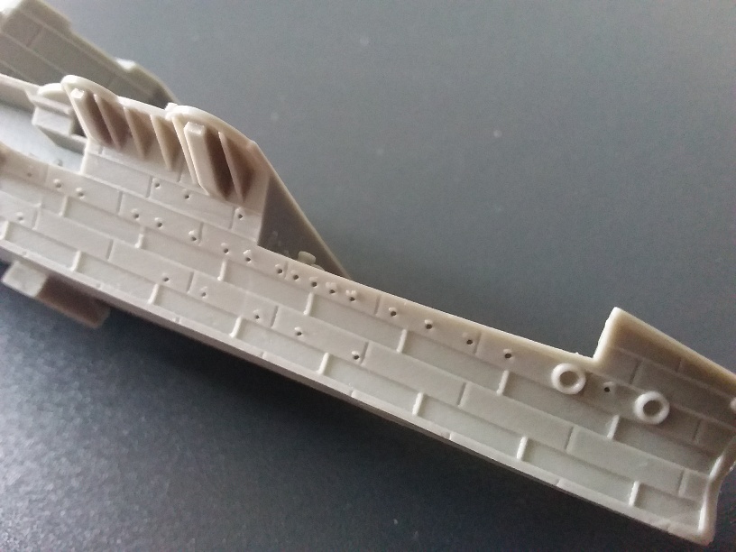

I too took the bait after reading the story about the sinking of HMS Glorious in Summer 2022 MHQ's Ghosts Of Glorious article. My first impression was jut like Gcj's - a lot of detail in an ambitious resin molding, but many negatives. I had a spinner - the long hull was warped front and back, and am still trying to find the right combination of heating and cooling to keep it from returning to HMS Banana. I also had numerous mold release marks that looked like scars all over the hull and parts. Worse, test fitting the flight deck led to broken forward corners, likely because of the hull warpage. After setting it aside to finish an IMPSUSA review, I started again for an IMPSUSA paint set review.
Noticed that the resin pieces are very brittle and soft, a bad combination for handling.
Triumph Swordfish aircraft scaled out to 90% of actual dimensions, and looked small compared to old Aoshima Swordfish, which scaled to 96% length and 109% wingspan of actual dimensions. Gladiators and Hurricanes were 93-95% of actual scale dimensions. Detail of aircraft was excellent, and the tiny decals looked fine, except they were not the proper two-color for upper wing roundels. Be sure to cut out and cutoff extra backing on the decals - the whole sheet is a single decal. The biplanes had very thick wing supports. but am keeping them to show the incongruity of the details.
The bridge did not have the 1940 deckhouse, which is easy to scratchbuild.
Not looking forward to painting the decks under the overhanging flight deck - finally found a use for that bent-tip paintbrush.
Work in progress.
File comment: Starboard Forward Hull Mold Marks
HMS Glorious CV 299a020 1940 Triumph TM70001 Bucci Stbrd Frwd Mold Marks.jpg
HMS Glorious CV 299a020 1940 Triumph TM70001 Bucci Stbrd Frwd Mold Marks.jpg [ 181.77 KiB | Viewed 1195 times ]

Update on Triumph HMS Glorious by lukebucci:
Solved the bent resin hull by leaving it on a metal railing with two 20 pound dumbbells (one on each end carefully placed bow and stern with padding). That kept the hull flat. After a week of Northern Nevada sun and heat, it stayed flat!
