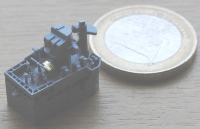

PostPosted: Mon Mar 02, 2015 4:31 pm
Posts: 1548
Thanks for pointing out those differences. Will need to add some styrene then for Cleopatra.
I agree with your comments so far. I did have some problems in getting the funnel steam pipes to seperate form the sprue gate and broke on of them in three pieces. OTOH it means I only had to build one steam pipe out of stainless steel rod instead of all of them as they are really thin - about 0,3 mm.
Mike E. wrote:
Several of the early Dido class cruisers were nearly identical sisters, so you should be able to use this kit to build several other ships in the class—Bonaventure, Dido, Euryalus, and Hermione—without major modifications (except, perhaps, removing or relocating the fine degaussing cable molded onto the hull). Argonaut, Cleopatra, and Phoebe either had quad 40mm guns in the C turret position, or portholes instead of the rectangular open gallery on either side of the wheel house on the bridge, so to model those ships, a bit more work would be required.

PostPosted: Wed Mar 04, 2015 2:25 pm
Posts: 1548
Thanks Mike. I've just realized that I should have seen this bridge detail on the IWM site - many pictures of the Dido's are online now. Note that contrary to what's mentioned in Raven & Roberts Cleopatra still had .5in machine guns when she entered service (picture A7062).
