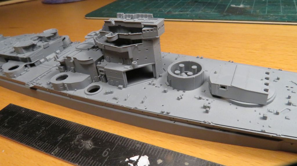

I also got the kit and started it yesterday.
The first impression is great. The fit of the deckhouses is tighter than on the Naiad, which is good.
But yes the molded on reels are a let down and than there are no reels on the pe fret.
And it also seems the pe is thicker than in the Naiad kit, on thing I relized also in the Kongo 1914 kit.
Also there are no pe anchors included, but some pe parts for the Pom Poms.
As always that is high nitpicking from me and no problem o solve. But for the Rolls Royce under the kitmakers I thought of more :D
