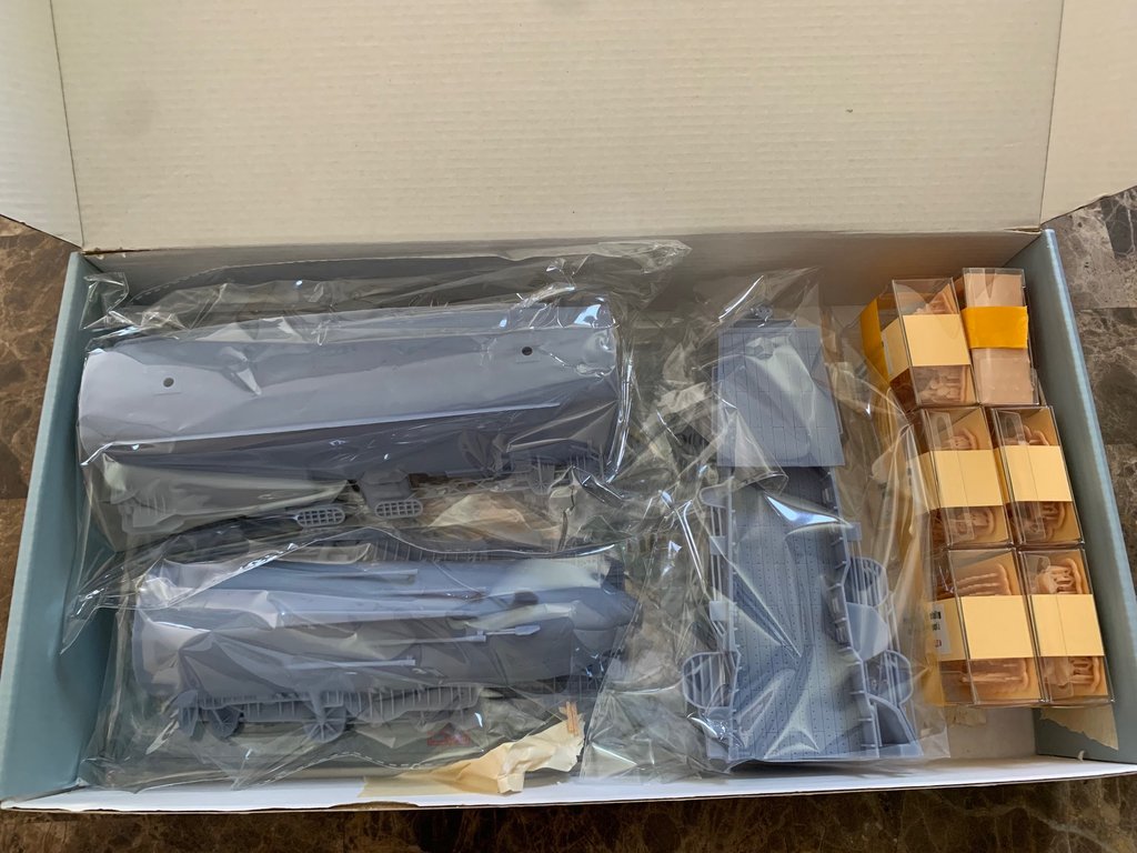

Kit comes in a very nice full color box
Kit contents are very nicely packed

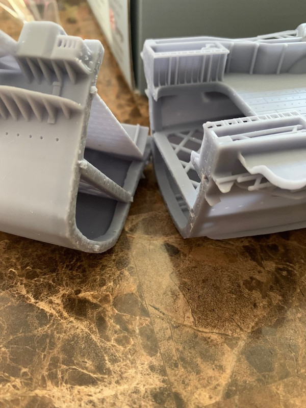

I understand that 3D Wild is actively engaged in taking constructive feedback about their kits. Since these kits utilize multi part hulls, they reacted to feedback on their Ryujo kit and adding locators pins to help align the hull parts

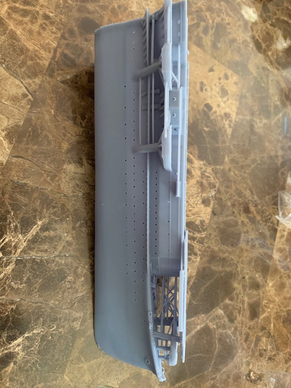

With just some quick cleanup, the hull parts dry fit together very nicely. With some more dedicated time, mating the hull parts up should go fairly well
The amount of detail is very impressive with what is already printed into the hull.

- Hull locators help the hull but some platforms may be tricky
- *The amount of already printed on will make detailing and painting tricky. Example being the aft part of the flight deck is already in place over the boat deck

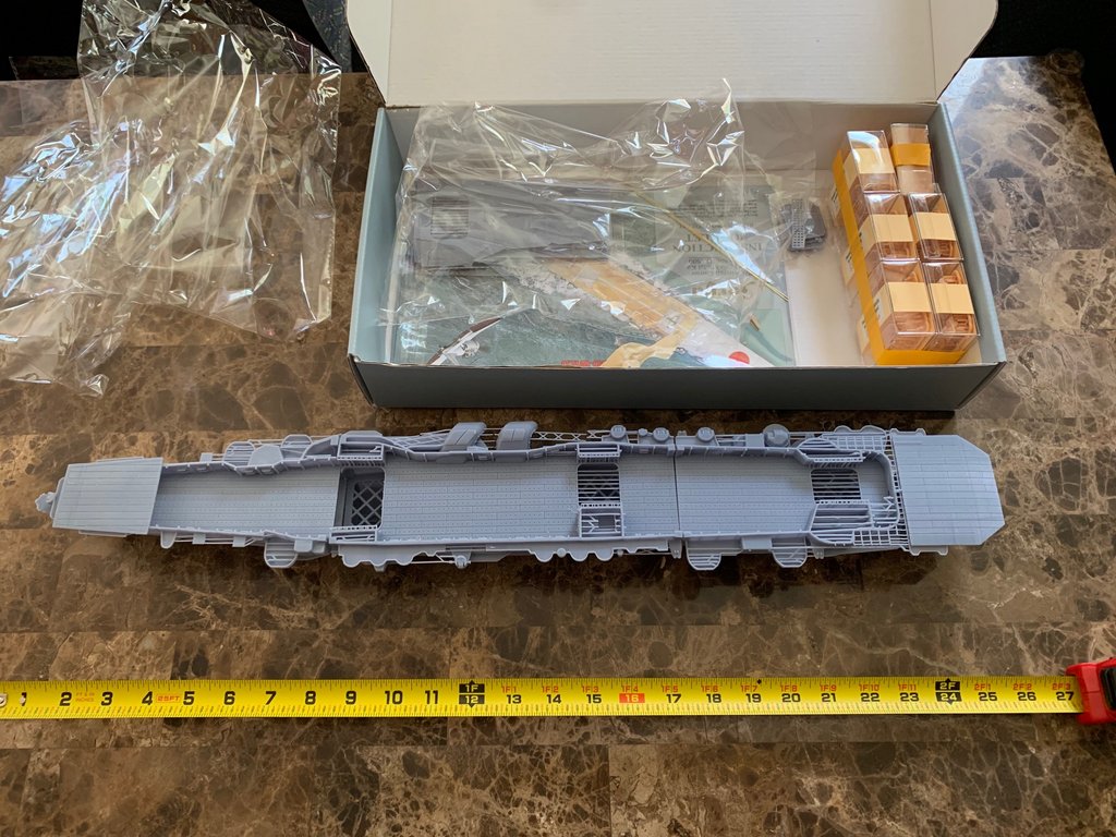

- The flight deck is very thin which appears to be in scale to make the elevators poseable, they will be prone to warpage and may require some careful reinforcement in out of sight areas. The forward flight deck on my example was very badly warped and broken near where the island is mounted. Perhaps on their future carriers or releases of this kit they can leverage their partnership with Chuanyu Models to have the flight decks etched in thicker brass to help with this issue?
