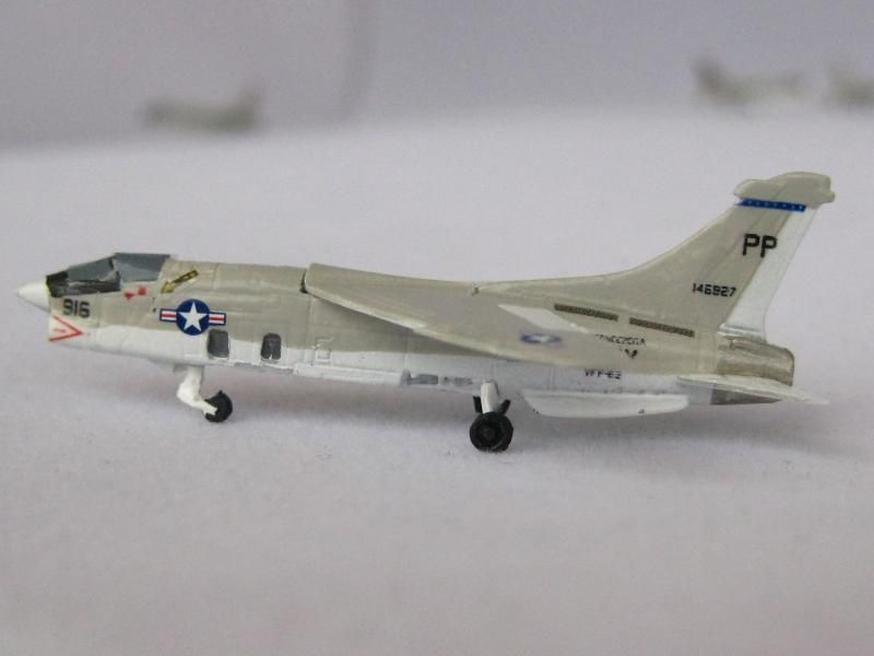

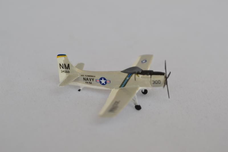

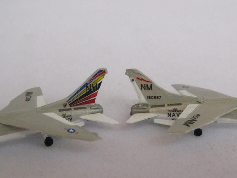

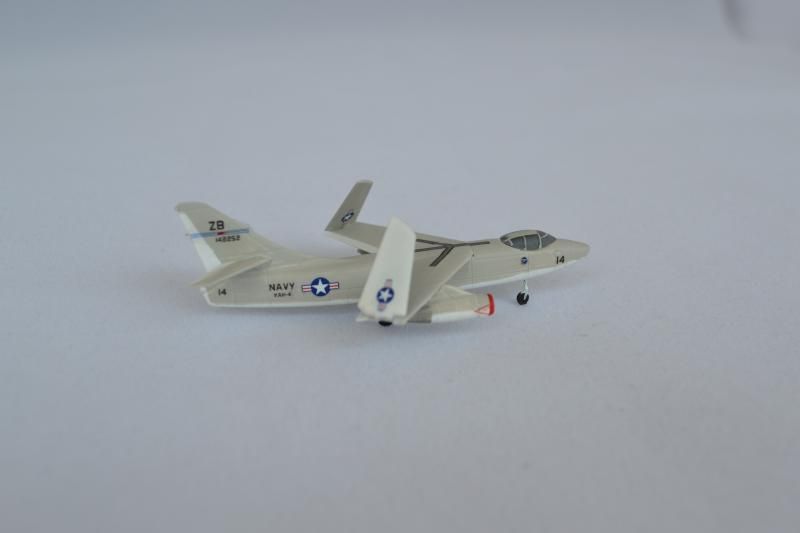

I got an early start on CVW-19 for a Ticonderoga 1967 so I had about half the airwing done prior to getting the kit. The decals are mine except the "bars and stars" that are from various Trumpeter Aircraft sets I have.
The "Spads" are from L'Arsenal. I used landing gear from 1/350 scale Tamiya Tomcats to get a nice sturdy gear with the brace behind the main mount.
Both the F-8E and RF-8G's are from Corsair Armada. The Gallery Crusaders do not have the ventral fins. They may be a bit overscaled in the fuselage but they have the same wing span and length as the Gallery Crusaders. I think that they will look correct on the ship with the wings folded. I also like the fact that you can get both F-8's and RF-8's.
The Trumpeter A-3D is really an early EA-3. To make an A-3B for this era (1967), trim off the ECM Pod from the bottom of the aircraft and smooth it out.
I am waiting for some L'Arsenal A-4 Skyhawks to complete the airwing. I think the Gallery A-4 is underscaled a bit. I also need to finish the Willy Fud and the Seaprite Helo's. The canopies for the Crusaders are from Gold Medal Models canopy sets. I used the A-7 canopy for the F-8's. The Spad and A-3B are painted Gunship Gray.
VA-52
VF-191
VF-194 CAG Bird
VF-194
VFP-63
VAH-4
They look great until you take pics! Then you see all of the errors.

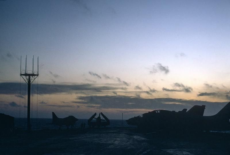

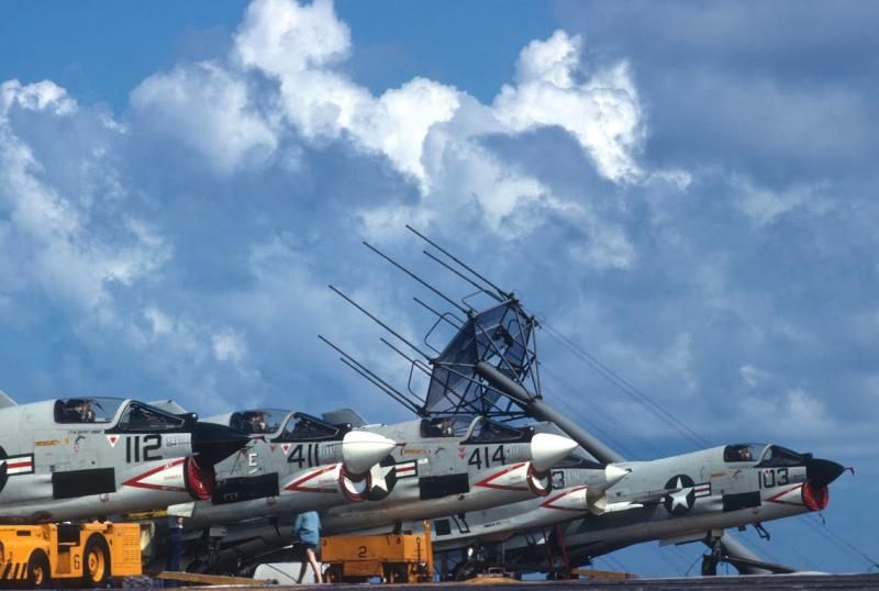

My friend, Jerry Beasley, who served on the Tico asked me to post these antenna photos to see if anyone could identify what type of antenna this is. These pictures were taken by him. Thanks in advance for your help.
Dave
PostPosted: Thu Feb 05, 2015 10:07 am
I was on the Facebook page for the Ticonderoga and found an explanation of what this antenna array was Ed Ofstad explained what it is as he was the the Radio Man that actually worked on it here is his explanation he also describes the 2 other antennas on the platforms on the starboard side if both Ticonderoga and Hancock(I think they are NTDS antennas ASSRA 57 or 58 ) Hope this Helps,
David Smith
MCB Camp Lejeune NC
Ed Ofstad Definitely not the Ticonderoga... We had the pickle fork antenna aft of the superstructure... It was the only one in the world, and it was mine....
July 20, 2014 at 6:37pm • Like • 2
Richard Momberger Ed Ofstad...can you enlighten us as to what the pickle fork antenna was used for and why we were the only ones to have it? Thanks.
July 25, 2014 at 3:09pm • Like
Ed Ofstad The pickle fork was a multiple whip MHF antenna... It had, if I remember correctly, eight whips on a platform about 10 feet across and mounted on a single pole which could be tilted seaward when launching and recovering aircraft... The whips were all attached to a netting of copper cables which surrounded the base of the platform and electrically lengthened the antennas ..It was fed by ten tuners which were a combination of capacitance and inductance in series and parallel to the antenna, and would also electrically lengthen and shorten the antenna in an attempt to reach the point of resonance..... The radio men would attempt to tune it to a SWR of 1:1 for maximum power out...`the advantage was that if the frequencies had enough split between them, we could put ten transmitters up on a single antenna... In Radio II we had around 30 MHF transmitters and if all were up and transmitting, we would have had to have an antenna for each one and we would have looked like a porcupine... If you remember we also had whips horizontal from the side of the ship and vertical on most levels of the superstructure...Why we were the only one to have one, is beside me... It might have been an experiment that didn't work out as planned... Our biggest concern was when the frequencies were not split far enough, it would result in jamming our own transmissions....We also had two bird cages, one forward and one aft of the superstructure, again an attempt to allow several transmissions on a single antenna...
July 25, 2014 at 4:25pm • Like • 3
Ed Ofstad You can see the pickle fork aft of the #3 elevator and the bird cage forward of the superstructure...

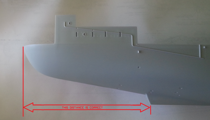

Hi, Roberto,
I think the scale-issue with the Interpid-kit has been answered by a research by Maarten Schönfeld in another thread on this forum in "Calling all Cold War Essex-class Fans!".
When putting the hulls of the Intrepid against the Trumpeter-kit I also noticed the difference in length as Martin did.
Maarten mailed me the building plans of the Essex, but the same info can also be seen in Mark's plans. The bow (Front Perpendicular) is at frame 0, the rudder axis (which seemed to me a better reference-point than waterline-length or overall lenght) is at frame 195. The distance between frames is 4 feet, so the distance between frame 0 and the rudder axis is 780 feet. In 1:350 scale this is 679.3 mm, or 26.74 inch. I measured this distance in the Gallery kit and came out at 678 mm, just 1.3 mm too short. Maarten did a check on his Trumpeter Essex hull and measured 695 mm, or 15 mm too long. See his post attached here.
You're right in building both kits as they are, as the hobby is to have fun from building, isn't it? They both will look as an Essex-class...
Walter
Gentlemen,
the only dimension of length which is of real use to us modelers is the Length between Perpendiculars (LBP or Lpp), as it a structural given for the naval architect and the engineers to design the ship structure. LBP is defined as the distance between the Forward Perpendicular (FP or FPP) and the Aft Perpendicular (AP or APP).
The FP is determined as the point where the Construction Waterline (CWL) intersects the bow (stem), and the AP where the CWL intersects the stern. CWL has very little to do with the real waterline, which is depending on the loading of the ship, hence Waterline Length can differ considerably from the LBP described above.
(Short note here: AP is often defined instead as the rudder axis, but this is not the case with the Essex class.)
So the key question is: where are FP and AP situated in case of the Essex? FP is at frame 0, forward edge of the stem at and below the CWL (Construction Waterline). AP is situated at frame 205, but this is not very clear in the drawings: someone scribbled 'AF' on the drawing at frame 205, but that point does not coincide exactly with the point where the actual waterline (and not the CWL) intersects the stern. But 205 is the correct position for AP.
As the LBP is given as 820 ft, the location of AP at frame 205 means that the frame spacing throughout the hull is 4 feet, which makes perfect sense. Any other location of AP would give a nonsense frame spacing.
As the rudder axis is located at Frame 195, this means that the distance between frame 0 and the rudder axis is 195 x 4 = 780 feet. In 1:350 scale this is 679.3 mm, or 26.74 inch.
My friend Walter measured this distance in the Gallery kit and measured it as 678 mm, or 1.3 mm too short. This must be quite acceptable for most builders I believe!
I also did a quick check on the Trumpeter Essex hull and measured this distance as 695 mm, or 15 mm too long. This is rather less acceptable I believe. So the real error seems to lie with the Trumpeter kit, not the Gallery one, I must conclude.
I hope this help to conclude this discussion, my friends!
