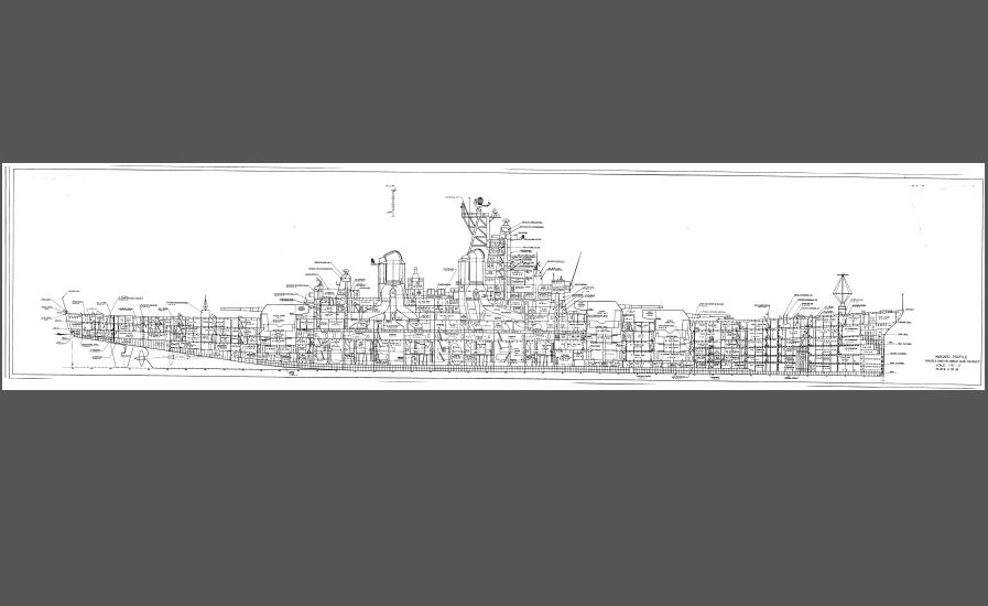

Does the kit match this drawing? I have yet to hear anyone's definite opinion about this drawing:
Assuming the kit matches this drawing, then that is the source of the problem...
One poster in another thread confirmed that his vertical measurements of this drawing, blown up to 1/200, matches very closely the Trumpeteer 1/200 hull...
If that is true, then that, in my opinion, is very, very bad news.

Your depicted drawing is one from the Booklet of General Plans - I've got a .pdf of that series also. I take it you find this drawing inaccurate? On what do you base this inaccuracy (if that's what you're alluding to)?
If the model's measurements match the drawing (or close to it) why would this be a problem?
I've never said that the hull was 100% correct - in fact, I've posted earlier that I thought there was some underside inaccuracy regarding the areas on both sides of the after quarters as they fare down to the keel where the outboard screw shafts are located.
Sorry, but I'm scratching my head at your latest reply. I may have to compare this drawing with similar drawings of the ship drafted in mid-60's (NEW JERSEY) and see if there are any hull differences. Then again, I have to consider whether this is a real problem worth my time & effort.

The drawing fails to depict the curve pitch change in front of turret A. That pretty much elliminates it as any kind of serious modelling reference for outlines...
This is just a GA drawing, and no manufacturer or institution will ever tell you their own GA drawings has anything to do with what the real product actually looks like, and it certainly doesn't in this case.
GA drawings are just that: General Arrangement drawings. They show the disposition and spatial relationship of various general elements. I'll say it again: They have absolutely nothing to do with what the ship actually looks like. This is true of all GA drawings, and this is natural because GA drawings are of little or no use during the fabrication of components (and they are not even used for planning the general layout, unless they have dimensions printed on them: This drawing doesn't). They may be used as maps to find your way around, or for public relations and encyclopedias. That's it. It is not their purpose to replicate the precise outline of the ship. This is true for all hand-drawn GA drawings, no matter what the subject is.
I will add the caveat that this of course applies only to hand-made drawings: Today in the computer age, a direct proportional relationship can exist between the representation of the parts and how they assemble to create the whole, but that obviously doesn't apply to WWII drawings.

Very good assessment of the drawing in question. Perhaps a sheer elevation of the builder's plans compared to the model hull might be a better comparison.
I've found in facilities engineering that the GA drawings are also useless when laying out HVAC, piping, or other parts of buildings relying on actual dimensions for proper placement. GAs tend to be produced early in the project and seldom follow the "as built" conditions of the construction. Could be the case here, as well; I'm not disputing that.
As for the model's hull and it's correctness - well, if I find the time to dig out some further engineering construction drawings of the IOWAs, I may try to determine how near to or far off this hull is to the actual ship.

BB62vet wrote:Very good assessment of the drawing in question. Perhaps a sheer elevation of the builder's plans compared to the model hull might be a better comparison.
Thanks Hank.
Yes, some printed elevation numbers would definitely settle the issue. Hard to argue with a printed number on a plan...
Sadly, the availability of those types of plans seems a bit hit and miss. They probably still exist for most things, even of WWII vintage, but they seem among the harder to dig out from wherever they are... With lines and numbers all over them, they are not attractive for publishing purposes, so they are often buried somewhere...
I've called the Smithsonian's National Air and Space Museum once to get some specific data, and they wanted to charge a lot to produce copies of a whole slew of things I didn't need in one big package... Otherwise they would not do a thing...
It seems incredible to me that kit makers do not start with drawings with actual printed dimensions, before investing a lot of money into moulds... I don't know how hard they look for them, or how hard some are to find... I hope we get the final answer on this, as to me it simply doesn't look right, although it could be fixable.
