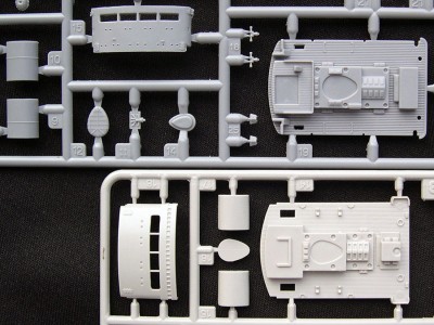

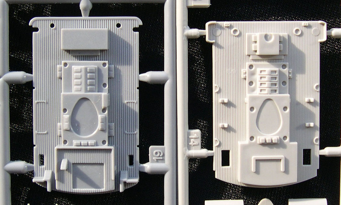

A close up of the main deck. They are very similar in details - Aoshima breaks it into separate sections and molds fewer parts on (like the aft deckhouse). PR has molded on some skylights to a greater degree on the forward hatchs. I'm not sure how accurate the skylight layout actually is. Both have molded on two accessways to the forward hatches. Aoshima's is more correct in shape. Not sure what these were actually used for; could have been airways, protected entrances to an access ladder, or possibly, an outhouse.

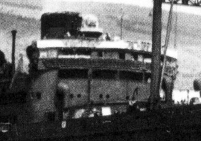

Aoshima's bridge superstructure is properly sized. It's also broken down into more parts, with a bit more detail. The skylights of the top deck are properly done. The bridge face from PR was done as one piece, while Aoshima has chosen to mold it into two levels. The top level, the compass bridge deck, comes with clear plastic windows for the inner portion of the level. The bridge wings were open to either side of the center section, with more glass at the corner edges. This is pretty much true of all Japanese merchants of the time.

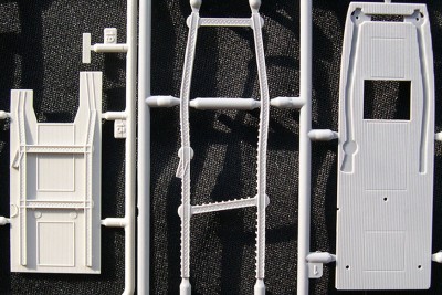

Next up is wood decking over the aft section of the main deck and trolley rail system added to convert the ship into an auxiliary seaplane tender. As nice as the single piece PR version is, it's too short, and has a generic rail layout that may be closer to that of sister ship Kunikawa Maru, though not exact. Aoshima has correctly lengthened the decking, as well as laid out a correct rail pattern for Kimikawa Maru.
A couple of points worth noting:
• The raised surface of the rail trestle was covered with treading, as in the Aoshima version, not drain holes as in the PR version.
• That Aoshima molded the rail system separately, with a deck recess for only the rear of the trolley rail, suggests the possibility that kits for one or more of her sisters in the auxiliary seaplane tender mode might eventually be released.
• If that proves to be true, note that the trolley rail layout differed for each of the four ships so converted.
• Further, only Kimikawa and Kunikawa Maru had their catapults mounted on a sponson attached to the starboard side of the ship. Kamikawa and Kiyokawa Maru had their catapults mounted slightly inboard, atop the wood decking.

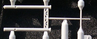

Kingpost masts. Those from both kits are nice. Aoshima has molded on access ladder rungs, which look pretty good. Also, the top of the kingposts look a bit more correct in the Aoshima version.
The crossbracing is little clunky in both versions; maybe the PR version is a tad cleaner. In the real ships, the crossbrace trusses were much finer, and separated to either side of the kingpost. The top was solid, so it could be used as an access walk. PR did make a PE set that provided for separate bracing. I'm not sure if its still available.
