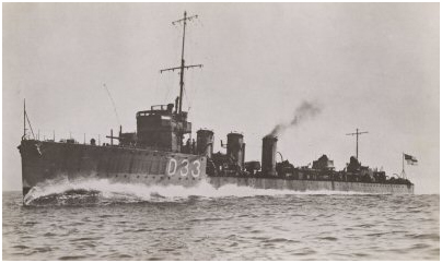

HMS Murray
There is good information available on the Miranda and Moon or M-Class destroyers of which HMS Mary Rose and HMS Murray are members. These were the standard British destroyers of WW1 most being built to a Standard Admiralty design with specials from Hawthorne, Thornycroft and Yarrow.

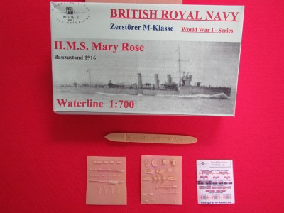

The model comes boxed with bubble wrap around each plastic bag. The hull is in one and a second bag contains all of the parts. There is a paper sheet of flags and a 3 page set of instruction drawings.

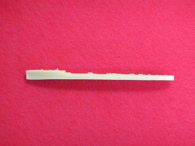

When comparing to AD Bakers� HMS Matchless drawing the hull shape is correct. There are too many port holes aft, they should only extend forward to the aft set of torpedo tubes. The anchor chain detail is also not correct.

Kit Contents

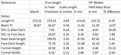

The Measurements
These are taken from the kit and from the drawing using a 0.150 mm Digital Caliper.
So from the references and the drawing of HMS Matchless the hull is .6% long and the beam is 1% narrow, not bad at all for a long available 1/700 kit. The W/L to deck measurements indicate the hull is too thick but placing in �water� will correct this. The funnel height should also be reduced, the profile drawing provided will allow for this.

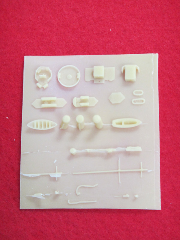

The parts come on two wafers and it should be straight forward to clean them up. There are extra parts, there is an instruction drawing that shows how many you will need of each part type.

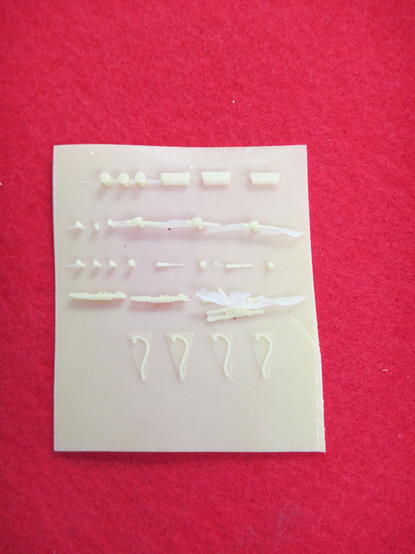

The first wafer has search light towers, 4� gun shields, cowl vents, 4� guns, 2 lb guns, torpedo tubes, search lights and Davits. It may be easier to replace the davits with wire PE. The WEM V&W Class Destroyers has quite a bit that can be used.

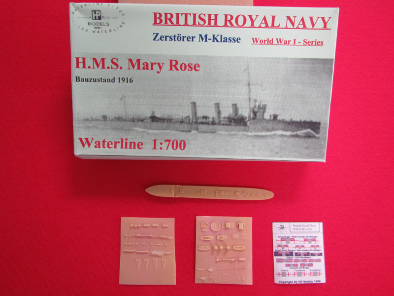

The second wafer has deck houses, platforms, life rafts, life boats, funnels, masts and small parts. There are instructions on the diameters and lengths required to replace the resin masts with brass wire (not provided).
The instructions are very basic drawings, one of the parts and one for positioning. There is a drawing with plan and profile views although it is simple and correct. AD Bakers� drawing is the one you want and should be easy to get. March has excellent drawings but the book is hard to come by.

Do you mean making a plastacine mold? The parts look fairly crisp, but there appears to be a bit of bowing of the hull. :wave_1:

Thanks for the clarification. Yes, use PE to make an impression in smoothed plastacine about twice the thickness of the PE. Fill the impression with white glue and allow to dry. Carefully remove the white glue from the mold and trim. Paint the dried white glue on all surfaces sealing it so that it will remain stable with changes in humidity. Otherwise it can curl a bit.
The hulls vary, some have a slight warp, as in this case, but there is sufficient spring that I did not feel the hot water treatment was required. My thoughts are simply to attach the hull to the base.
