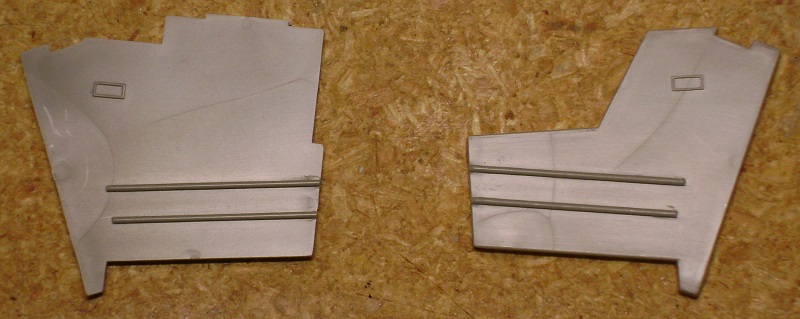

It is obvious from the kit that Revell has a 'late' LSM in the wings. The instructions are very clear about which components to use and where, including where to drill out holes and where not to. The sprues also contain components that won't get used on an early LSM, but can only be used on a later version. Here's an example:
File comment: These are two types of inner bulkheads provided for the tank well below the focsle. On the right, is the type of bulkhead used for the 'early' LSM. On the left, is the inner bulkhead for the later LSMs, which had a much taller focsle, and doesn't get used in this kit.
