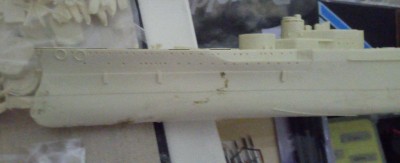

Thanks a lot !!!! great review :thumbs_up_1:
But IMHO just missed something.
The hull is fantastic as You said ,but seems to have a little issue which is very easy to correct (corrected mine)
The bow is slightly downwards ,all the Gin's hulls I've seen included mine has this problem,maybe 1 mm downwards on the bow
