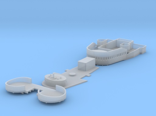

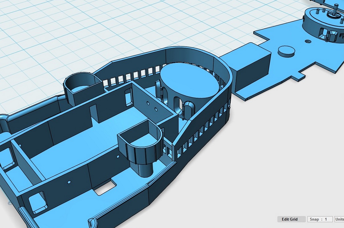

Martin pointed out to me that a better bridge could be designed with open windows and a detailed armored conning tower with open armored doors and door hinges, detailed like this round bridge design for New Jersey:
I'll have that ready shortly, precisely scaled to 1/350. It can be used for 1/350 Tamiya, Revell, etc.
