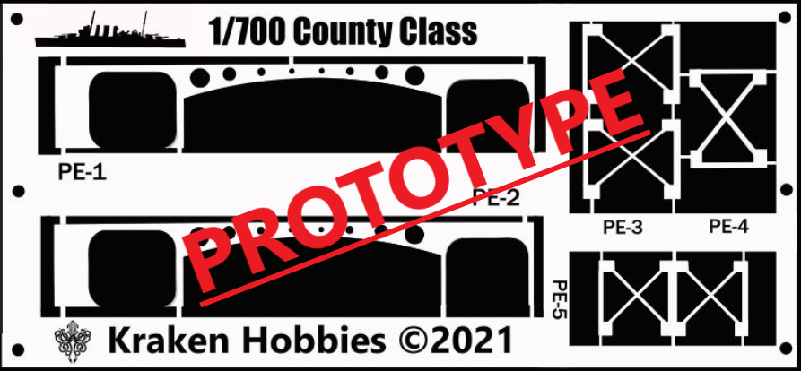

Me!! Pick Me!!! Oh please Pick Me!! I am calling out to you with my mind!!!
I know it's about a year overdue, but they say good things come to those who wait right? And maybe waiting to use the Trumpeter kit as a base will be better for most modelers. The initial set will be for Canberra 42 with plans to do a late 30's Australia not soon after. If someone has any nice references for the Australia after her refit and how she appeared in 1942 or 1944, I would be happy to talk some terms.
