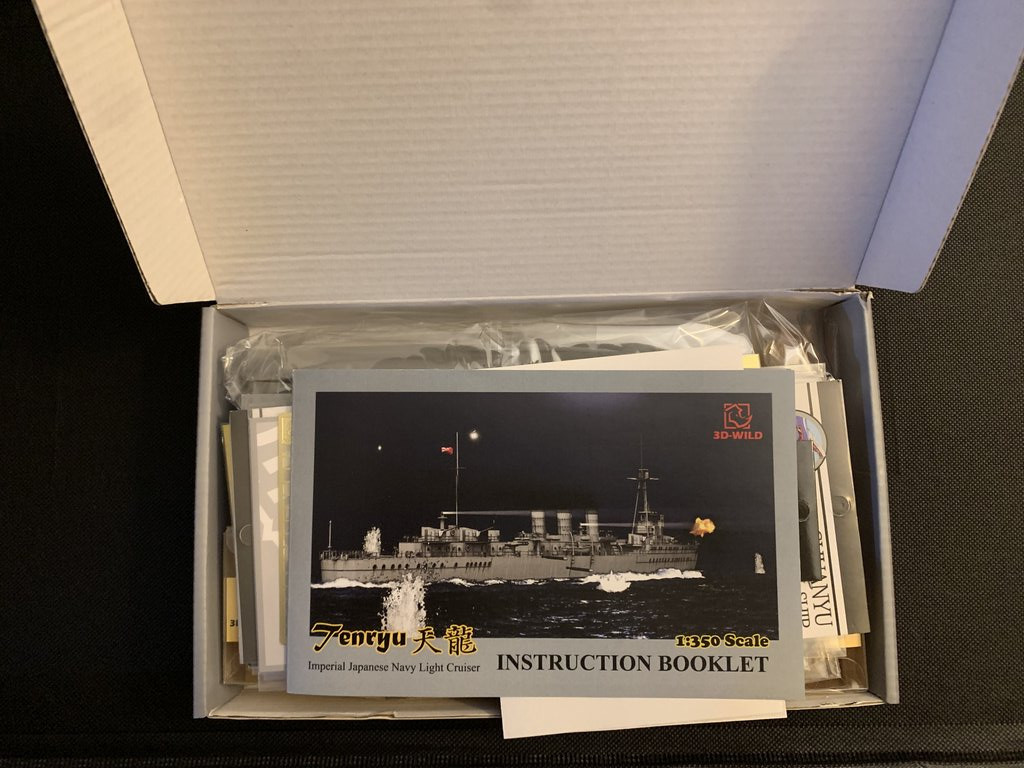

A very nice and sturdy box with an image of Tenryu engaging in action around Savo Island
Upon opening, one is greeted with quite a bit from 3D printed resin to etched brass and color instructions

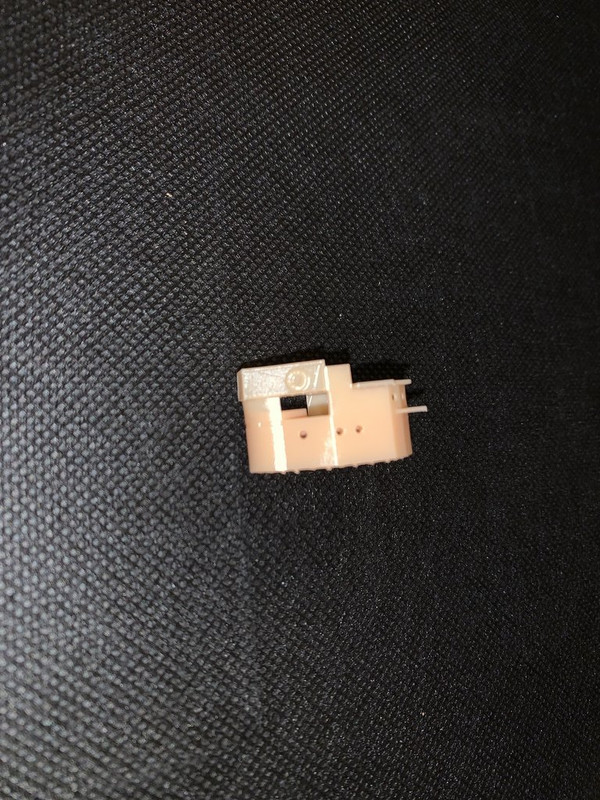

The bulk of the superstructure is printed in three parts. The base of the bridge and conning tower are printed as one piece. IMHO this should have been broken up more, there is an open deck behind the CT and it will be difficult to paint with it as one part. This was a big concern of mine on the Soryu as well. I would rather assemble an few extra parts to aid in overall assemble than have such are large part. Not impossible to overcome, just a personal opinion. I also feel the CT view ports are printed too soft and should have passed through or been done deeper. There is a life preserver printed onto the side of the splinter shields, again could have been done separate to make it sharper and aid in painting.

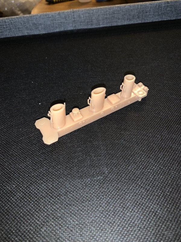

The midship superstructure along with the three funnels printed as one piece. This part is very nice and has some nicely printed detail. Even though the main support raft was removed, there are still some supports that will need to be removed on details.

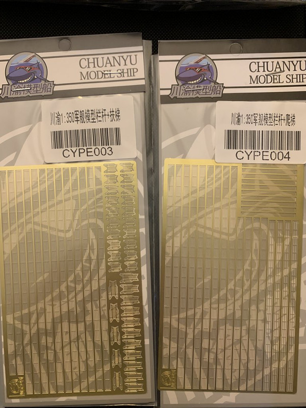

You get a couple of generic rails and ladders

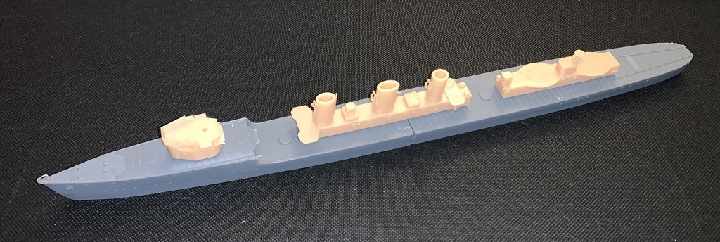

Obligatory dry fits :big_grin:
At 468' 10" they scale out to just over 16" in length which by rough measurements, the hull was right on.
