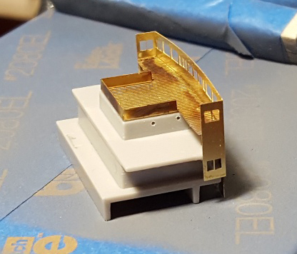

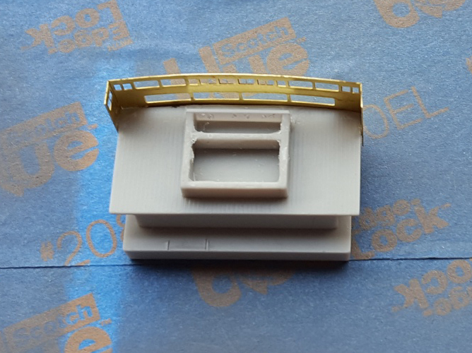

At this point, the PE bridge face can be glued to the kit parts. Here, I‘ve used a face with a full width compass bridge deck with openings at the bottom, good for Toei or Toho Maru. (Since I had only one set of kit spare bridge parts, I had to re-purpose the original PE example by removing and damaging that facing to get at the plastic parts.) You can see how the recessed compartment compares with an example of the real thing, Nippon Maru.

The compass bridge deck and compartment are relatively straight forward to glue in place.

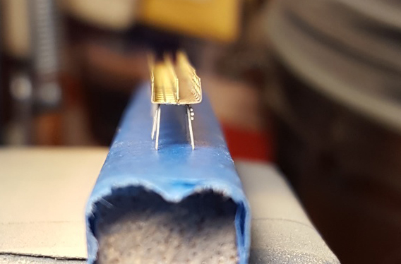

One last bridge point. All the tankers carried the IJN style signaling arrays, one on each bridge wing. Tom’s are relief etched on the back, which makes for a nice detail. Nice to have these.
