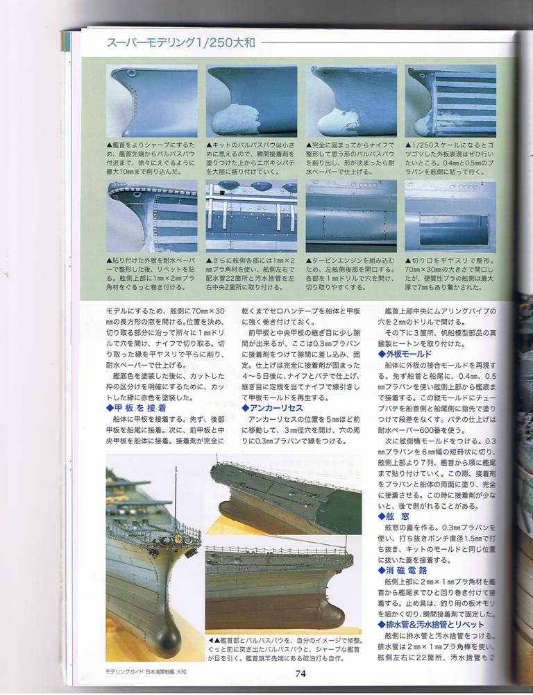

I'm sorry i couldn't upload these last time Ryan i got real busy with some homeworks
these shots come from the Yamato "Modeling Guide" magazine and the model on the pics is not Nichimo's but the 1/250 scale from Doyusha. the model is inaccurate as it is i still got to give it to the modeler because this Doyusha kits required a great deal of enhancement and i mean it to me the plain kit is just another bathtub toy. i know the riveting task is tedious ryan you'd require alot patience on this one perhaps more than adding the wood deck. the white glue technique could be tricky and alot messier than any other if i had to choose i'd go for styrene rods or check this other build up from another fellow modeler over at modeshipwrights site, i've been following Dade's Yamato for quite sometime now and amazingly enough he is adding rivets to the hull .. http://www.modelshipwrights.com/modules ... 748&page=2 with rivets or no rivets she still look a winner, keep up the good work!! :thumbs_up_1: :thumbs_up_1:

Jose,
Thanks for those, all I can say is WOW! That other build on modelshipwrights was added right to my favorites list for references for this build.
I am not a big fan of the "clamps" he is using for the degaussing cable though, look too bulky for me.
Though thanks to your pics and link, now I am sitting here pondering the railroad rivets, and debating about putting them on mine and then repainting her. So if I end up doing that, I blame you for all the added work and time I will have to put in on this! :heh:
I do like the way he described his, as going more for "presence" than total accuracy. I want it to be accurate to a point where it is obviously the Yamato, but want it to be more of a representation of my skills as a modeler, and something I will enjoy looking at for years to come.

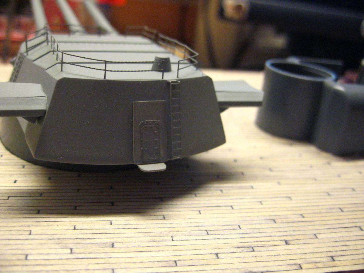

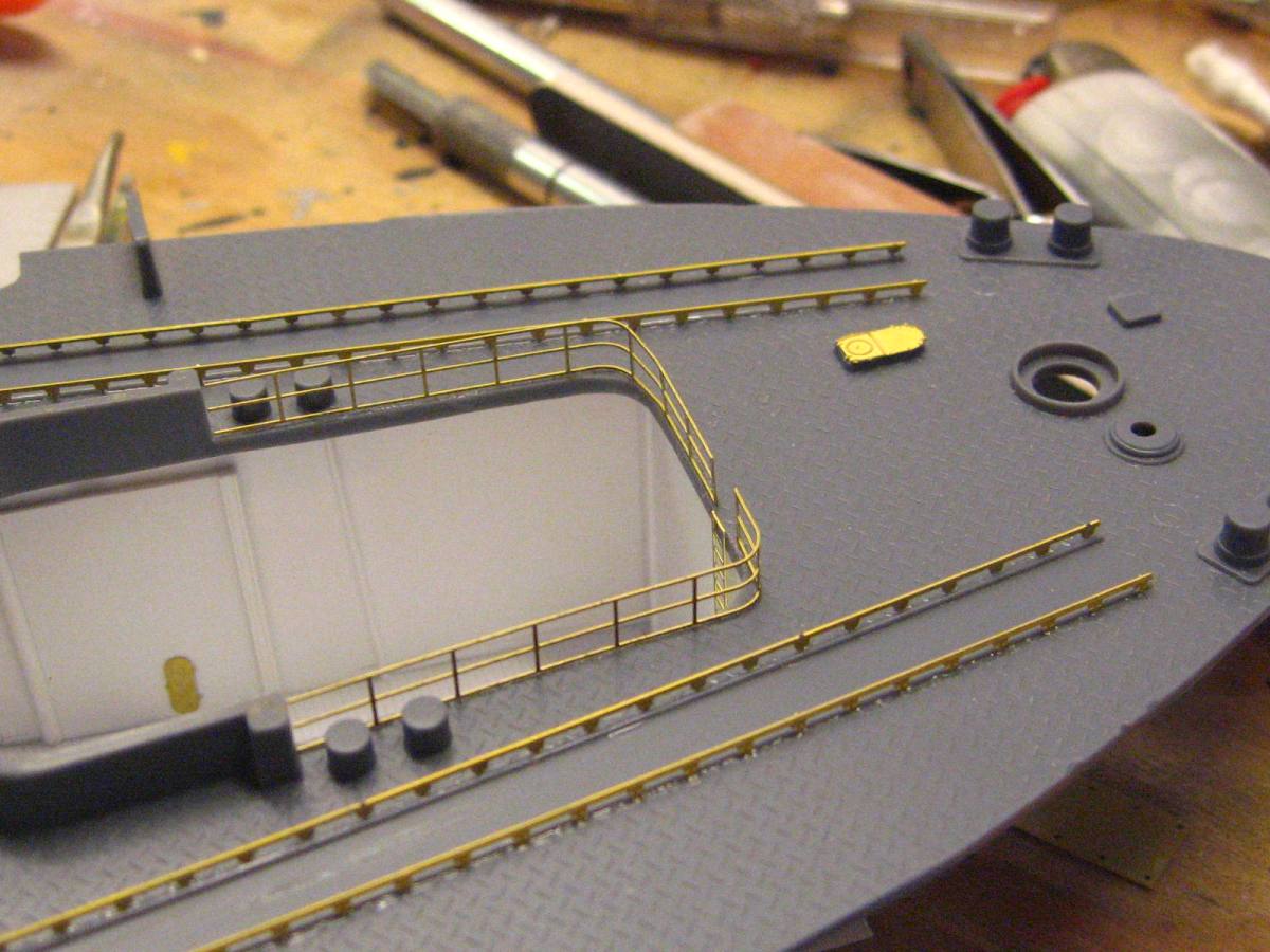

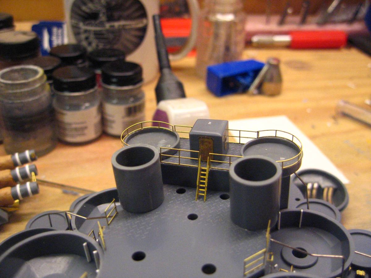

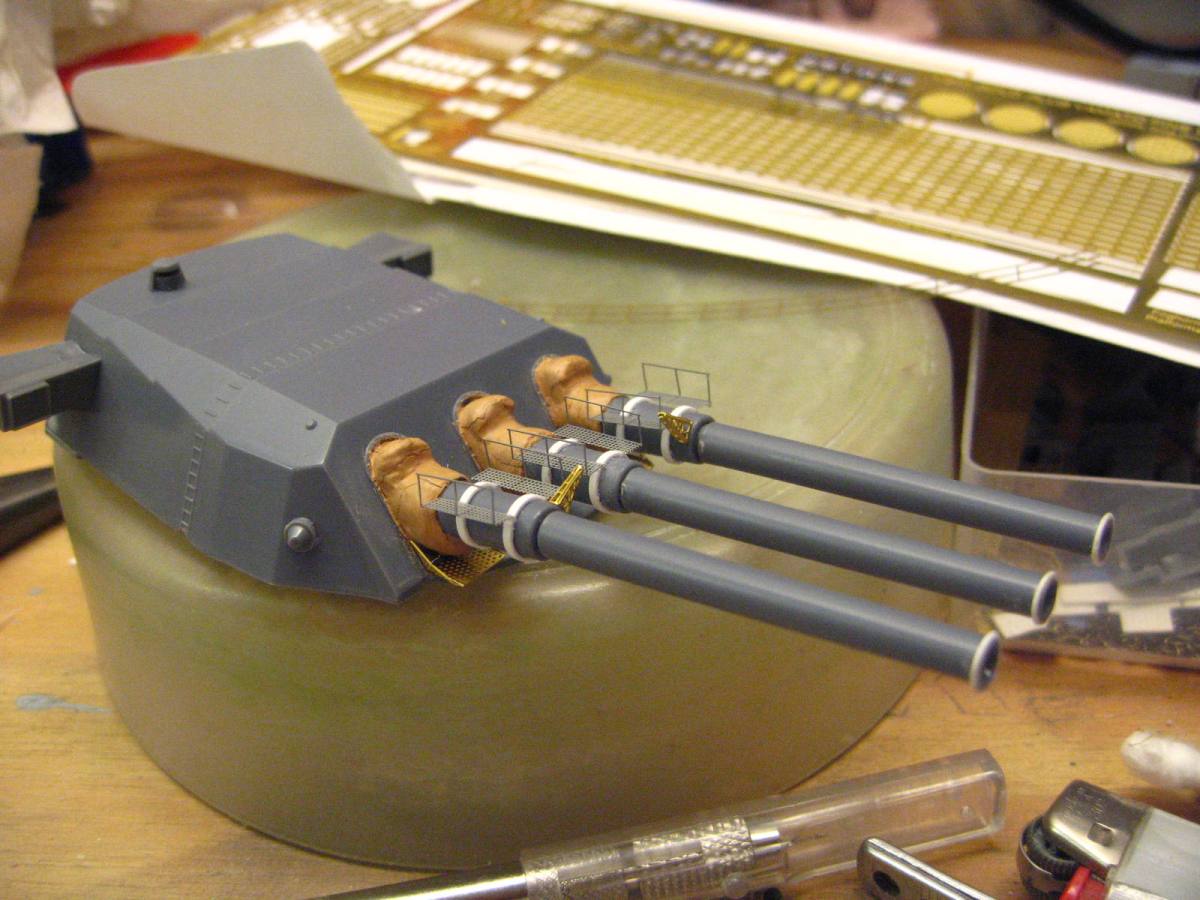

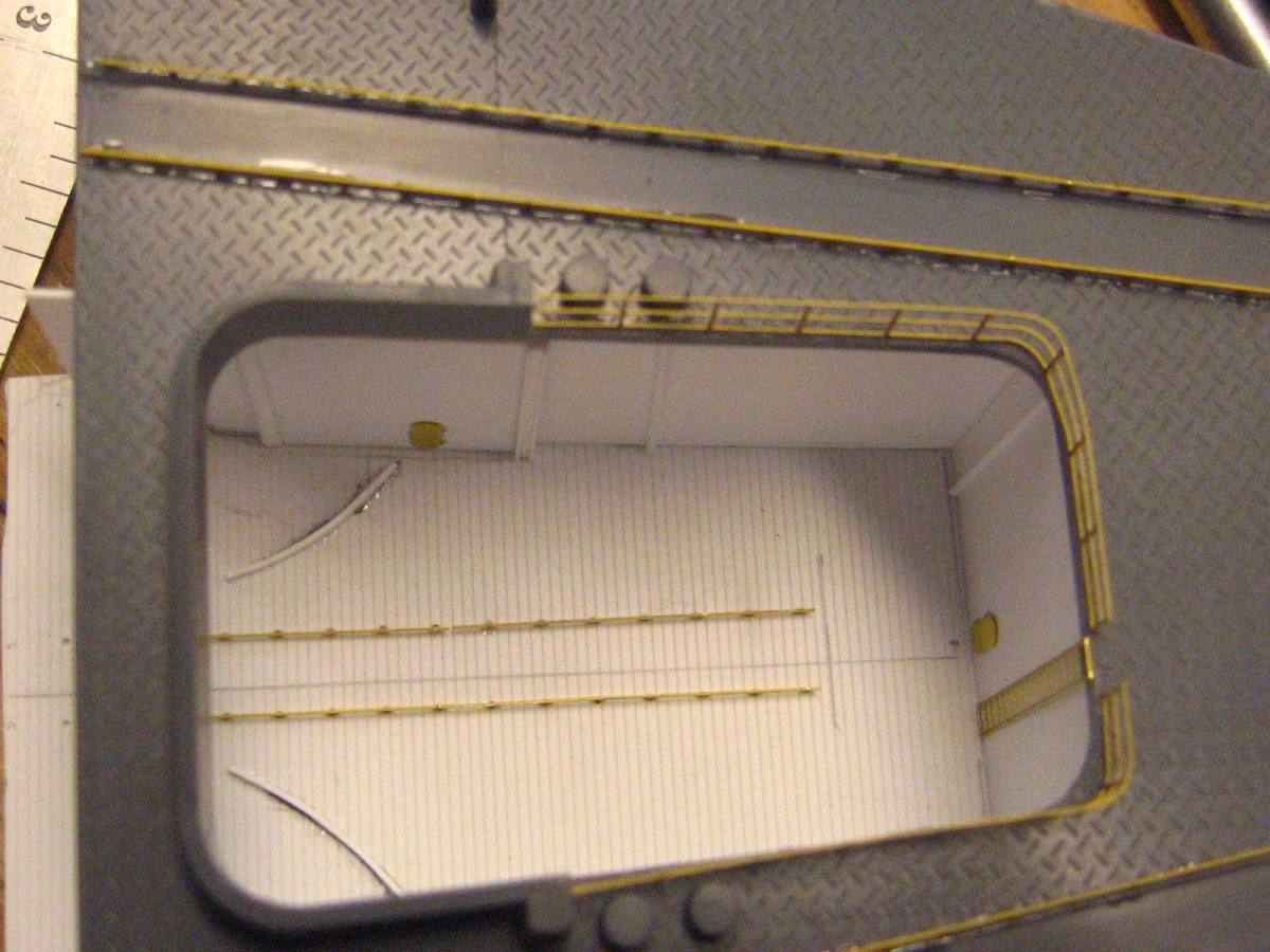

A few updates on the Yamato:
I have not gotten a ton of work done on her lately now that the nice weather has arrived, my motorcycle keeps screaming for me to hit the open road rather than sit at my workbench. The bike coupled with a beautiful young brunette who is a recent addition and likes going on rides down tho the beach has taken a bit out of my modeling time!

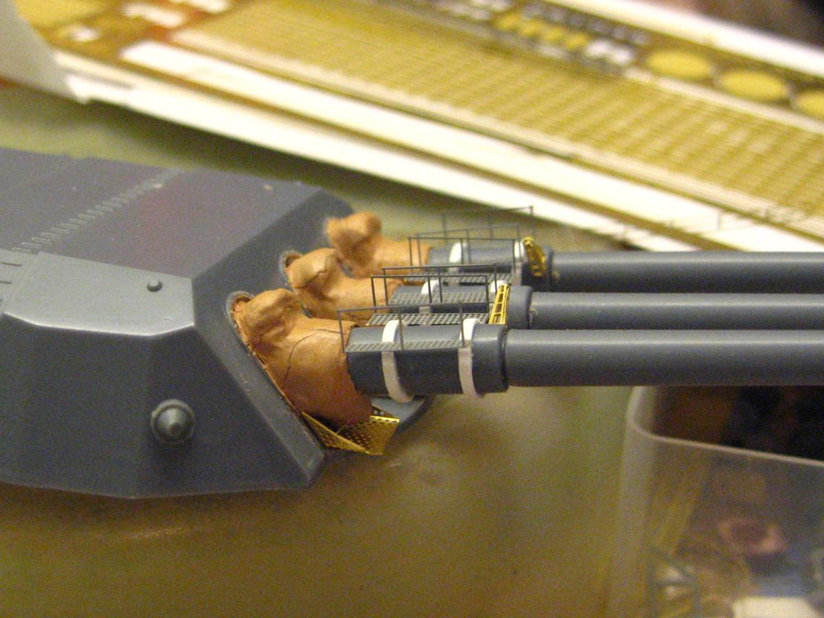

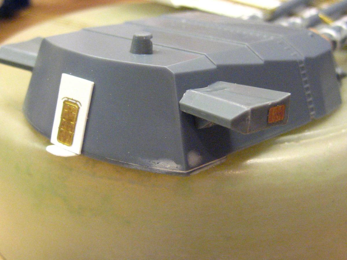

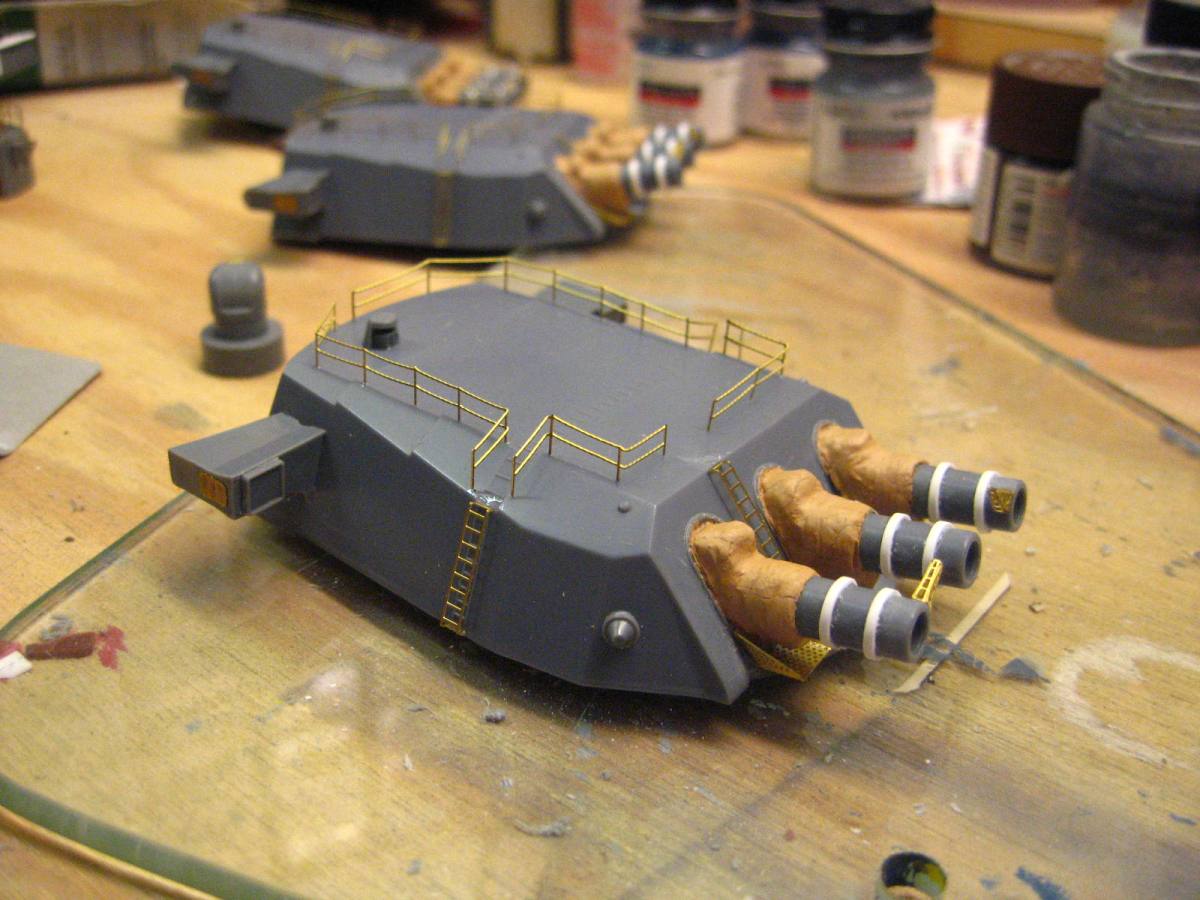

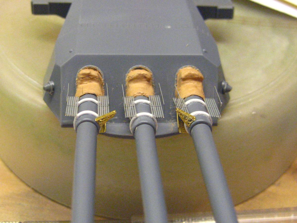

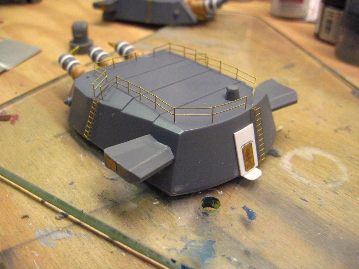

The main turrets are nearly complete, I added the work platforms to one of them from leftover 1/350 carrier safety nets, but I am looking for some opinions as to how they look. To me there is something "off" and I am considering getting rid of them. Any comments or suggestions as to these platforms on the barrels??? :thinking: :huh:

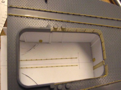

I also added more details to the well bay, I used the v groove styrene sheet for the floor just cause I like how it looks, I think I am going to paint the floor of the well deck witht the IJN linoleum brown color just to add some visual difference in the well deck.
how do you think the work platforms look???

I saw something like this somewhere and like the look so I went with it.

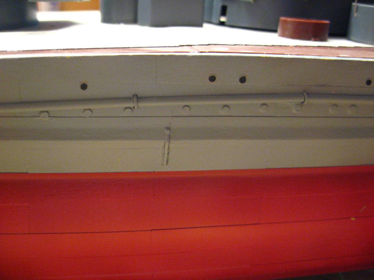

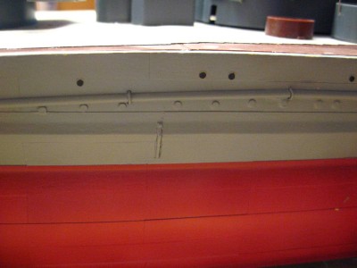

Three minor quibbles, hopefully not too late to correct:
1. The degauss cable that runs around the ship is rectangular in cross section, not half-round.
2. The hull plating bands should not be present on the outside of heavy side armor belt. The heavy armor belt sits on top of the riveted hull sides. The belt plates themselves fit together flush using edge to edge dovetail joints without visible raised rivets. In any case, the joints in the heavy belt armor runs up and down only. Each plate extends the entire height of the main armor belt from the top edge to well below the point where the belt is covered by the top edge of the torpedo blister. There are no side to side joints.
3. There should be 5 horizontal bands of plating on the torpedo blister.
sgtryan13
Posts: 2650
Location: Connecticut, USA
Re: 1/200 Yamato
Post by sgtryan13 »
Chuck,
You have certainly given me some food for thought...
As for the cable, i had seen some pics where it was rectangular, I figured that was a mistake because it honestly looked a little goofy to me.
For the midships armor plating, that is a detail I am ashamed that I overlooked, not really sure how I nissed it, I think I must have just gotten carried away with the tape and never realized it.
I knew the number of rows for the plating was not correct, I just went with something that gave the overall appearance for the plating effect I was going for.
With the amount of details I have since added to the hull (not posted pics yet) unfortunately I don't think any of these errors will be able to be correted at this point :censored_2:

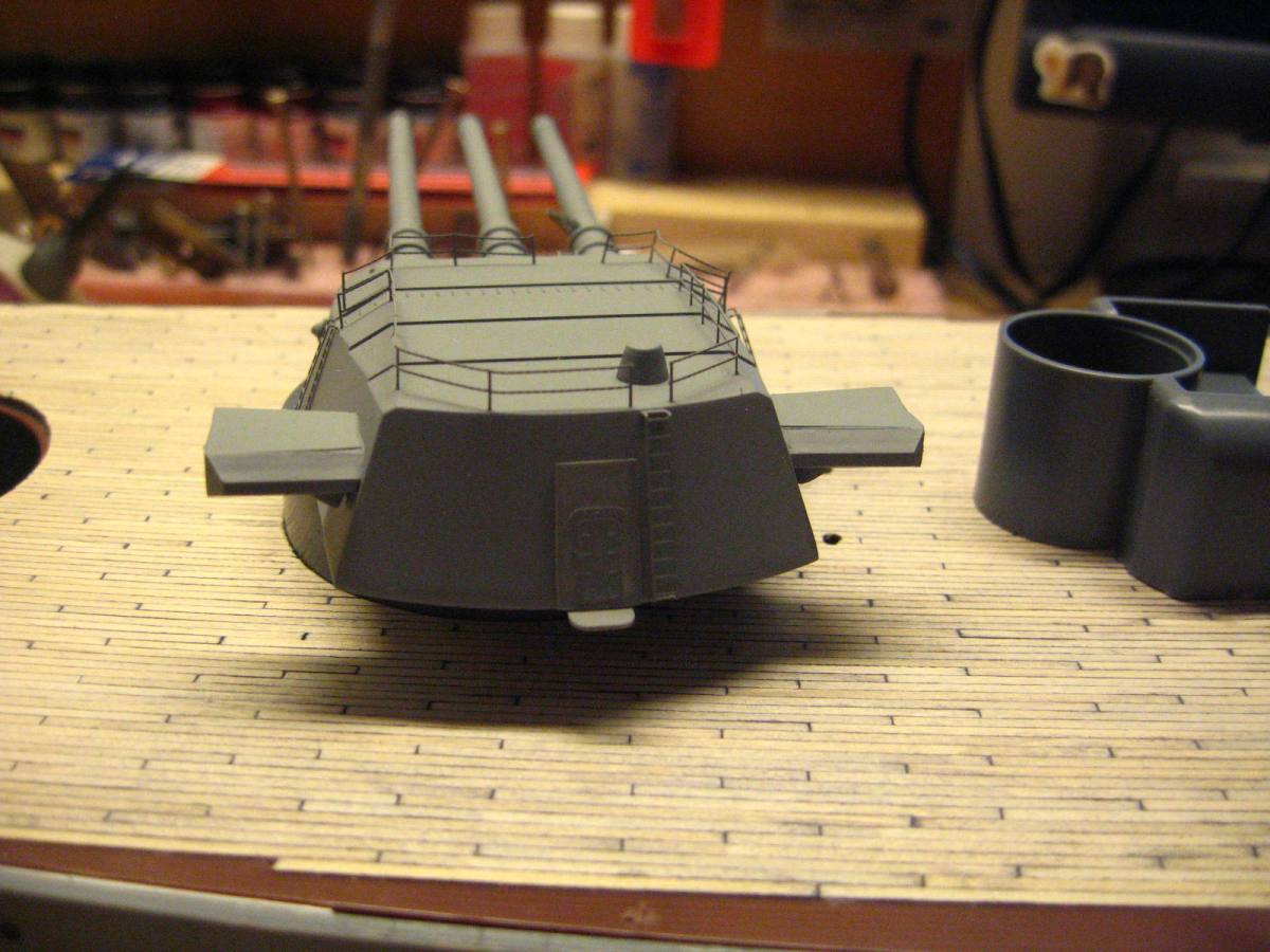

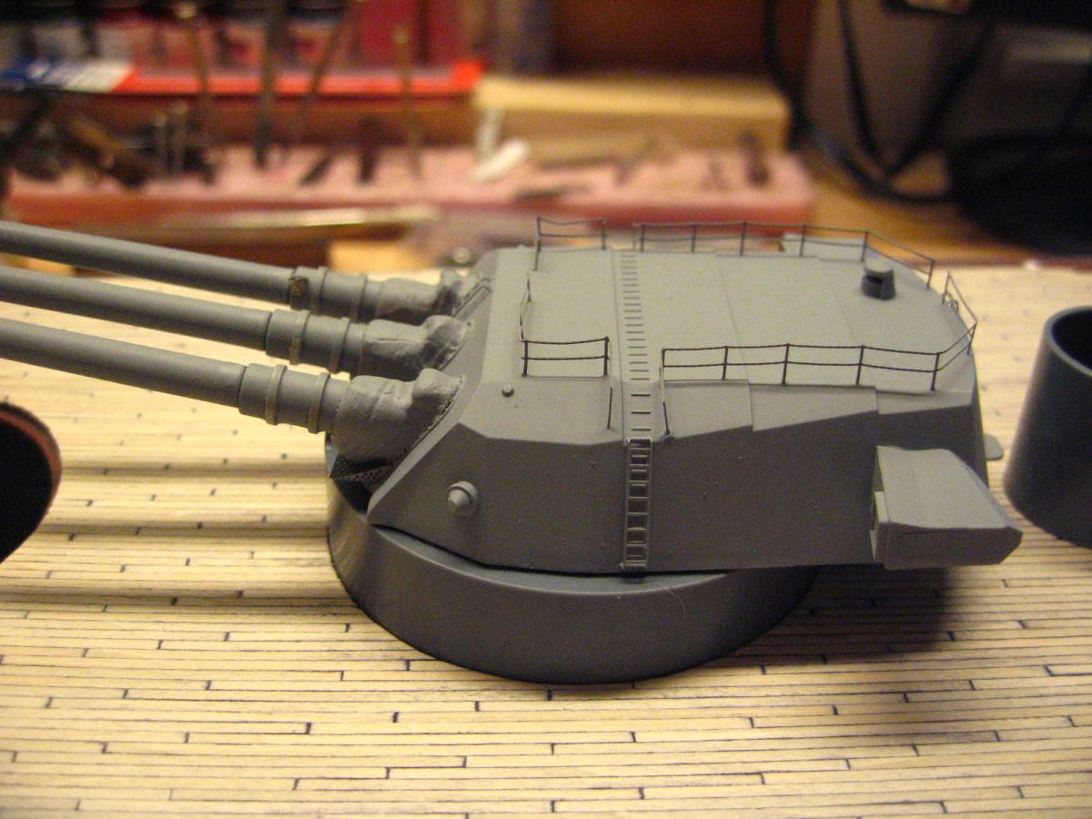

Any opinions on the work platforms on the main gun barrels? I have moved on to a different area of the build while I try to figure weather to leave them, improve them, or toss them in the trash.
Thanks for the input, I may be coming to you with some questions soon about other areas that are not beyond the point where they can be altered yet. :wave_1:

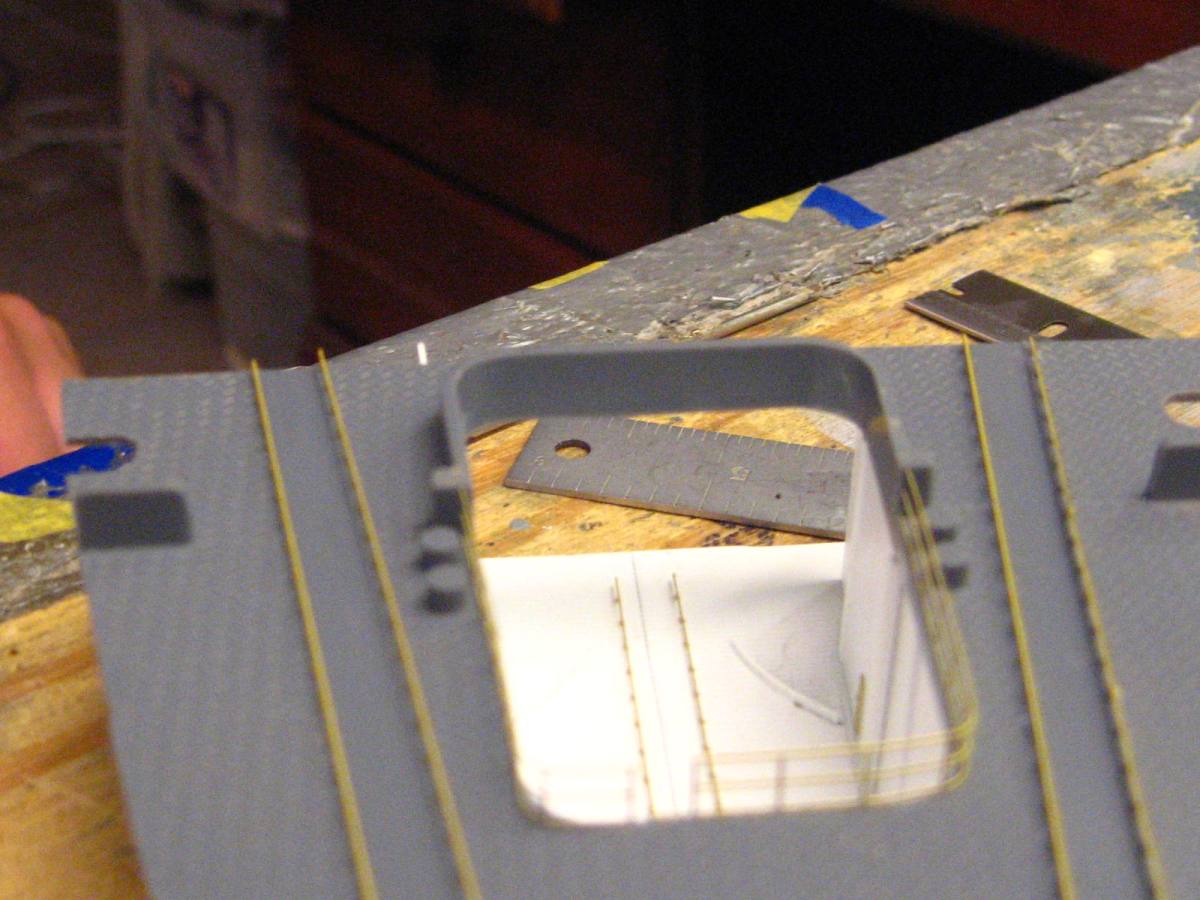

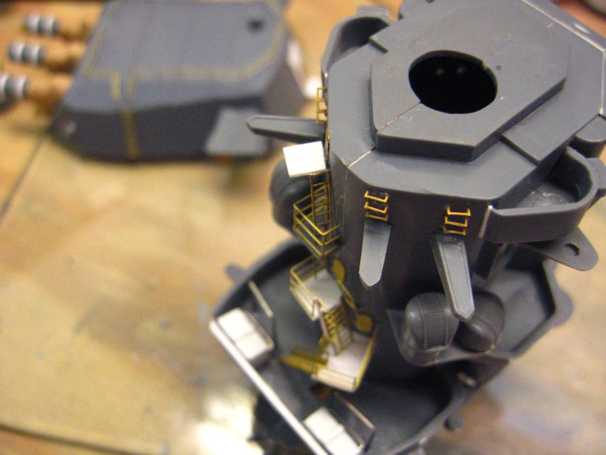

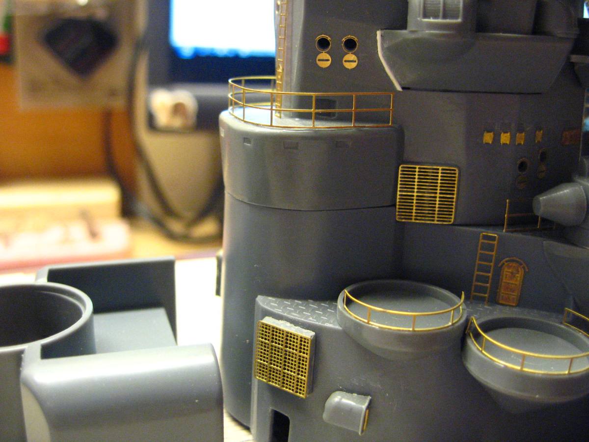

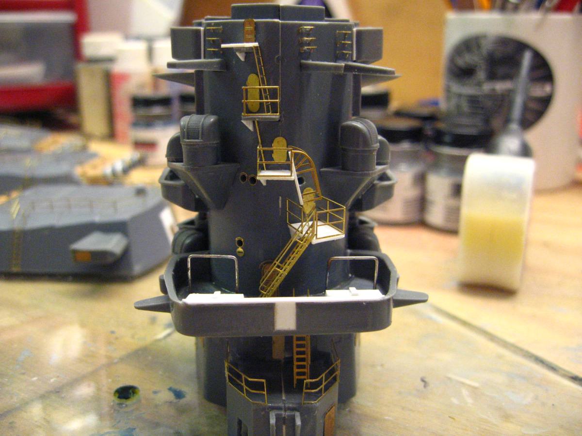

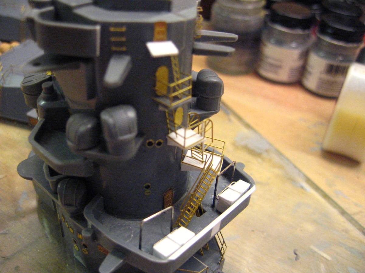

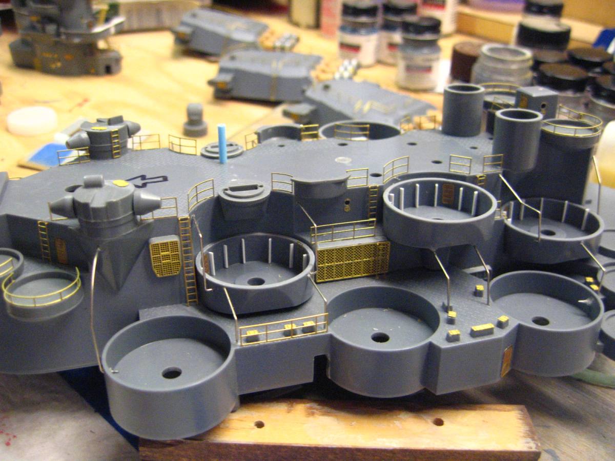

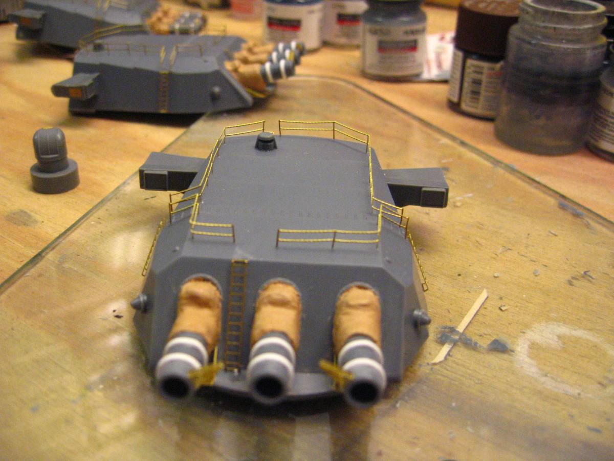

Here are a few more shots of the progress, almost ready for some primer and paint.
The rails for the turrest require some finesse and creative fitting. I think GMM did the rails to match the AOTS book dimensions of the turret, not the Nichimo kit.
These shots also show how the turrets look without the work platforms, I am still hoping for some input on these.

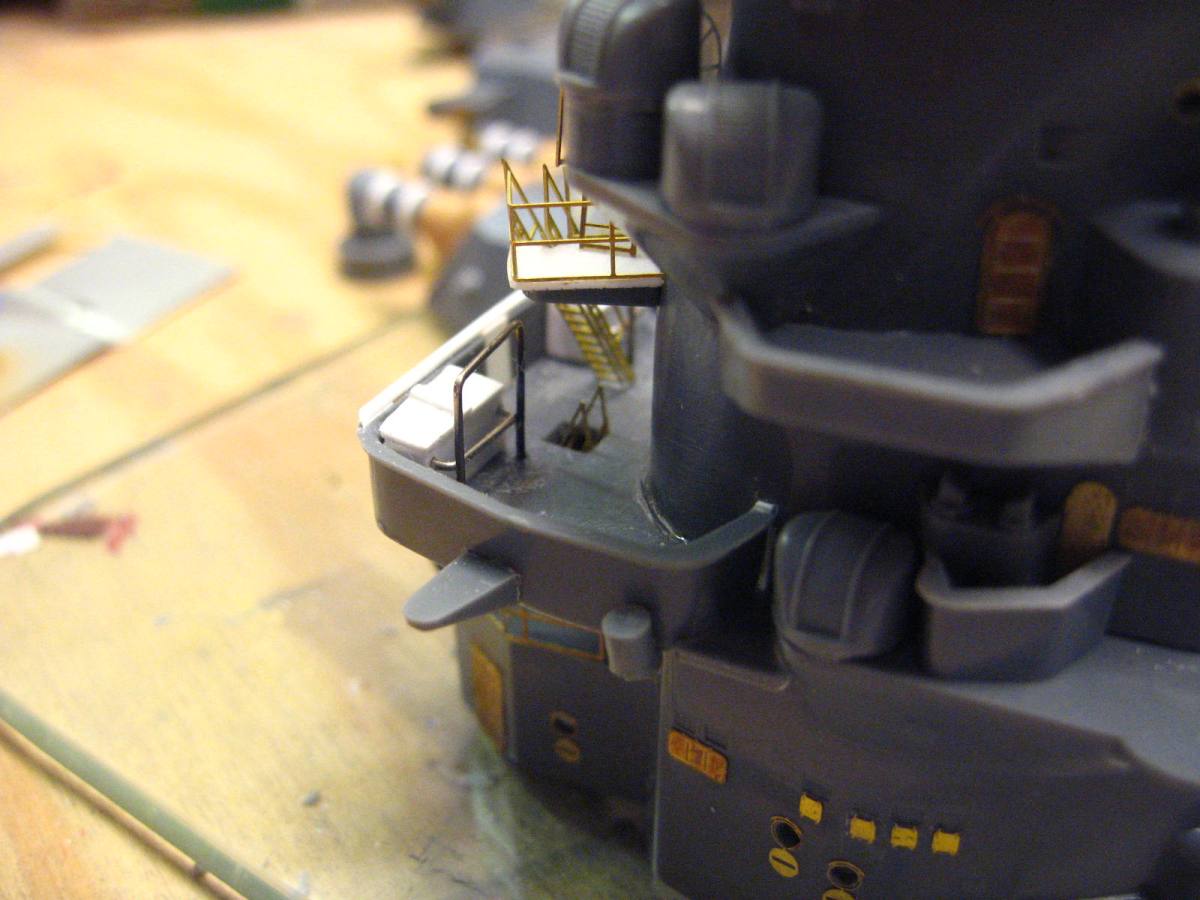

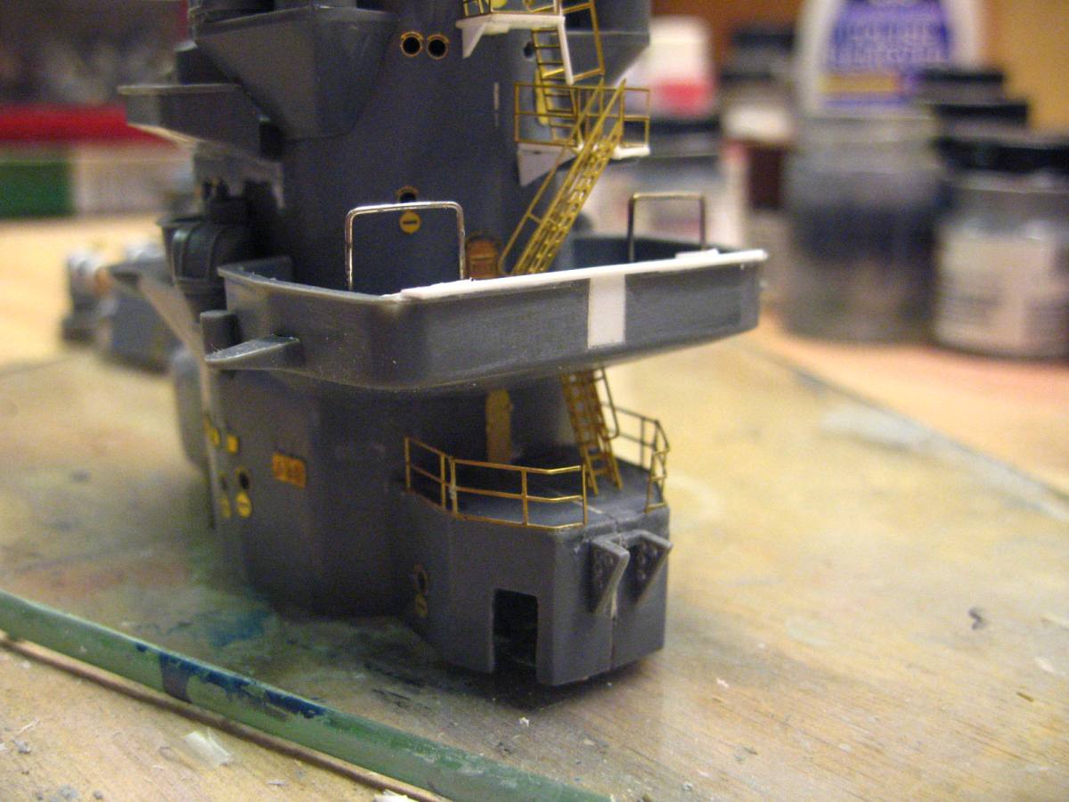

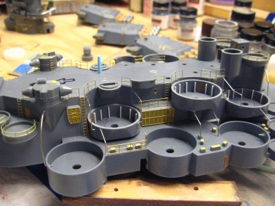

The superstructure is almost done getting the photo etch treatment, lots and lots of brass and styrene have been put in place, and a little more still to come.
I tried to get some good closeups of the aft section of the main bridge area, this was the spot that was hardest for me to find good pictures of how others have arranged this area.

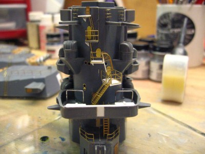

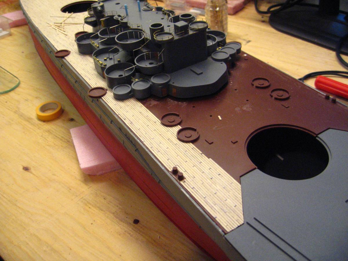

It has been slow going so I have not bothered with any pictures in a while, the majority of my time has been spent still planking the deck, which is now well over 1/2 done, probably 2/3 done at this point.
I think the superstructure has recieved just about all the details it's gonna get, so will be ready for paint this week i hope.

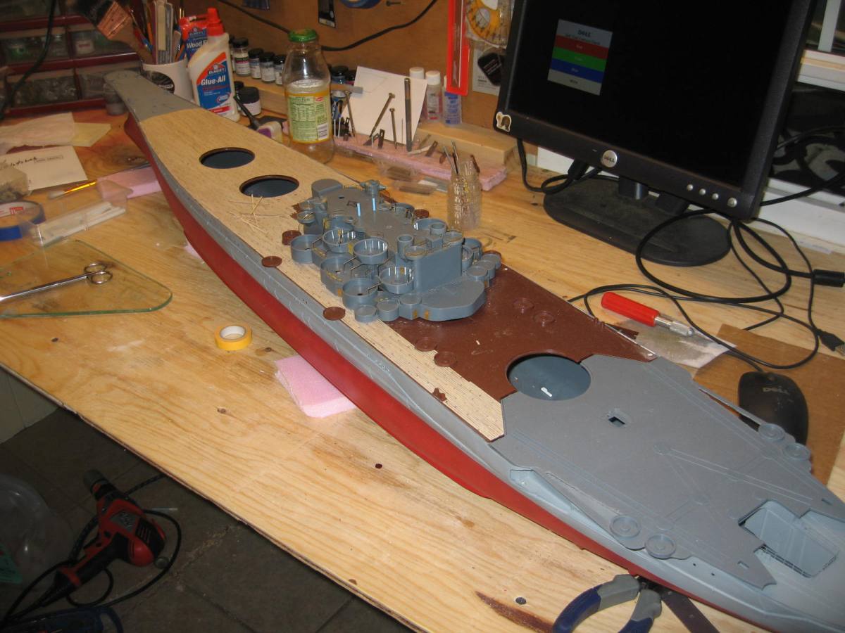

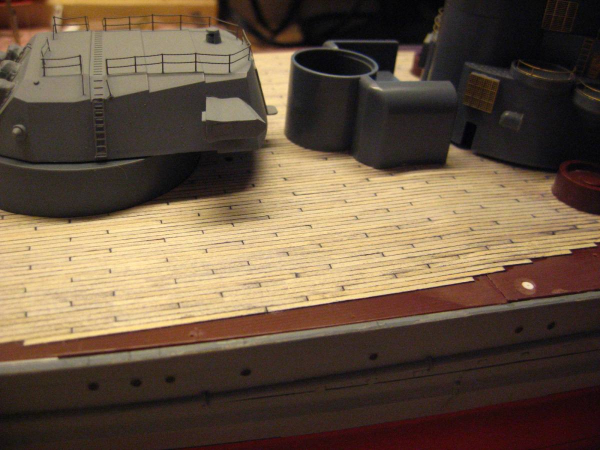

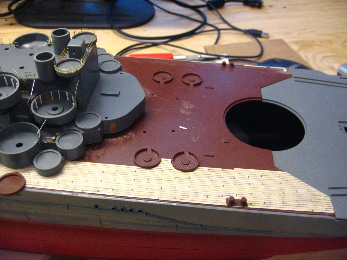

Man this deck planking is so monotinous! I throw a movie in my computer and get to planking, and by the time a 2 hour movie is over, I have planked about 6 square inches of deck. I can not wait till the planking is done, sometimes I go to work on her and end up sitting at my bench just staring at her for half an hour trying to see the light at the end of the tunnel on this project!
I do still really love the look of the planking, I really can't imagine how she would look without it.

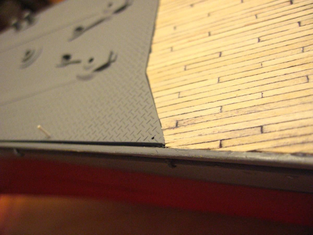

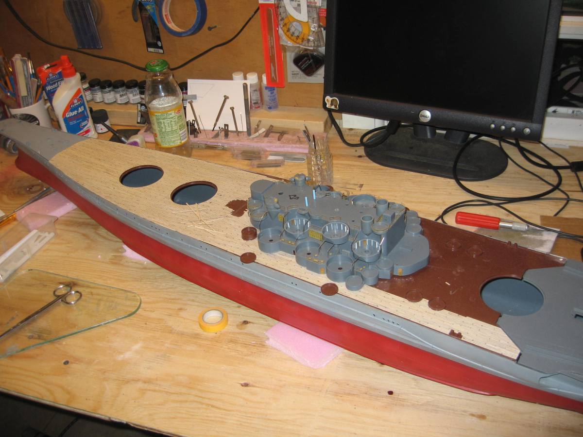

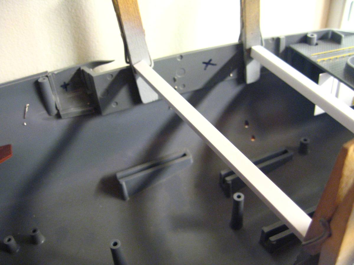

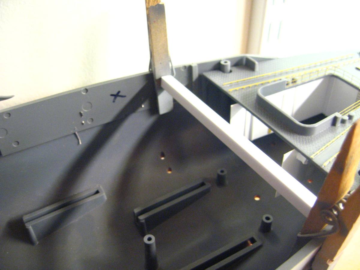

Also here are some pics of how I solved the fit and warping issues at the stern to get the hull side pieces to stay put. Crude but effective!
the clothes pins outside and styrene wedged inside kept the needed pressure pulling one piece in closer and pushing the other out.
You really can't tell, but these are the Tom's portholes, and the tiny eyebrows are above each porthole.  hopefully weathering will bring these out more.
Nasty gap left on the bow I am not looking foreward to filling!
I think I am going to add a strip of styrene to the seam here instead of trying to fill and sand it since all the PE is already installed.  Thoughts???
