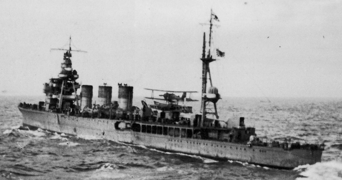

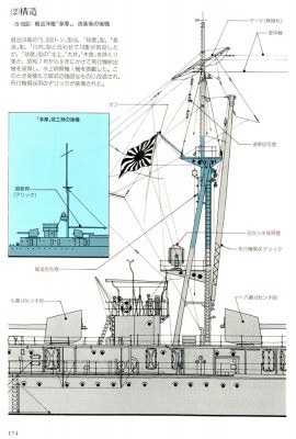

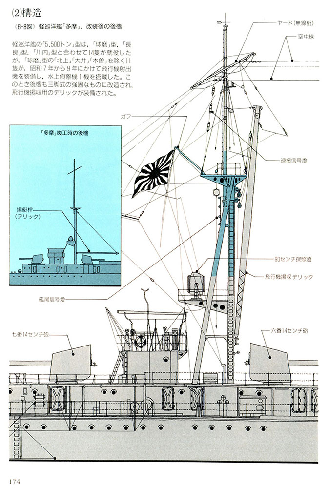

Well, at sea, the usual practice was to fly the Japanese naval ensign from the jackstaff off the mainmast and the admiral's flag also off the mainmast, just further up at the top. I don't know the exact size of the admiral's flag relative to the Japanese flag.
A good example below is that of Abukuma, flagship of Rear Admiral Sentaro Omori and DesRon 1 enroute to Pearl Harbor.
I've included an illustration of Tama's mainmast for some details that will be similar to the Group 2 Nagaras.
What makes your question a little more interesting is that you are depicting Nagara assuming the mantle of Vice Admiral Nagumo after he abandons Akagi. What I don't know is if DesRon 10 commander Rear Admiral Susumu Kimura's flag (he will still be aboard) will be taken down, or flown from another location at a lower level. I'm not sure of the protocol. Photo of Nagumo's flag aboard Akagi also below.

Thanks for that info Dan. What would you with you best educated guess? Likewise how big would you make the flags?
Gabriel
- Posts: 9082
Re: IJN Nagara
I really don't know how the protocol would work. Might be too confusing to have two flags, though I suppose one under the other might work.
Sadly, I don't know about sizing, either. Flags were all different sizes, though an admiral's flag and the national ensign look similar in size in some photos. FWIW.

I was looking at the picture of the Abukuma and noticed she does not have a jack staff on the fantail. The Nagara kit does. Now I am wondering if I should remove it and the one on the bow.
But given the information Dan and Matthew have provided I will likely do something like the flag for Kimura and putting up Nagumo's. I likewise think it is not likely that they would fly both flags. But in the off chance they would have Nagumo's would be on top so it in the process of being raised does not mean the second would not be raised after. A little misdirection never hurt.
Hey look I am becoming a politician or David Copperfield.

Regarding jackstaffs, both forward and aft: at sea, they could, and usually would, be lowered to the deck.

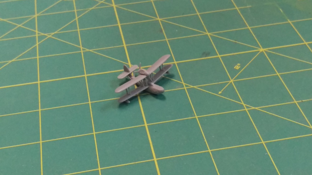

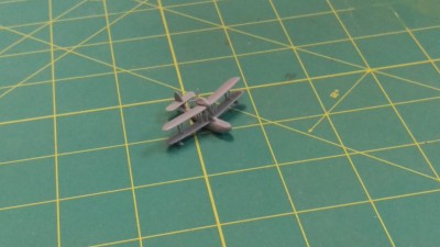

148 hours
It does not look like much but this was two hours worth of work. The vast majority of it was getting the struts to agree with me. I would not say this was over engineered and had too many excessive parts but it was still sitting on a part count of 20.
It will be painted black and have the decals done with maybe a few minor tweeks after that for effect.
While doing the research on this plane briefly, I found out a few interesting things about the Aichi E11A1 (Laura). There were only 17 made. Most of the time we had no idea where any of them were. It was confirmed that Nagara had one at Midway. They were designed as a night scout and spotting plane to assist ships in night attacks.
Anyway, painting will be done soon. Then I will start working on the remaining boats and finish the water next. I decided not to wait on Flyhawk as I am so close to the end of this build and just want to finish.

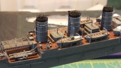

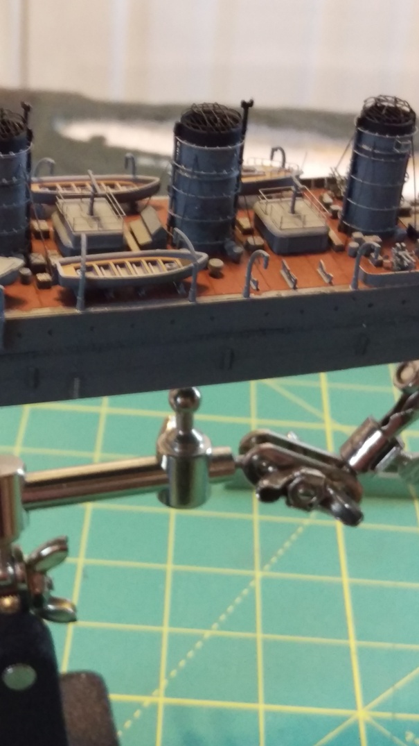

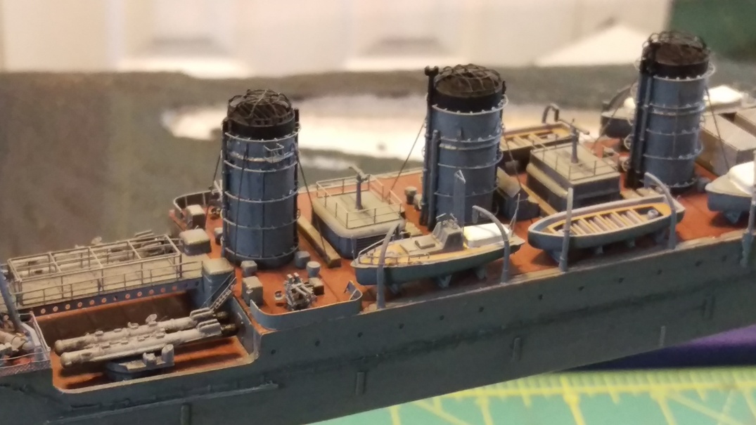

151 hours
Finished the port side 8 meter launch as well as the boat stands and the davits on the starboard side. I am going to be doing the boat that will be in the water shortly, painting the E11A1, putting the flags on and finishing the water in the next couple of days. Then it is railings, figures and rigging.
Gabriel
