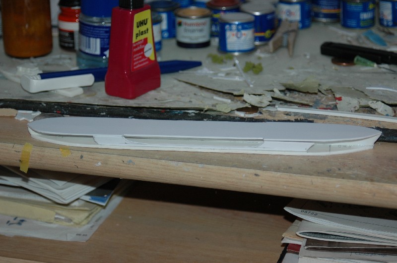

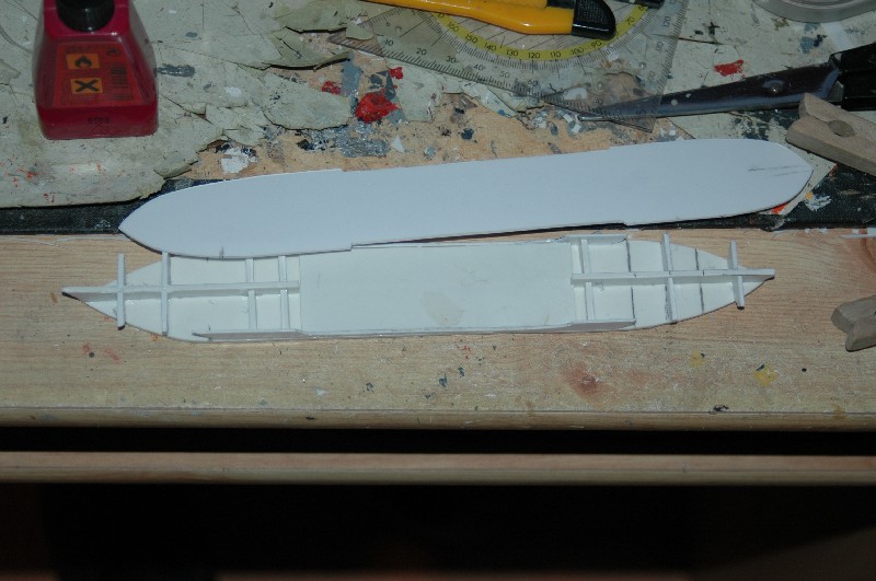

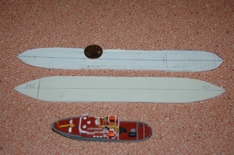

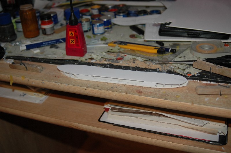

Here we go then. Composed of the last few days together. Got a little more involved in my Song class sub though. Hope to continue this one this evening or tomorrow.
Photobucket is not really cooperating so I'll upload them here for now.
The merchant shipyard
Neptune
Posts: 2466
Re: 1/700 Ocean Going Rescue/Salvage Tug + Tanker
Post by Neptune »
Some explanation with previous pics.
First I cut out the main deck and "waterline" area. Then I place a longtudinal section of 2mm styrene in the middle to match the sideview. Afterwards I added the parallel body, which I had to estimate and measure from pictures.
After that I add frames forward and aft of the parallel body and some between the parallel body. I don't really cut in the longtudinal section to avoid warping (I noticed before that my waterline was already warped before I actually glued anything to it). Anyway, up till now it's straight.
And this picture is where I am for this moment. The deck below the main deck in the middle is put in place.
I also put the two tanks/holds in there (I suppose they are the tanks for the liquid cargo since the main fuel rigs are mounted on top of them). In between there is space for the manifold. I'm not sure what is in front or aft of them, so I'll have to improvise a bit or study my pictures a little more. I'll have to do that in order to proceed since I have to finish that deck before I can mount the main deck and I have to mount the main deck before I can start using the milliput to finish the bow and stern shape. Lots of work to do and the Song is of course continuously bothering me. But I hope to finish at least the hull before I'm leaving.
