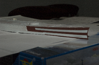

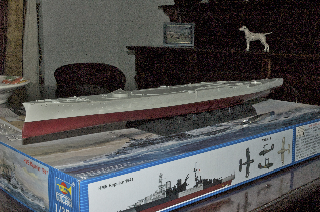

Hi all,
This is my first ship model in over 20 year and the first plastic model in more than 15 so any help would be appreciated.
I'm attempting to make an accurate version of Repulse as she was sunk in 1941. This is based on photos, underwater video, the plans from the 1936 refit and additional original plans of the 1939 deck houses (thanks to John Roberts!)
I plan to make use of the WEM PE set and also the GM Hood set (when it eventually turns up!
As has been discussed elsewhere, while the Trumpeter kit is fantastic in many respects, it is also wrong in several areas and seems to be a mixture components from 1936 to 1941. And while it has very fine detail on such things as hatches etc, other areas such as the hull plating are completely absent..... but more later.

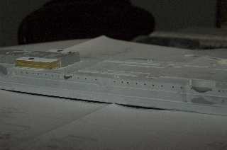

The first thing I've attempted is to add the butt straps. These are visible on many of the close up photos. I've chosen to use domestic aluminium foil as I wont be able to sand them back once in place without loosing the "eye brows" on the scuttles.
I've also removed the 3"HA gun shield (the Trumpeter version is as per 1936) and replaced it with 2 thou brass.

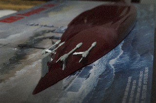

The next thing was to add the inboard struts to the A brackets of the prop shaft support. How they could leave a big item like this off is beyond me!
The deck houses came up for attention next. These were altered for the Royal tour that never happened and were subsequently turned into cabins. Today the scuttle have rusted out and fallen in and one can look into these cabins and still see the remains of beds and the bath in the bath room.
I removed the raised section on the forecastle deck and tried out the WEM PE deck house. Unfortunately it's not correct. It only has 6 scuttles (the original had two extra for the bathroom) , has hatches at either end and does not have wood decking on the roof. The correct port deckhouse house is not supplied in either kit.
Here's the original plans:
So I've remade both houses out of 3 thou brass. I'm awaiting the hatches on the GM Pe fret to add hatches and widows on the port house and the "eye" brows for the scuttles on the starboard house. Hand rails are made form stretched sprue.
The armoured step that the model has at the rear is also not visible on any photo or plan that I have.... So I've removed it:

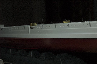

Finally.... for the moment, I've started to attempt to simulate the hull plating by using spray filler and masking. The hull plating on Repulse is quite subtle compare to say Hood. I've not tried this technique before...... hope it all works out!
Anyway... that's where it's at at the moment.... more to follow.
Any advice much appreciated.
Andrew

Very impressive thus far... looking forward to seeing the continuing progress of your build!
As for the hull plating simulation, I have used Gunze's "Mr.Surfacer 500" in a current build. The difficuly is to know when to stop. Too little and it may disappear under a coat of paint, too much and it will not look right!
Anthony

Hi Andrew, I'm glad to see your re-build of the rear gunhouse, To me the replacement sets are not accurate, I look foward to your progress. J CRAY

Andrew F wrote:The next thing was to add the inboard struts to the A brackets of the prop shaft support. How they could leave a big item like this off is beyond me!
Trumpeter did the same thing on the Essex class kits.
Very nice work - inspiring stuff!! My only complaint is the pictures are too small! :smallsmile:

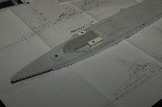

So A little more progress!
I found some pretty good chain a the local model railway shop, seems just the correct size. The blade stopper and the hawser grills are from the WEM PE set.
First time I've used PE..... very impressed! (also the first tile I've used an air gun!)
The rear superstructure now come up for re modelling as the kit is wrong for 1941.
A new hole had to be cut for the ladder on the starboard side and the sides covered in. Still waiting for the PE set with the hatches etc!
Andrew

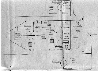

So just when I thought I had the bridge area sorted, I noted that the plans I put up last night differ from the drawing I was using!
The lower bridge deck has a control room and a lobby on each side that extend to the rear of the deck and the hatch that I had assumed was a ladder up is actually on the deck below.
Lucky it's all still in "dry run"!
The floor was filled in and an approximation to the house made. To make it exact would be very difficult because of the mast legs. However, I believe that once painted etc it will look correct.
