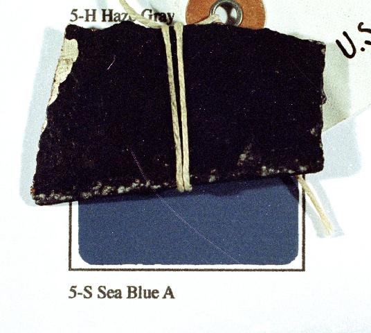

The pictures of the piece of Enterprise in 5-D over the color chips are below. This was the piece that made us believe that Arizona was in 5-S, given how dark 5-D was.
5-D over Sea Blue A
5-D over Sea Blue A
5-D over Sea Blue B
5-D over Sea Blue B
5-D over Sea Blue C
5-D over Sea Blue C
5-D over #82 Black
5-D over #82 Black
