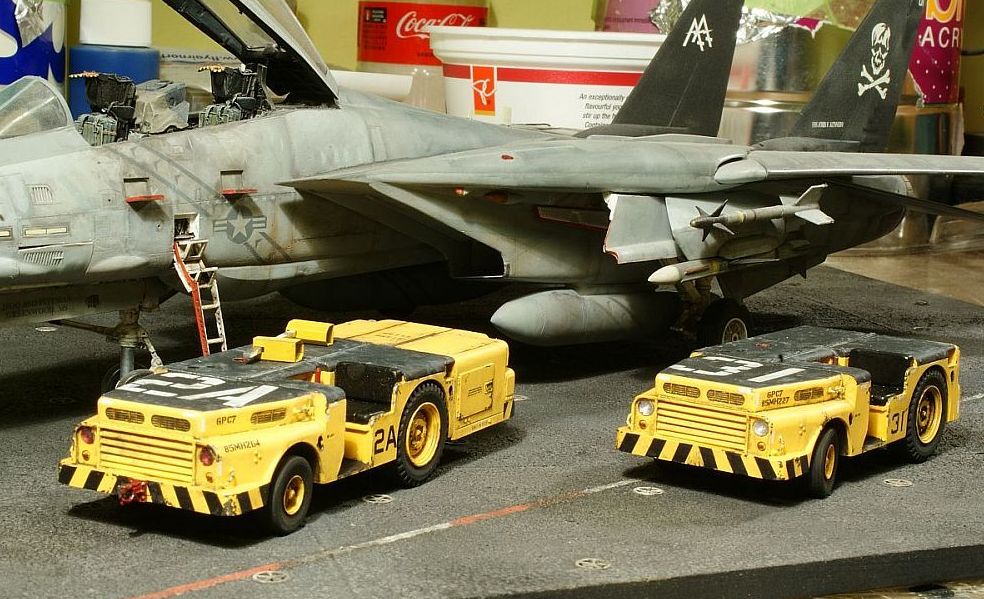

Also, if my progress seems even slower than ever , it's because other Navy projects keep stealing my time. Like these darn tractors:
But this is a shipbuilding forum not a tractor or airplane building one.....

This is true, but those planes and tractors are what "live" on some of the ships we build, and I for one enjoy seeing them!anyahajobuzi wrote:Also, if my progress seems even slower than ever , it's because other Navy projects keep stealing my time. Like these darn tractors:
Keep up the excellent work on your build. I enjoy reading and looking at it and being inspired by your attention to detail

If I had been looking at any other build I would have not wondered for a minute how you accomplished that in 1/350 scaleanyahajobuzi wrote:Also, if my progress seems even slower than ever , it's because other Navy projects keep stealing my time. Like these darn tractors:
Still, VERY nice top-class work!

Thank you Channel! The tractors and the Tomcat are 1/48. I sure wish I could just shrink them to 1/350 with some magic...The plane isn't finished yet though..actually, the tractors are missing towing hitches too. But now it's: carriertime!

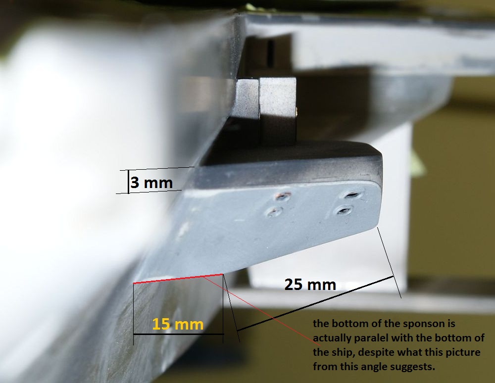

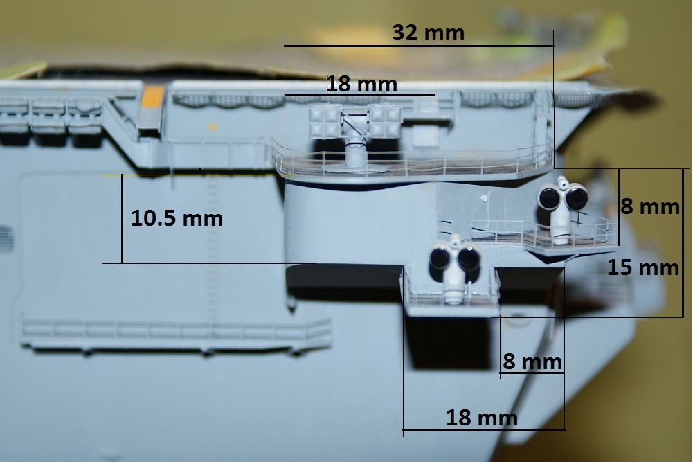

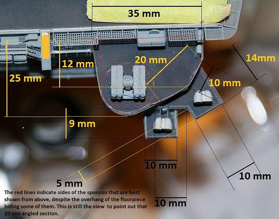

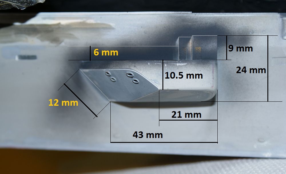

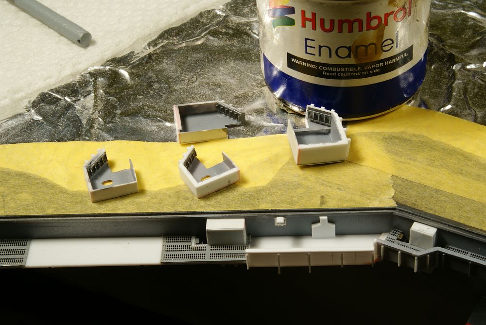

Hello everyone!
Boomstick68 asked for the dimensions of the scrathcbuilt weapon-sponsons, and I saw how DWD shared this kind of info regarding his very impressive Enterprise, so I figured I post these here for everyone to look at. Do not look at the images too closely though, because my mistakes become very obvious....
I got some angles to correct, and some railings to straighten out. Anyway, there were 2 new weapon sponsons installed on the Nimitz (and the Eisenhower) in the early '80-s, both on the port side. Or, to be accurate the one on the bow for the CIWS was newly added, and the one on the stern was redesigned, and it holds Sea Sparrows, and 2 ...hmmm I dunno, range finders?! Maybe someone can tell us what those 2 thingies are on the sponson extensions.. Then in the ninties they redesigned the sponson on the starboard , stern. I didn't need to build that one , so the dimensions for it have to come from someone else.
I hope the photos below are going to be useful, and that I got ALL the measurments.

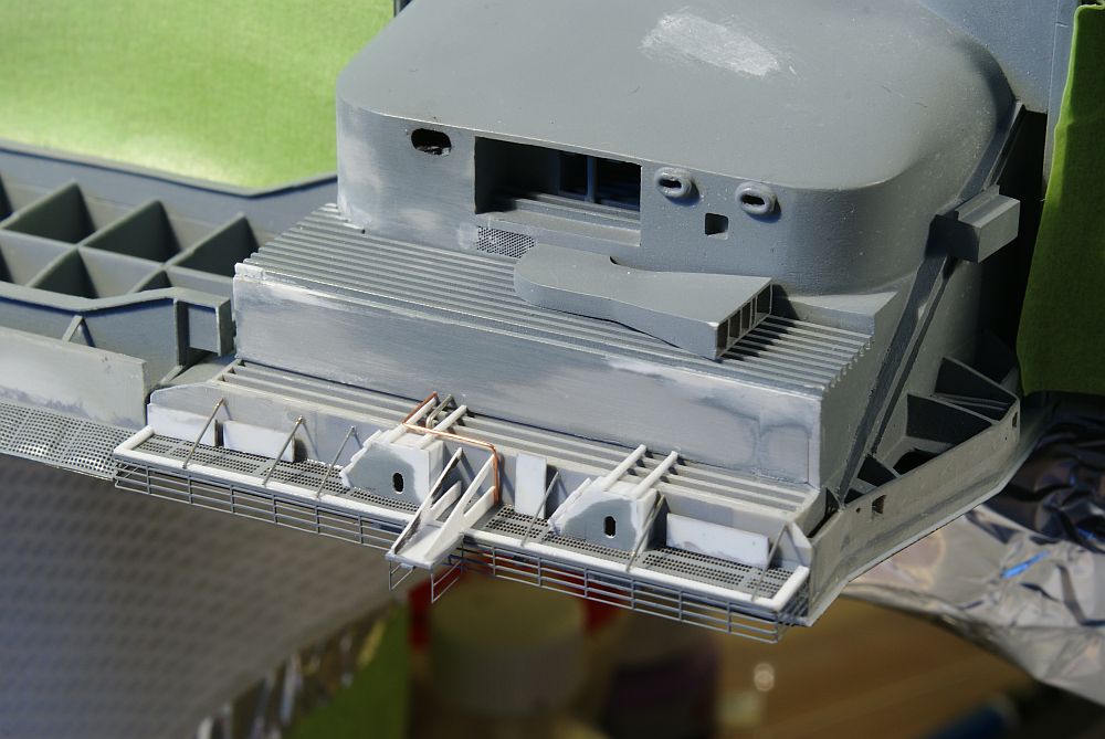

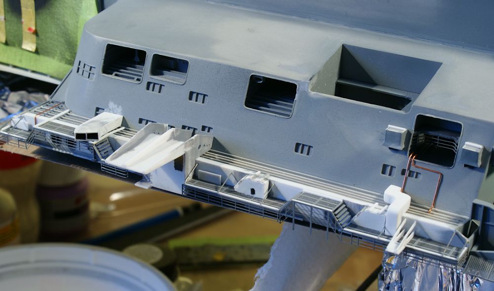

Allright, allright, let's get down to serious business!:)
I have worked LOTS on the catwalks. ( I think the wife is composing divorce papers.)
These are just the starboard side ones and are just before the paintjob. I didn't use ANY of the Trumpeter pieces here, because they are all garbage. And that is "sugarcoating" it. Unfortunately the different lenghts of the sides are also out of whack (like the section between elevator #2 and #3 is 16 milimeters too short), so there is simply no room for all the details, that are on the actual ship.
There is lots more stuff to be added after painting, and I will keep the pictures coming. I am experimenting with some pre-shadig (thank you Koppalakki) and the next few days are gonna be spent with splashing paint onto this baby. I am growing grey hair over turning this ship upside down for working on details underside, because something came loose inside the hangar, and now the biggest project of my life sounds like a rattle.....

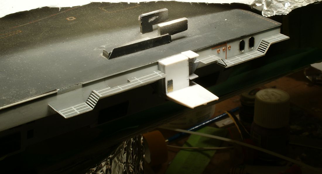

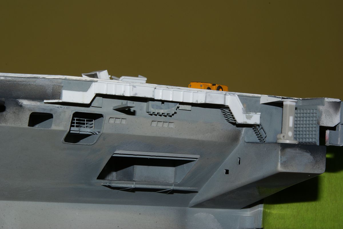

This is the area where the angle of the deck was changed...

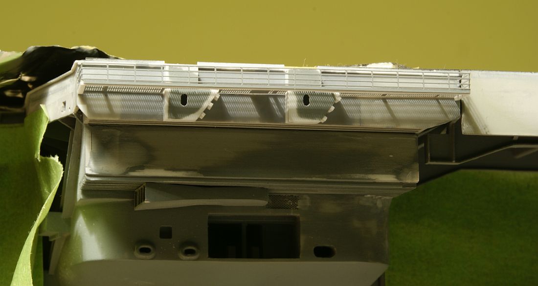

AAAnd the bow section. This is a bit tricky because of the weapon sponson below being in the way..
After consulting some photos, it became apparent that the catwalk supports provided by White Ensigh are the wrong shape, those braces in real life are just a simple steel tube instead of a triangle shaped piece. So I just cut the bottoms of these PE pieces off, and used only those, discarded the rest. White Ensign doesn't give us enough these pieces anyway, so using only a tiny strip of brass instead of the "triangles" makes it easy to make up for the shortage.
Cheers!
Cheers!

Ok, I was thinking that though you are going to the extreme on this thing, that you were at least keeping it mostly within the threshold of sanity (relative term coming from a fellow CVN lunatic) but then I saw that you made the enclosed stairwells under the catwalk hollow, and installed a ladder inside! That tiny little detail is what pushed this build over the line for me, honest!
Great work for sure, but I tip my hat to ya, you are more insane than I am with this thing, without a shadow of a doubt! Keep it up man, this is already a stunner, and only getting better.
Oh, and if she does divorce you, it just gives you more room for modeling and displaying models, trust me, I went through the big "D" a couple years ago, and my modeling benefited greatly!
