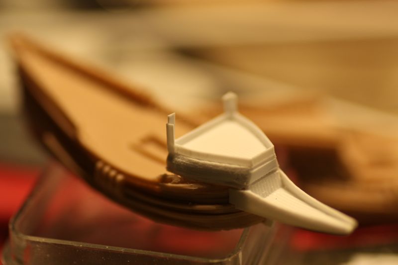

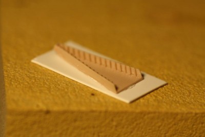

After six months of building masters that have to be cast, rather than actual models that one can paint and detail in the normal way, I was finally able to actually begin building models from my resin casts... :woo_hoo:
I was very much hoping to get some pieces glued together and painted up in short order so that I can show these ships in more appropriate and realistic colors, but, alas, the enthusiasm of building took me down some rabbit trails, as you will see.

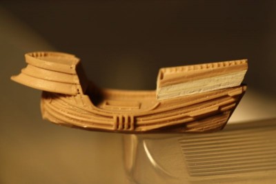

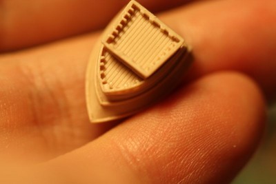

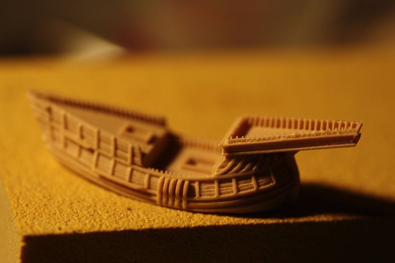

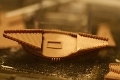

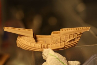

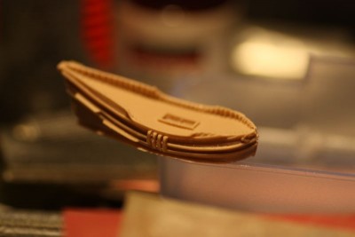

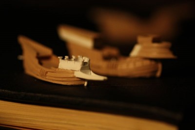

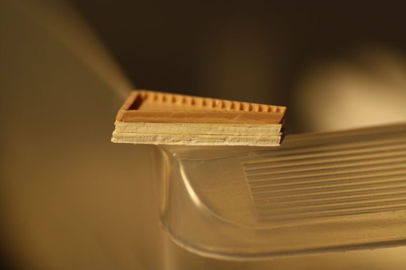

A completed Carrack Forecastle in Resin.

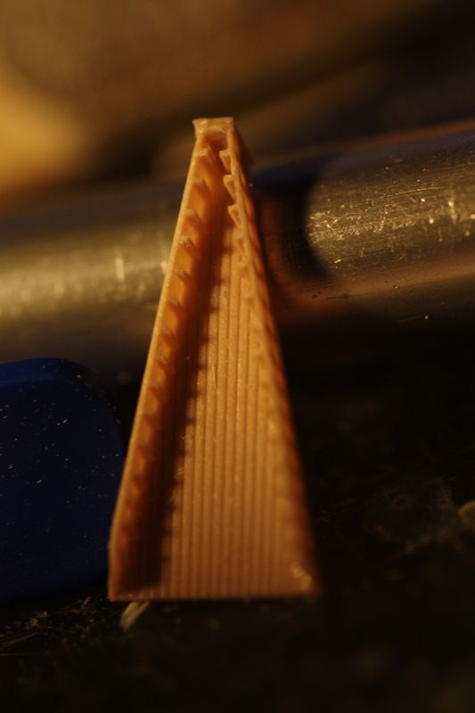

These pieces are rather flawed on close inspection. The bulwark of the lower 'flat-iron' piece (Rusty's term) has a slight curve to it, and the forward bulwark of the cap piece is not quite straight on its lower border. The hole at the left end corner in this picture resulted from my attempting to correct the flaw by sanding it straight. No big deal. I will be refacing these with either strip plastic or details to hide the defects later.
Air bubbles in the back, but this is no problem, as I will cover this with either styrene or PE facade.

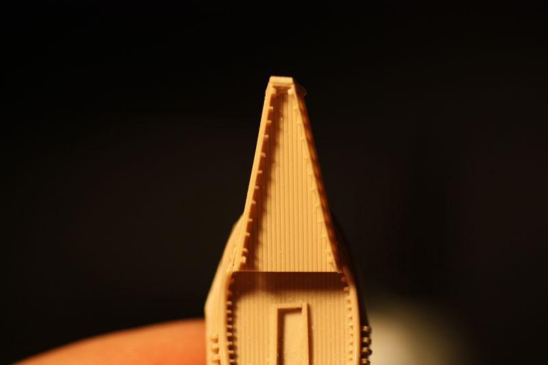

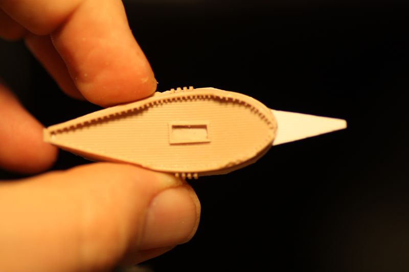

View from the top. The best angle. :big_grin:

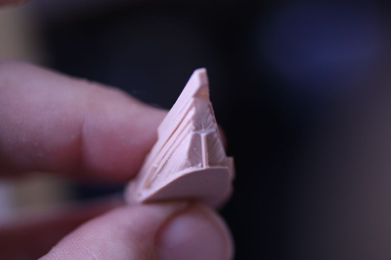

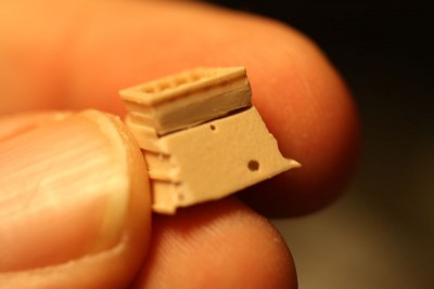

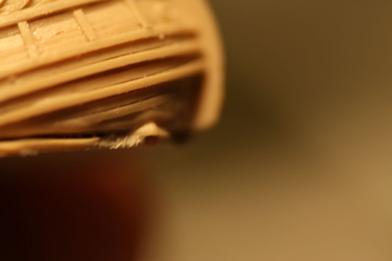

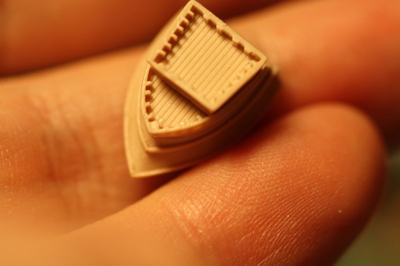

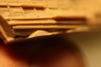

In my giddy enthusiasm of seeing my very first resin casts, I did not notice some imperfections that later became apparent. There are some globs of material partially obscuring the planks at near the waterline of both Fatty and the San Bruno hull. Not impossible to fix, but something I want to improve on next time.
More imperfections. I will probably try to hide the lack of 'post surgery' detail here with waves and wakes at a later point.

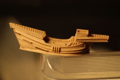

The bow is fortunately clean.
Cleaned up.

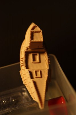

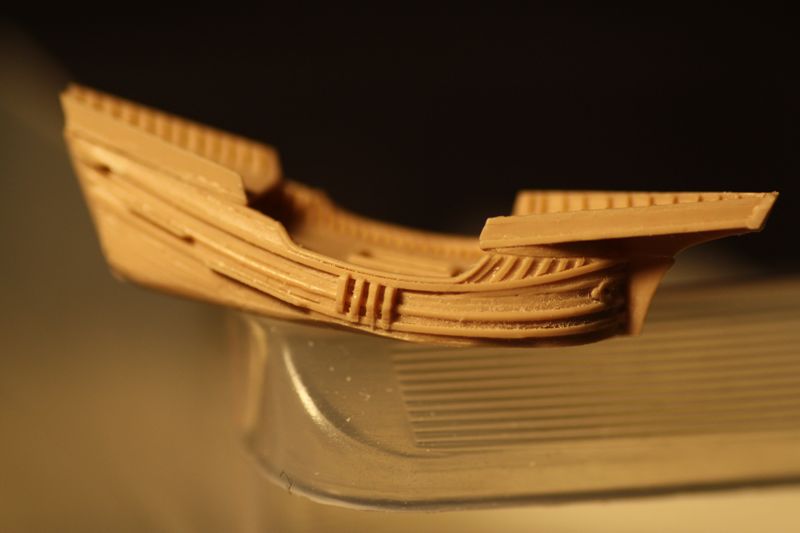

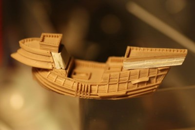

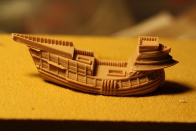

So let's make a Carrack!

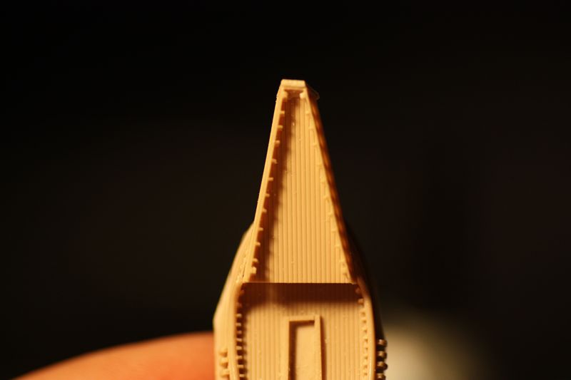

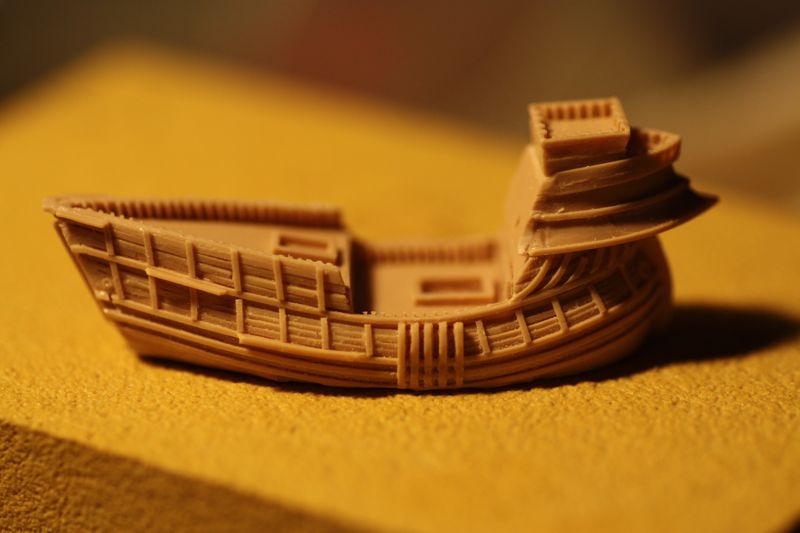

I want this first one to be 'high charged' but not impossibly so. The great thing about these resin hulls is their adaptability to different configurations. Let's sand down the forecastle before adding a superstructure.
Forecastle in place. This looks rather blank at the moment, but the long plain sides of the forecastle will be filled later with custom PE by Brass Master Bruno Gire. :woo_hoo:
Let's add some height to the poop deck.
I want to cut that wedge deck shorter, to give it some variety, and also to create more open space for the upper cargo hatch. I made the decision when creating these wedge decks to try to make them so that they could be applied either to the bow or the stern, and also to make them of maximum length so that I could shorten them to create variation in the different builds. The whole idea was to make as many options as possible, in order to help disguise the common origin of the relatively few pieces.

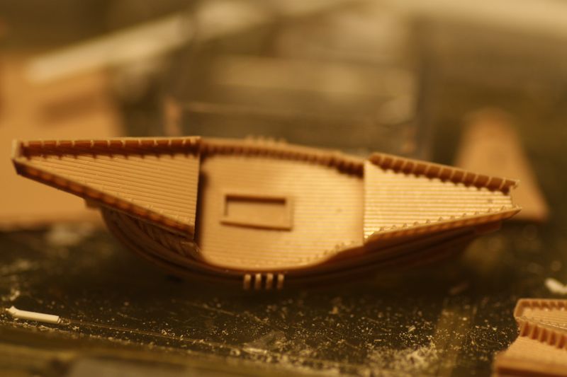

After 'castle' in place. Not a dry fit, not a pose, actually glued on... FINALLY !!!! :thumbs_up_1:

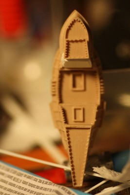

Overhead view of 'Carrack #1.

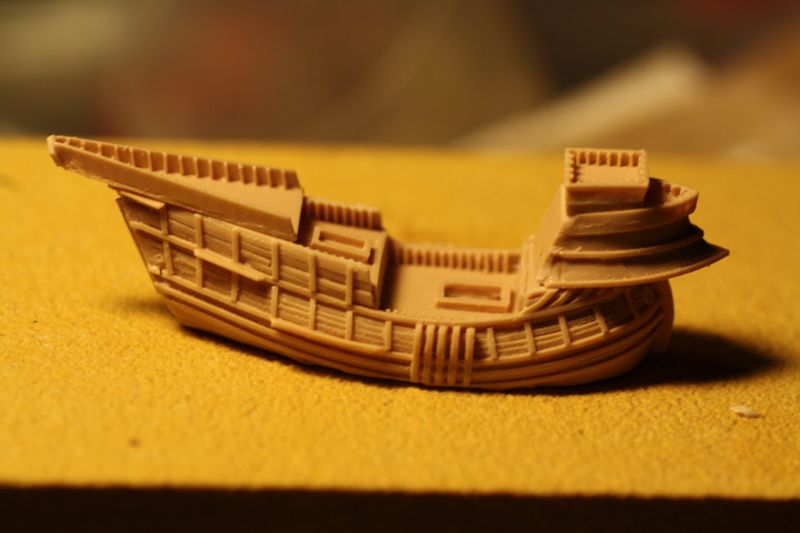

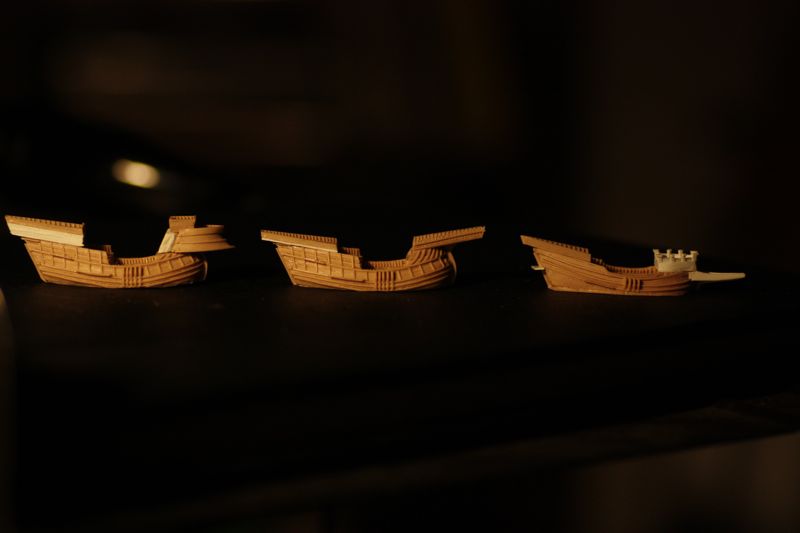

Carrack 1 took about twenty minutes of work. :woo_hoo:
What else can we do?

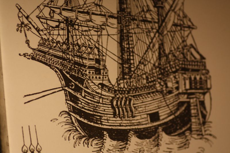

How about the fabled 'Flemish Carrack' of the 'WA Kraek' engraving that is present in virtually every book on the subject?
Here is the engraving enlarged from a book on my reference clipboard. Notice the very light double decker staging for the fighters to shoot from during battle. The Carrack was a very manly type of warship, since the whole design was created to facilitate hand to hand combat. I am hoping to mount the two decks with enough space so that you will be able to see into the lower decks. A powerful-looking, yet light and fragile structure.
Here I have plastic as spacers to approximate the configuration of the superstructures in the final assembly. Imagine on top of the fore and aft castles the additional gabled framing for the anti-boarding nets. This will be a very imposing ship if I can put it together right.
Carracks 1 & 2 together.

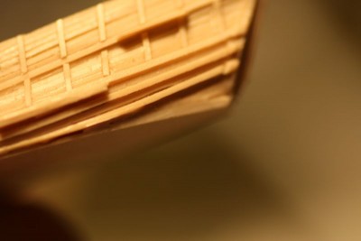

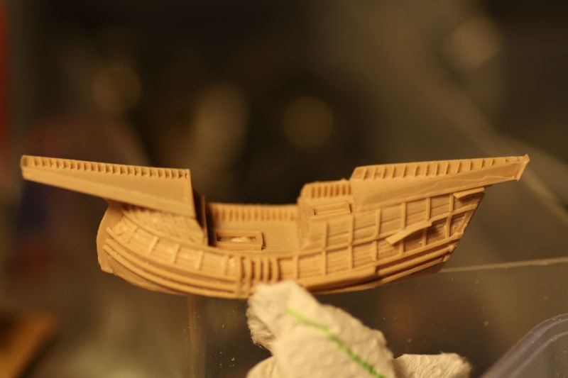

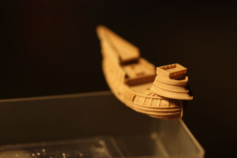

Here you can see the shape of the Nao forecastle with built in sheer is slightly misaligned. The rear edge will need to be trimmed on the starboard side to make it even.
The Nao took about 5 minutes. Time for Carrack #3.
This one we will leave the 'cap' off and have only a 'flat-iron' wedge at the front end. Notice the raised after castle, block-like. I'm trying to get that 'Anthony Roll' look. The rough plastic sides of the after castle will be 'faced' later. Maybe she will be a small English carrack.
Group photo. Carrack 3 uses the San Bruno Hull, while Carrack 1 is made from 'Fatty.'
Significant difference in height. I feel that 3 would probably lose to 1 in a fight.

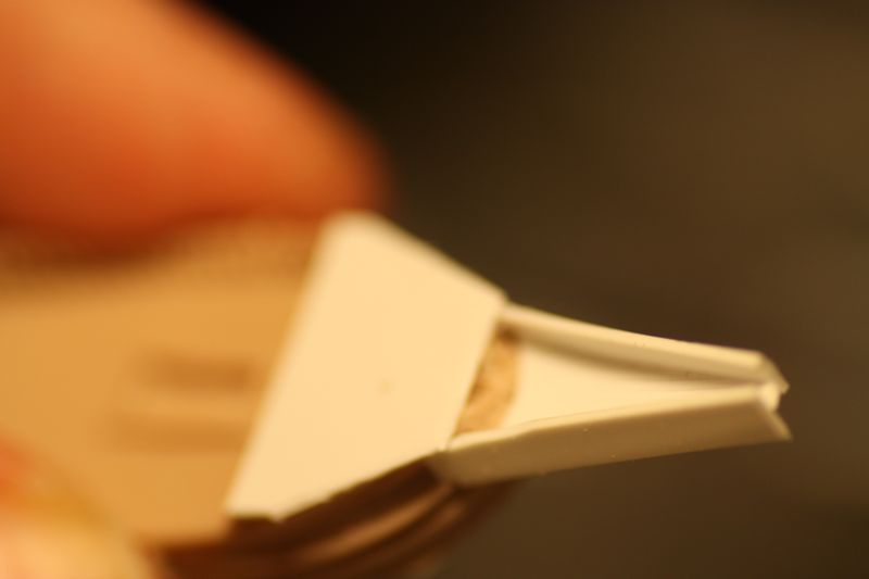

Ouch!!!! Who else has done this?

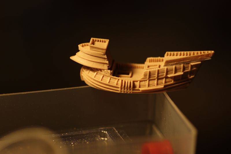

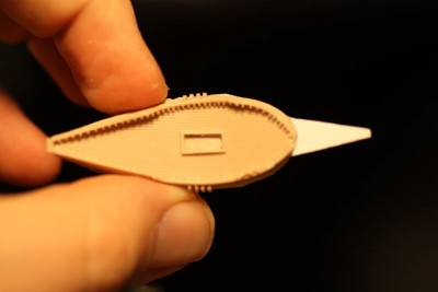

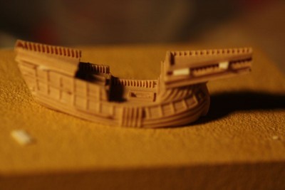

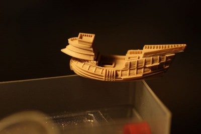

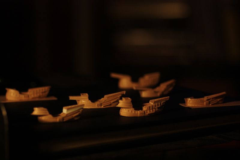

San Bruno Iberian Nao.

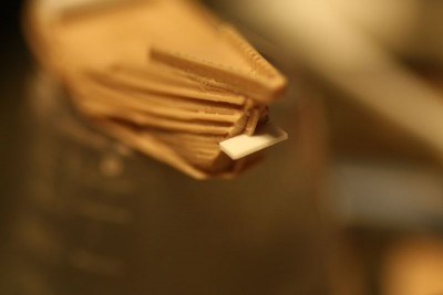

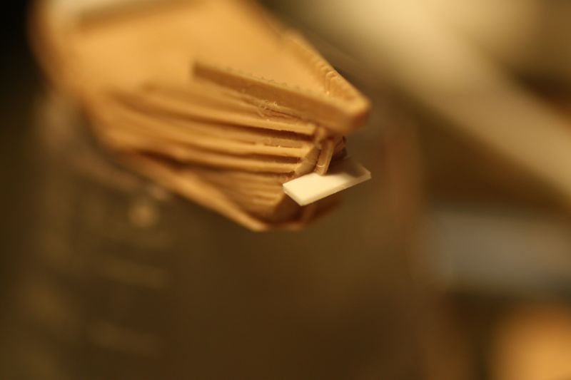

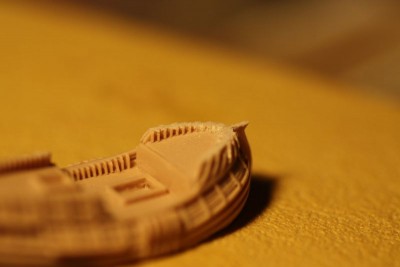

Clipped the back end of the stern rather than leaving an overhang. Again to create variety. The open end can be easily faced with strip plastic.
This was the reason for resin casting, so that I could build a large number fairly quickly. There are some additional builds not yet covered in detail above, including a Levantine Argosy (Fatty hull + 2 full length low wedges fore and aft) and a slightly smaller 'Flemish Carrack' similar to the one above but with shortened forecastle deck. In addition I plan on building several 'Fatty' hulls without superstructures to serve as 'hulks' or 'urcas' etc.

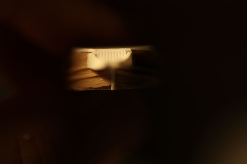

Closeup of the Levantine Argosy. Notice damage to mizzen mast chain plate.

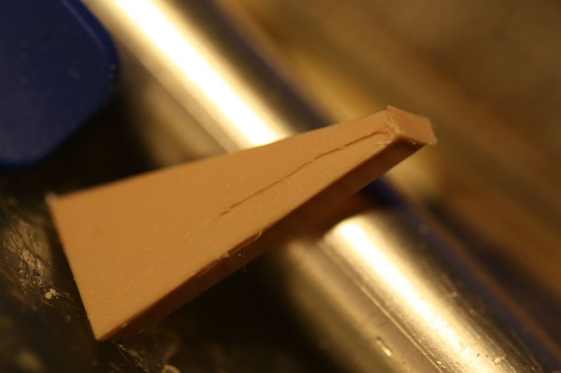

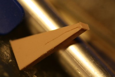

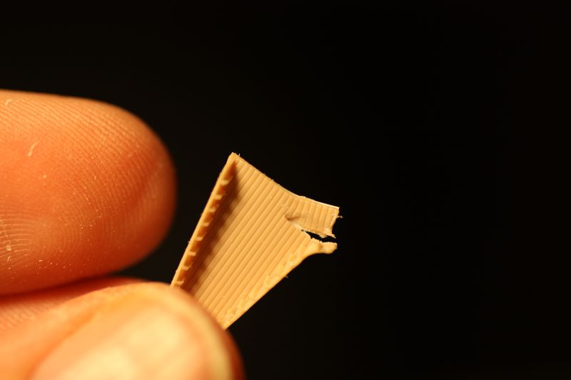

This looks like a very disappointing crack in the deck piece...
However the piece is actually undamaged. Some kind of flaw in the molding. All that is needed is to sand down the underside.
Included in this group shot is the 'not-really-working-galleon' dry fit which I did not wind up doing.

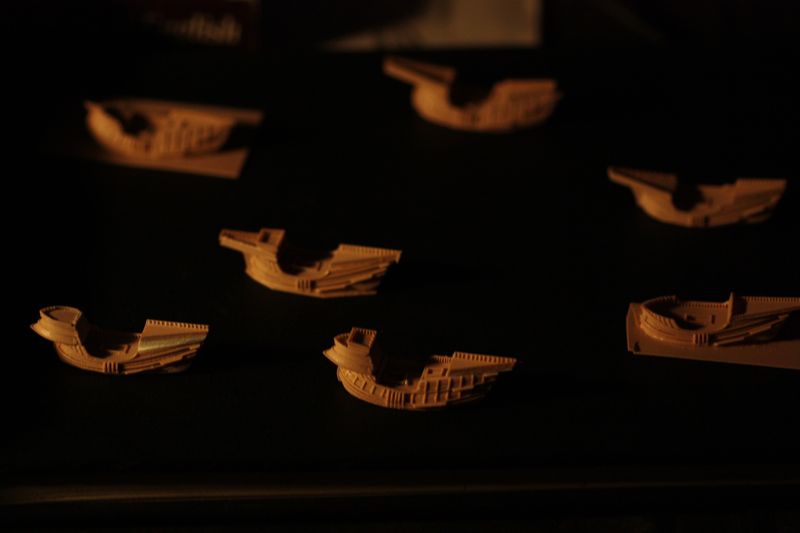

New Casts from Rusty.

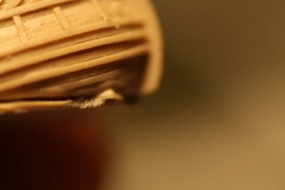

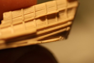

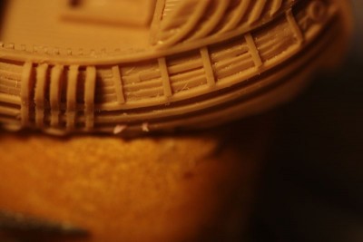

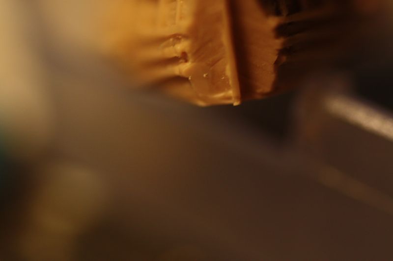

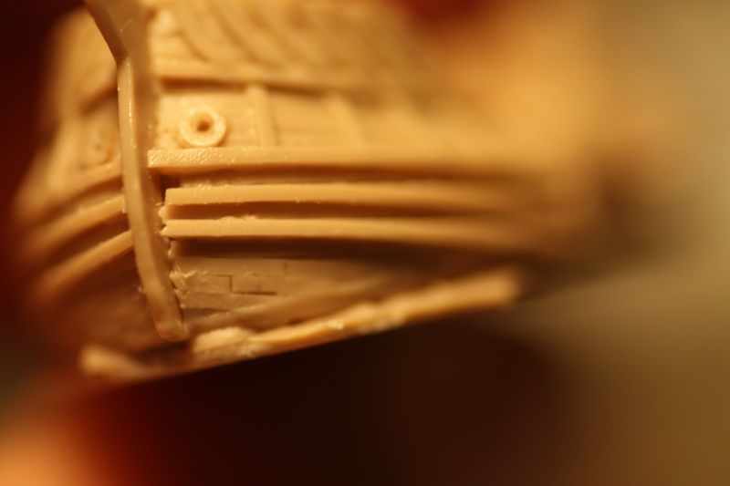

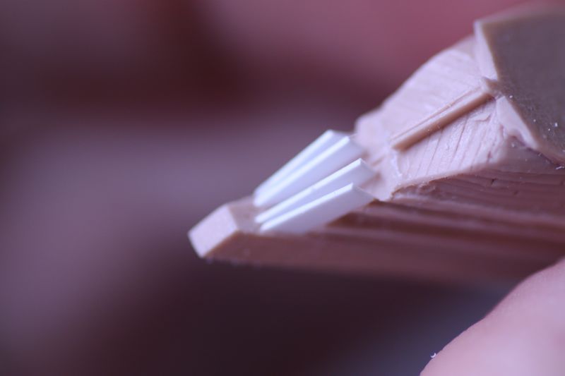

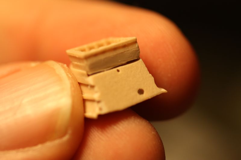

Uh oh. Bits of pink mold rubber showing up in the casts. Sure enough, in the next batch there were blobs of resin (flaws) in the hull. Rusty had told me that a mold ought to last for up to 40 casts, but we are already having issues at around 20. It seems that while the small details of these masters are castable, they produce shorter-lived molds.
More imperfections showing up...
A large bit of rubber adhering to a fatty cast. More flaws can be expected... :heh:

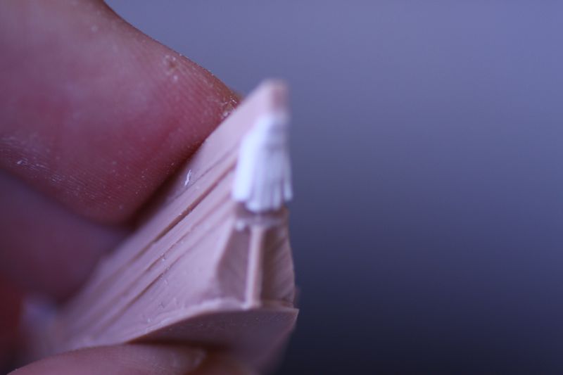

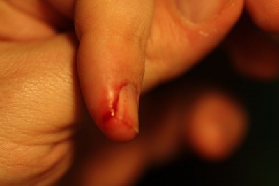

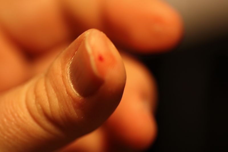

Ouch again!!! This one really hurt. Sliced my finger wide open right next to the nail! It has opened up several times since then too, very painful. The cause was a dull curved blade. Dull blades are more dangerous than sharp oneS!

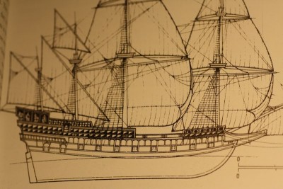

How would we make a galleon? This profile from a book of mine gave me an idea...

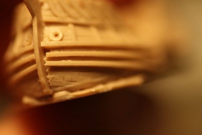

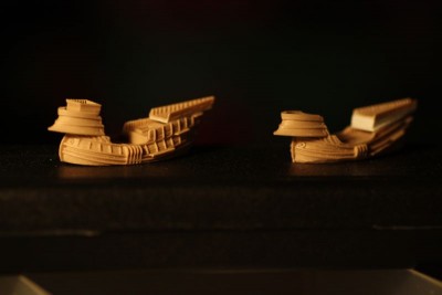

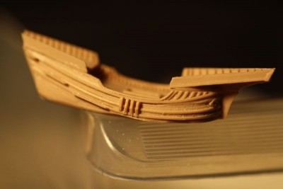

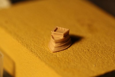

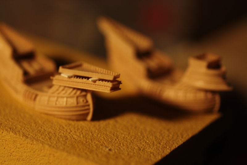

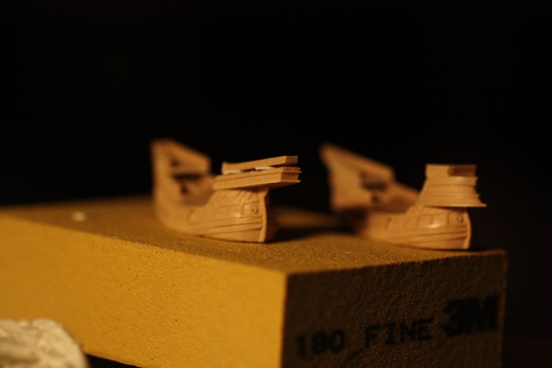

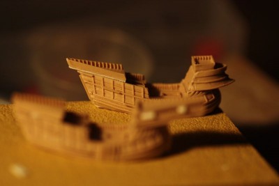

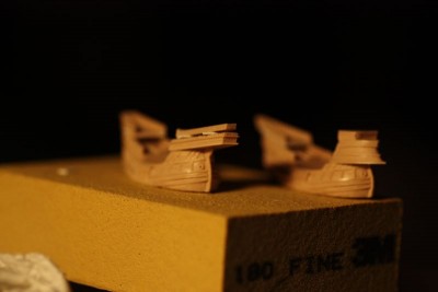

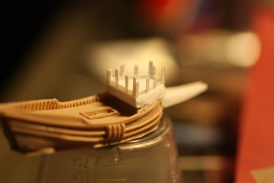

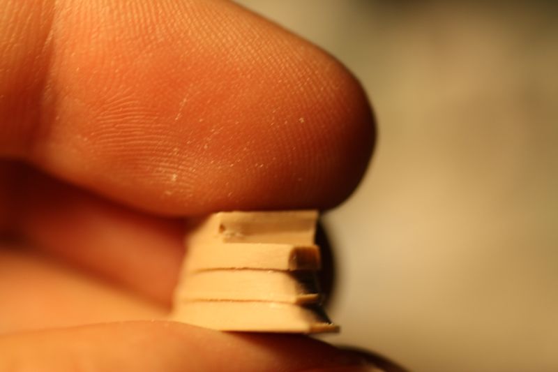

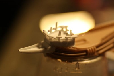

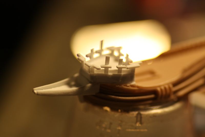

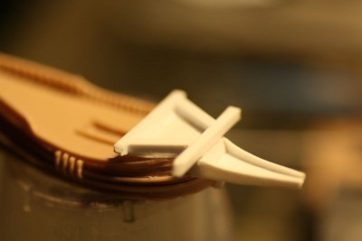

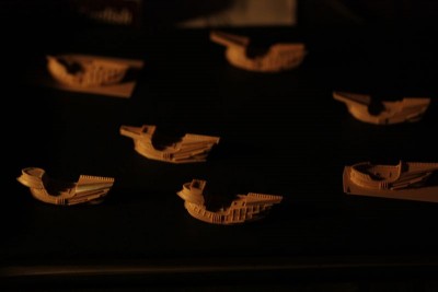

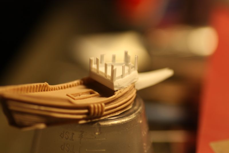

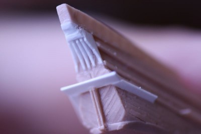

Classic Armada seascape. Some of these ships are quite tubby. Couldn't we make a galleon from a carrack hull? Maybe the Bruno hull, since it has finer lines?

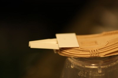

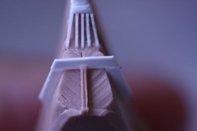

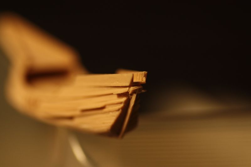

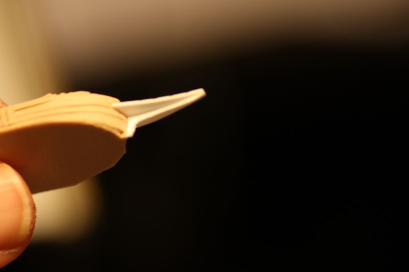

Step 1. Sand down the forecastle.

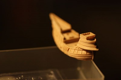

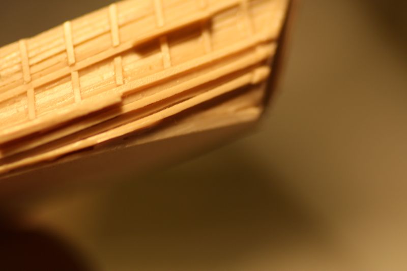

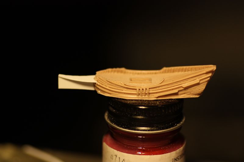

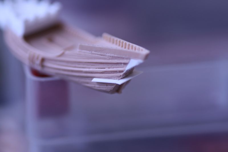

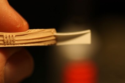

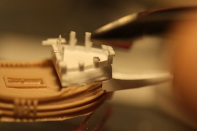

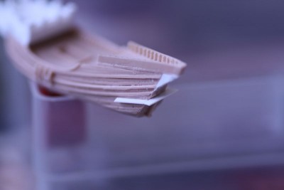

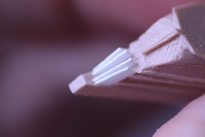

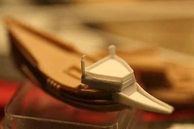

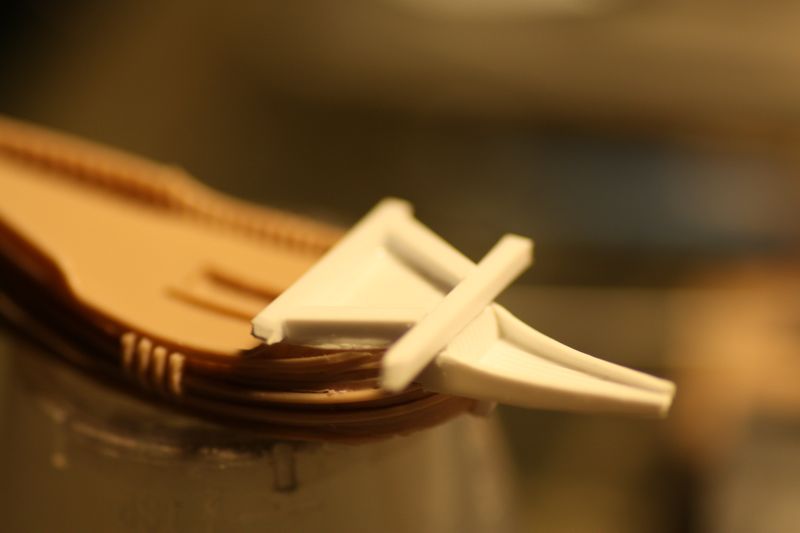

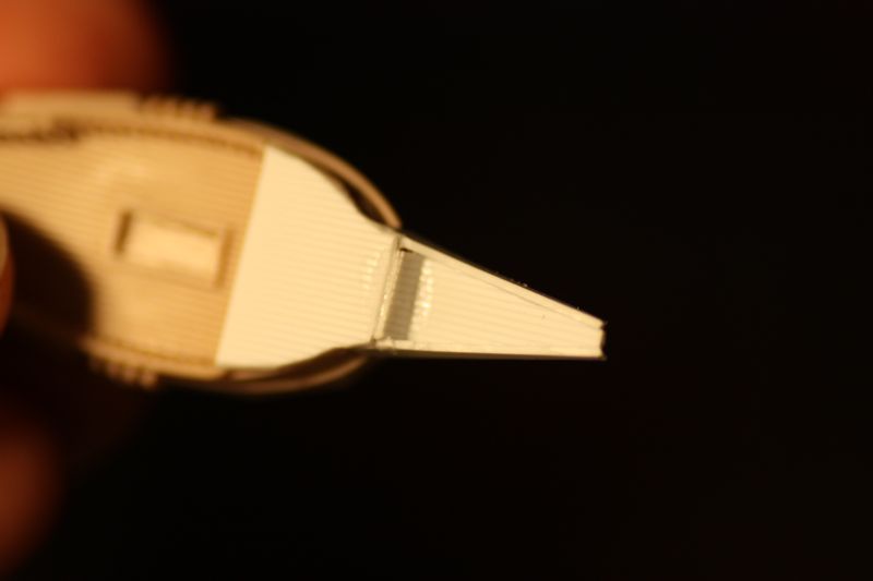

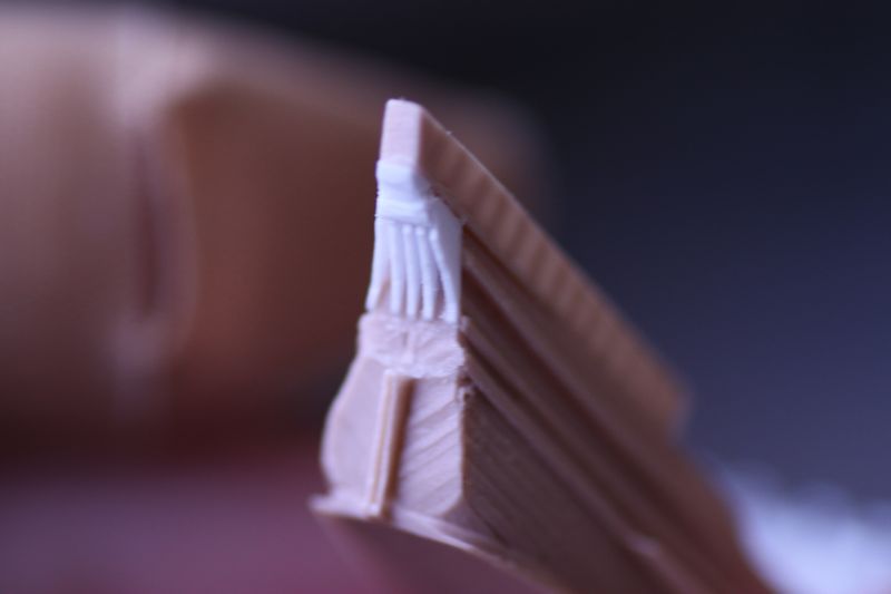

Step 2 create a beak below the edge of the forecastle. That was the idea the above illustration gave me. Suddenly it's starting to look right.
Funny upswept curve on the beaks of many of these galleons. On reflection, the relationship between the Galleon and the Galleass types is a little clearer. This beak seems straight off of a Lepanto Veteran. And many of the illustrations from the period seem to confirm this. I had thought that the term 'Galleon' bore no relation to 'Galley' or 'Galleass,' despite the similarity in sound; that there was no fathoming the Byzantine confusion of 16th Century warship terms. But I'm starting to feel now that there really is a relationship between the Galleon and the Galleass. Many details of structure are similar between the two types. Of course, many differences as well... Feel free to comment. I'm not an expert.
Funny looking at this stage!

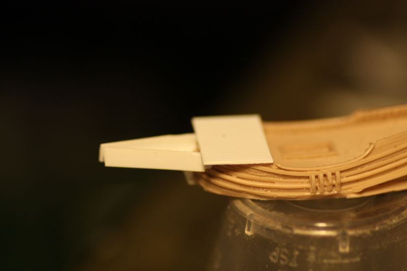

Stem is trimmed. Feeling good about this one... I'll keep going...

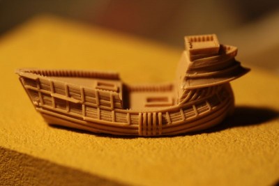

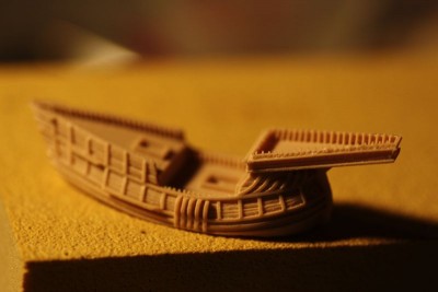

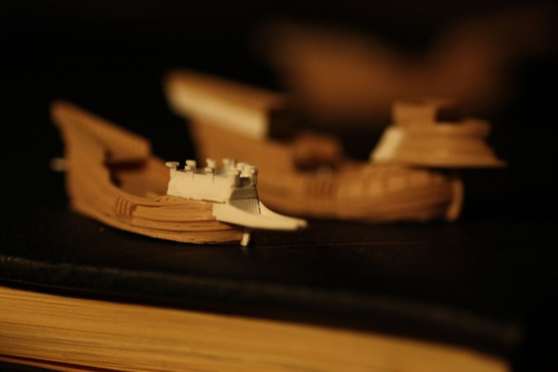

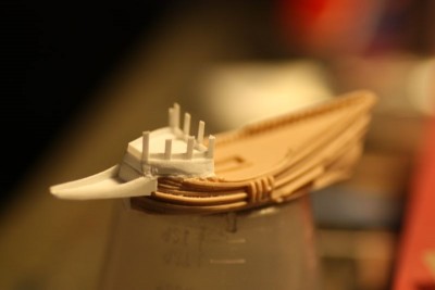

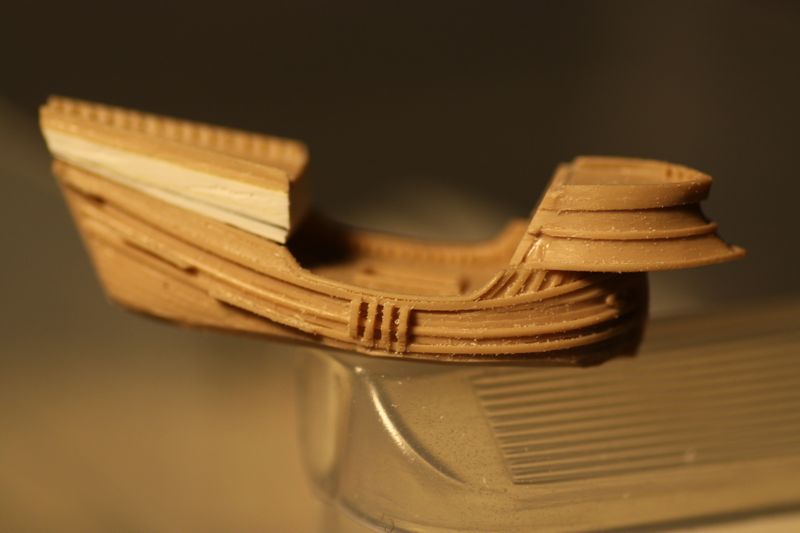

Ok. A galleon in earnest...
Pessimists see the world as it truly is...
Optimists change the world.
callen
Posts: 998
Joined: Fri Dec 21, 2007 4:10 pm
Re: Scratch Building the Portuguese Carrack in 1/700th Scale
Post by callen »

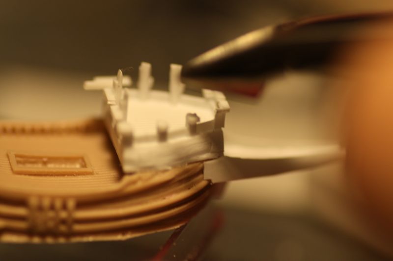

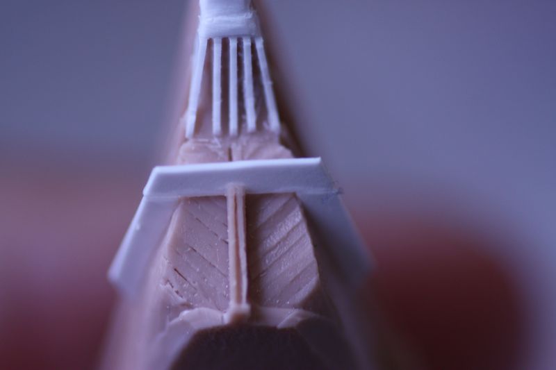

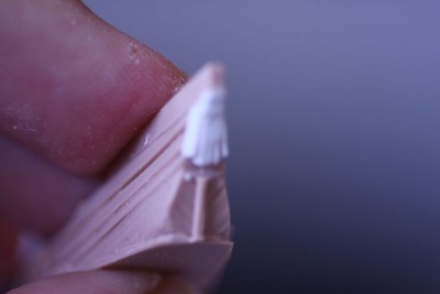

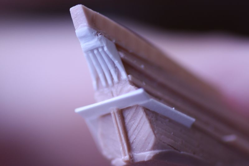

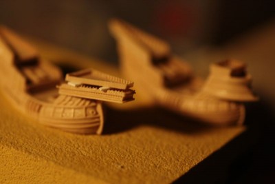

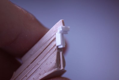

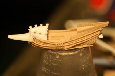

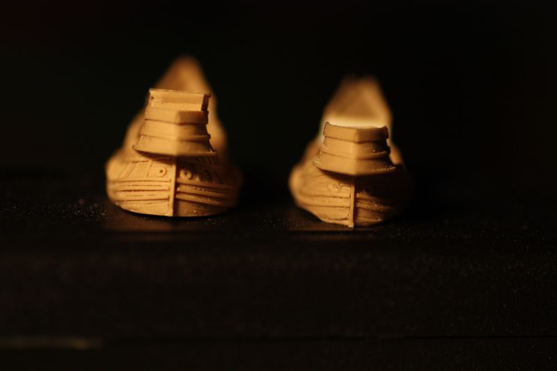

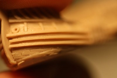

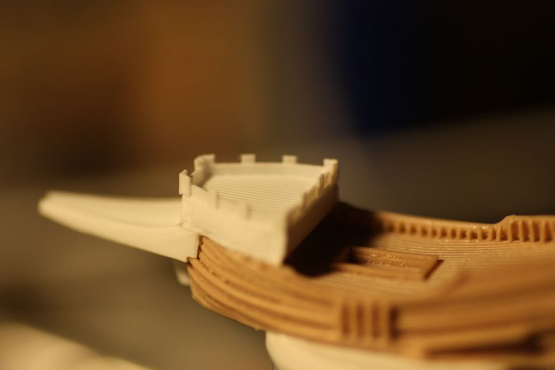

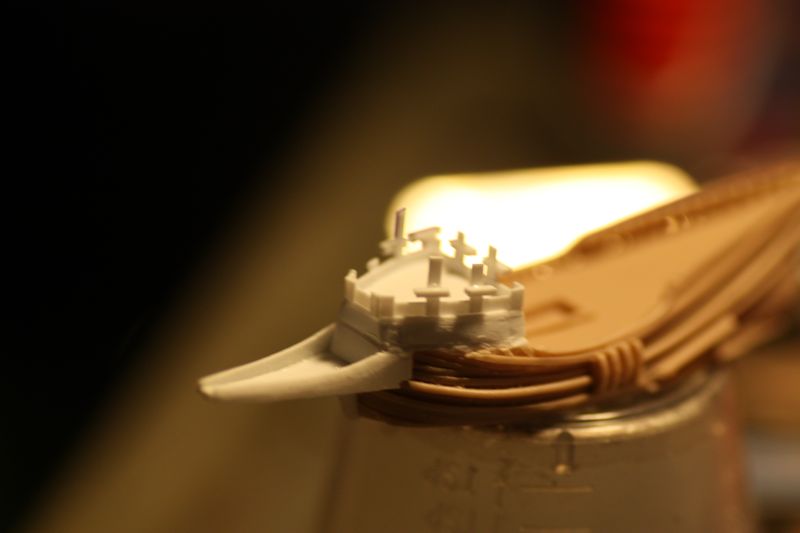

Yes. A Spanish Galleon, with Crenellations...
...and a stern gallery...
Group comparison shot. The Galleon is significantly lower than the Carrack and the Nao.
callen
Posts: 998
Post by callen »

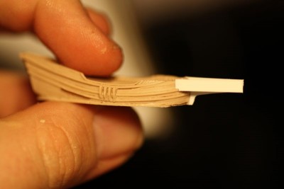

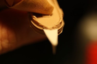

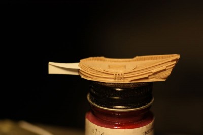

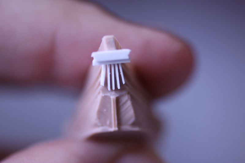

That stern gallery wasn't working... we need to do this properly...
That is way beyond my abilities to model in this scale, but maybe I can do something simpler...
