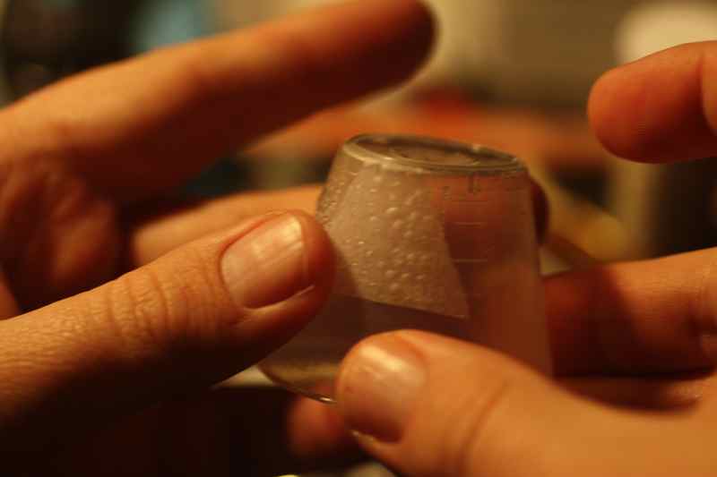

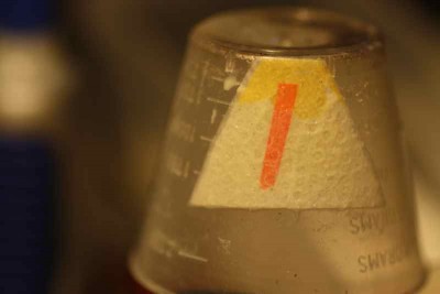

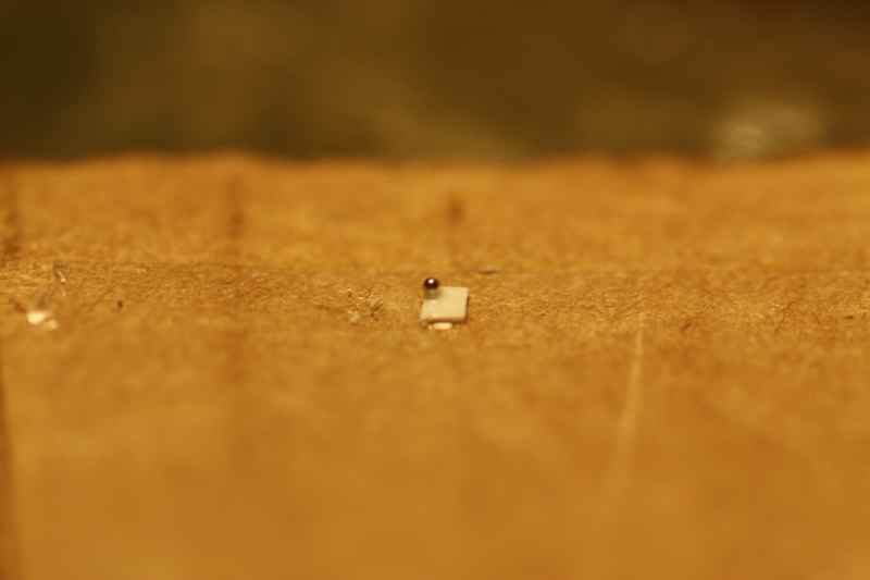

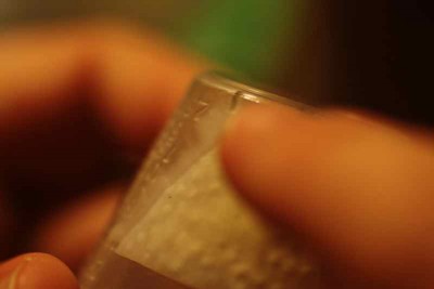

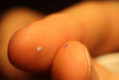

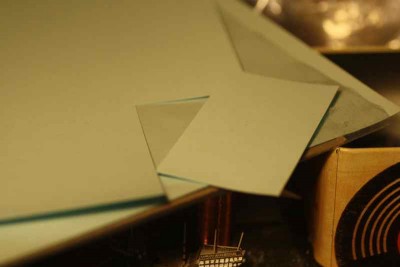

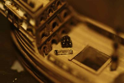

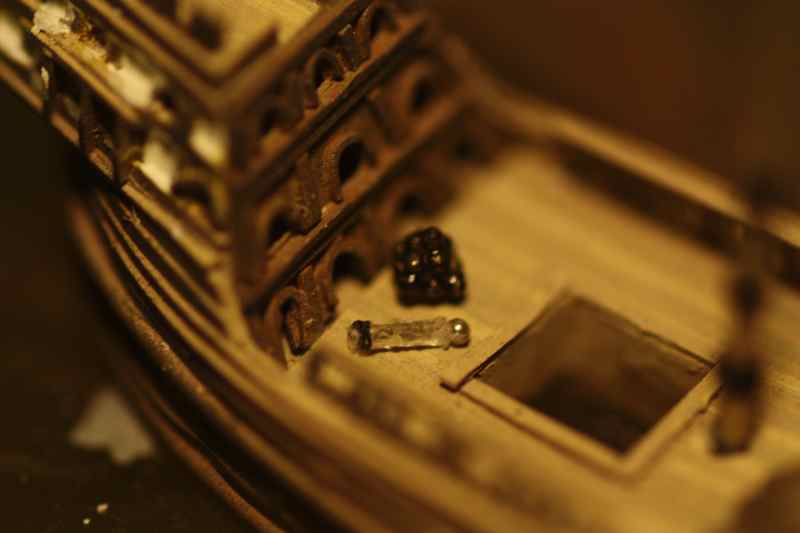

Time for a new update my friends... The friendly and helpful response I have gotten on this board really inspired me to work hard at this little ship. I have to say, having an audience really puts you under the gun to keep things going... :eyes_spinning:
I decided I wanted to share the things that haven't worked out so well, as well as the things that have worked out. I think it's good to get feedback and suggestions, etc. as well as the thought that maybe my failures might help someone else towards their success. I've been watching this show 'Connections' by James Burke from the 80's and he talks about how one inventor's non-success helped other inventors succeed. I feel like we scratch builders are all inventors in our own way... So, all that to say, I hope this helps.

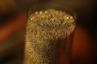

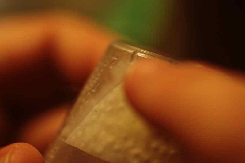

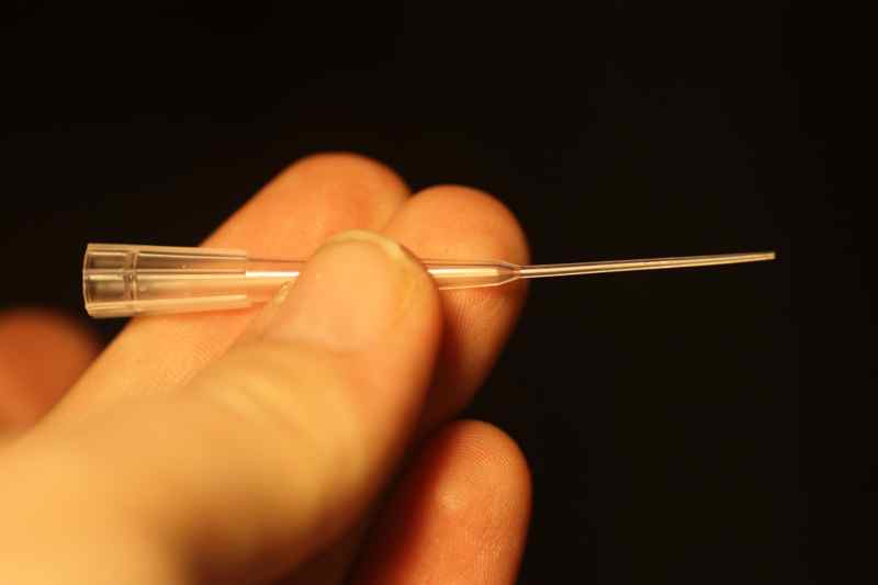

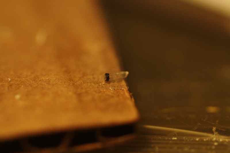

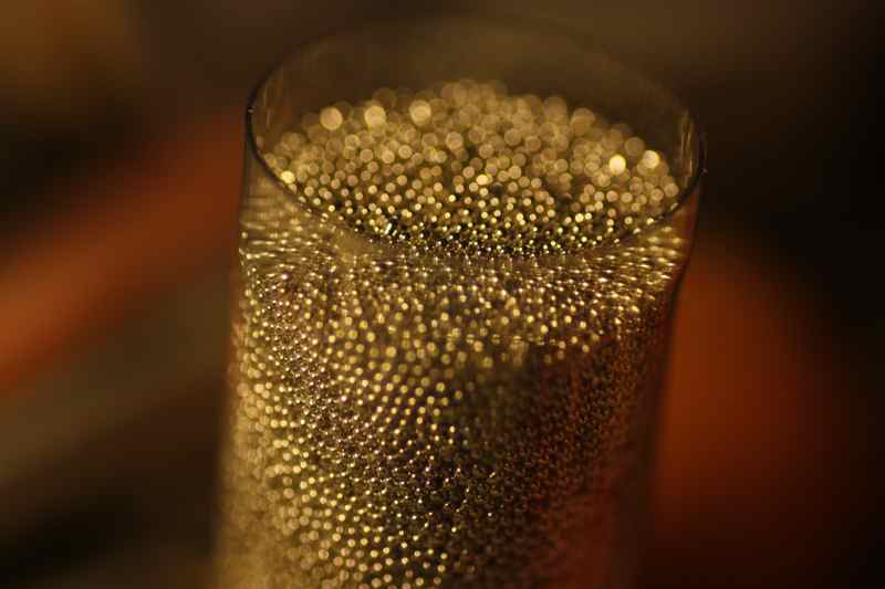

Ok. First of all the scratch cannon effort.

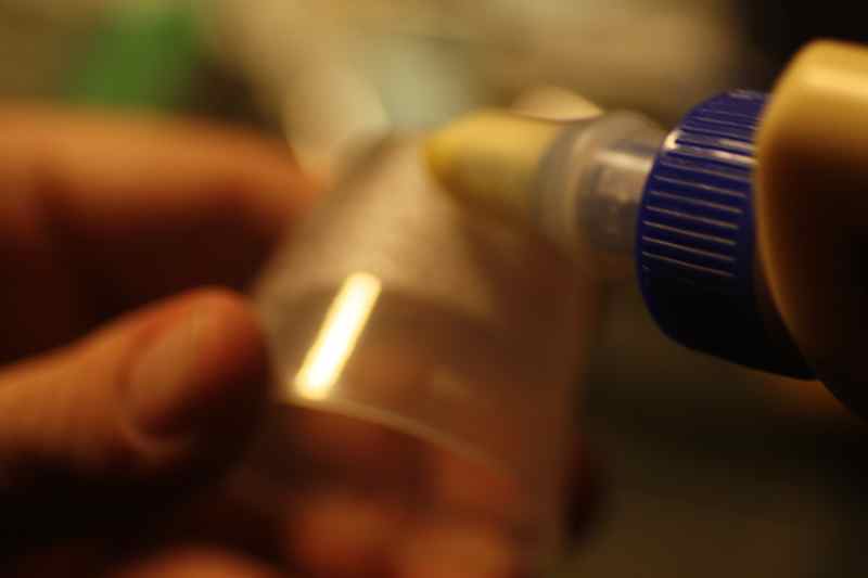

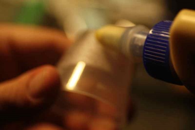

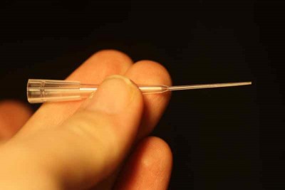

I had these glue tips laying around that I had never done anything with. (I've never had luck with glue tips, my gluing methods don't work that way)
It suddenly occurred to me that the end of these tips (fortunately I bought the 'fine tip' size) are almost exactly the shape I need for a ship board muzzle-loading cannon of the 16th century. Could they be adapted? :huh:

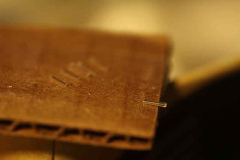

Here are several potential cannon bodies cut and placed on double sided tape for preservation.

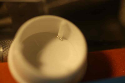

I sometimes haunt the local craft stores looking for strange little do-dads and bits that I can adapt for modeling in one way or another. This occasionally finds me in rather un-manly areas buying things like doll hair (my favorite rigging material, better known as nylon monofilament) or, in this case in the beading area... At our local Michael's store I found an odd package of glass beads that were extremely small, and immediately got to thinking about 1/700th scale cannon balls. This was fortunate, because the package cost around four dollars. Prior to that I had been searching for a source for extremely small spheres which might be adapted as cannon balls in this scale, and hadn't found anything small enough. Nothing seemed suitable, not buckshot or ball bearings or anything. They were all either too large, too expensive, or for some reason unobtainable. I had finally tracked down a company in Southern California that made custom spheres of various sizes for industrial use. They were a little bit skeptical when I told them what my application was. (why is it people are always surprised there are ship modelers out there?) I finally got a quote from them for something like ten balls at the appropriate size (I think I said 0.010 in diameter) for twenty dollars. I thought 'I can do better than that.' Talking with a jeweler friend he had suggested grains of sand and some kind of sifting/sorting equipment. I was just about to attempt this when I went to Michaels to snoop around once more. Needless to say, I was very happy to find these:
Well stocked with lifetime supply of what looked like potential 1/700th scale cannon balls, I set about constructing a cannon ball pyramid, like I had seen illustrations of from time to time in period illustrations. Several things are strange about these little balls. First of all, they seem to be statically charged. (they are made of glass) As I would approach one to nab it with my tweezers, they often would execute an 'escape maneuver' and dodge out of my grasp at the last minute! It made them very difficult to use. Also the smaller ones (they are not uniform in size, or even in shape, some are globular or 'double'� no help) always seemed the most difficult to grasp. However I was eventually able to start constructing a pyramid.
Pessimists see the world as it truly is...
Optimists change the world.
callen
Posts: 998
Joined: Fri Dec 21, 2007 4:10 pm
Re: Scratch Building the Portuguese Carrack in 1/700th Scale
Post by callen »

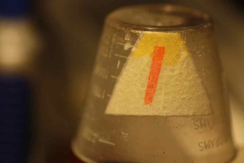

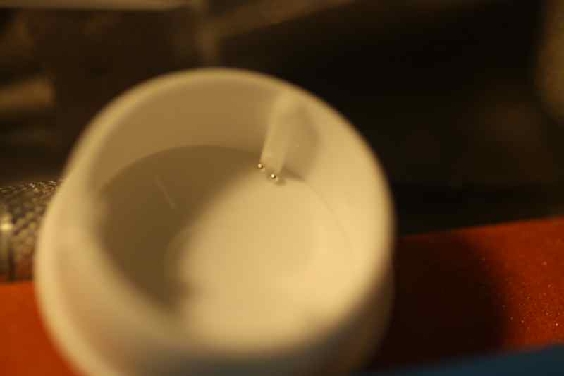

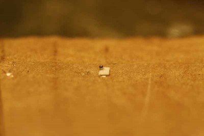

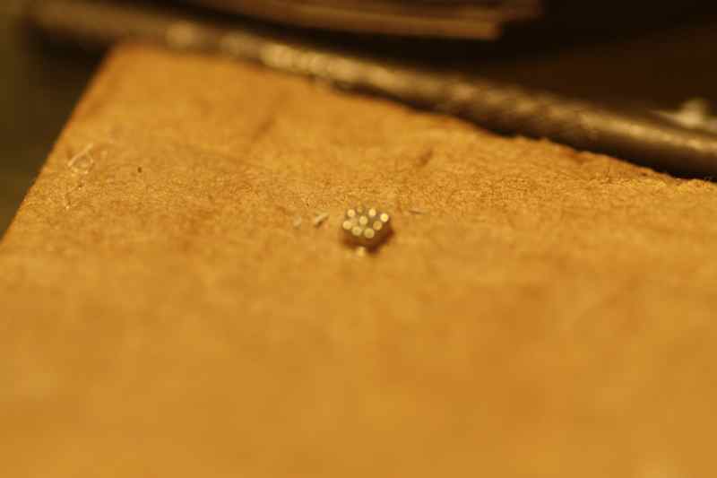

Here is the Pyramid as constructed.
I thought about priming the finished product, but, on a whim decided to paint MM flat black over the balls without priming, just to see what the result would be. It gave them an interesting metallic effect.
The ball pyramid is overscale, particularly with the base which is thick and raises it higher, but since most of this will be at least partially hidden beneath anti-boarding scaffolding, I thought I would let it stand as is. I was kind of proud of it, anyway.

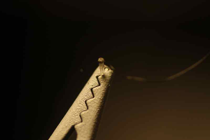

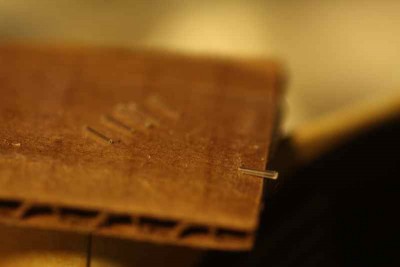

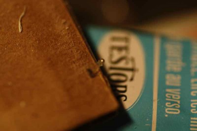

The next step was to attempt to scratch a cannon from the glue tube tip. I thought a few rounds near the muzzle would give it the propper flange typical of cannons of the era, and then a glass bead glued to the other end would help give the shape of the cannon as a whole. In order to accomplish this, I had to fix it to an aligator clip to do the tying of the monofilament,
and the result was that the clip smashed the breech end of the tube, forcing me to shorten it.
The result was something shorter than I had wanted, and, actually I did not remove all of the smashed part, so when I looked close I saw that the cannon was distorted in shape, lacking any visible conic cross section, and generally unsatisfactory...

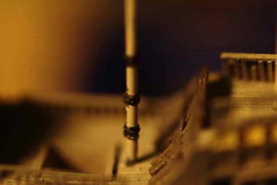

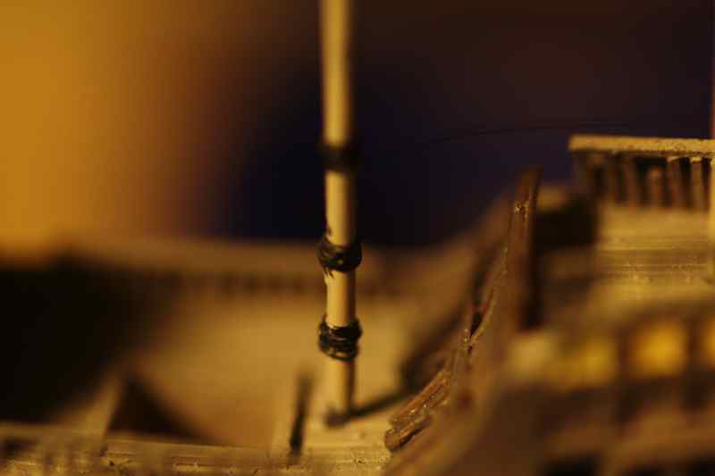

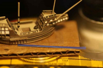

In parallel with the cannon effort I decided to try my hand at making wolding for the masts from nylon monofilament. It worked surprisingly well, though at first it was very difficult. I deliberately started in an area I knew would be mostly obscured in the finished model. As you can see each one was an improvement on the last...

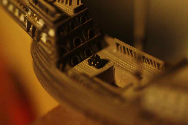

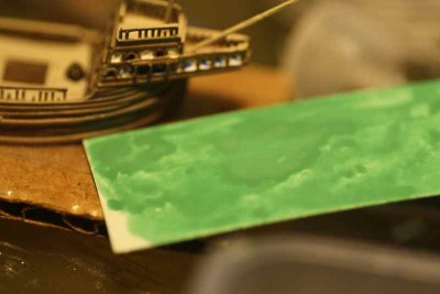

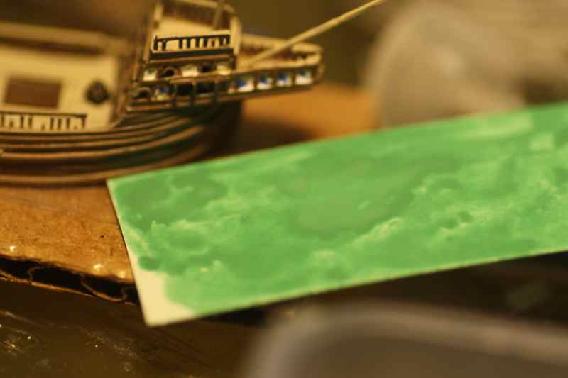

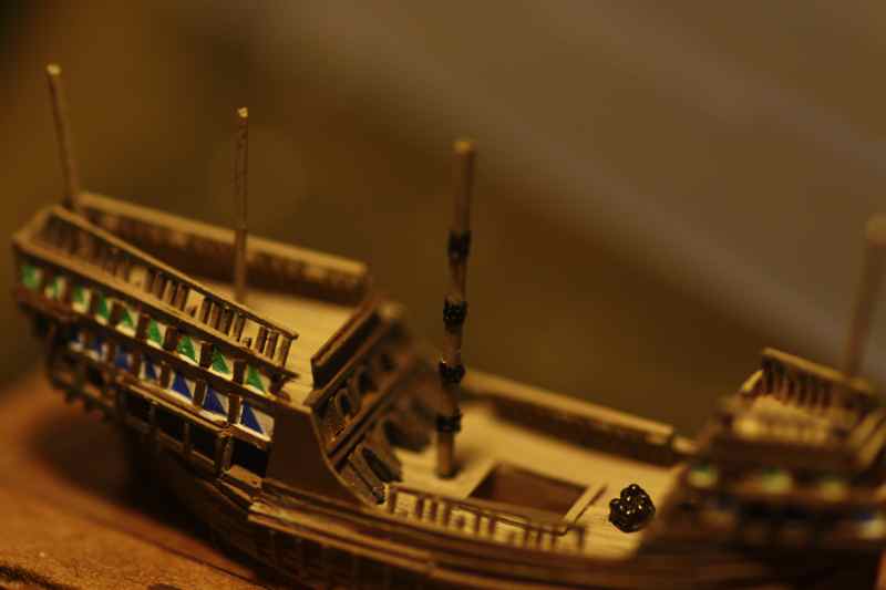

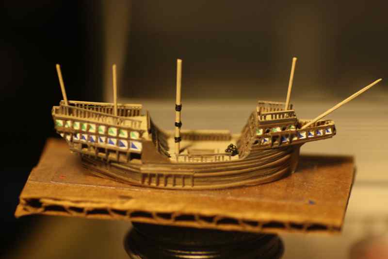

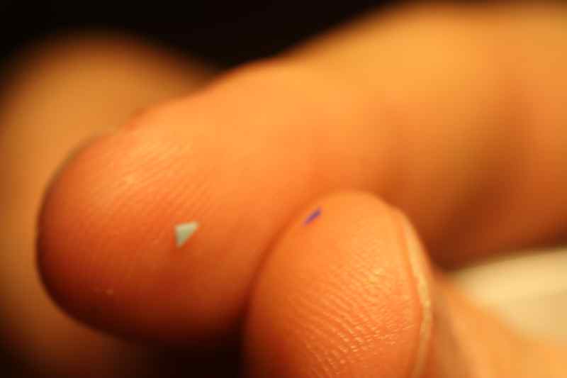

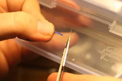

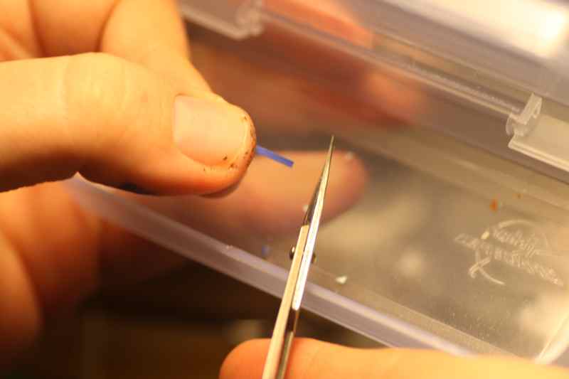

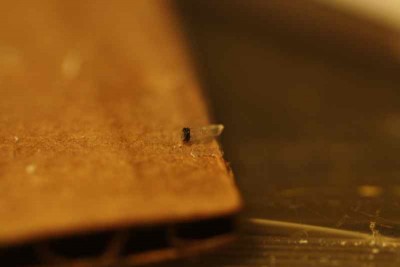

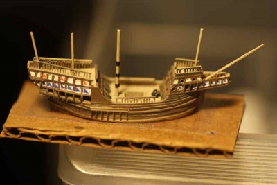

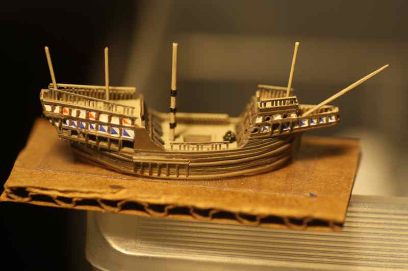

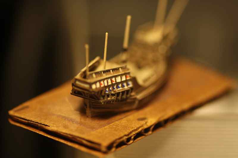

A little disappointed by the cannon effort, I decided to try my hand at some home made decals for hull decoration.
Here's some blank decal sheet.
Which I hand painted MM Cobalt Blue and MM International Orange. Part of the appeal of this subject for me are the colors. I've been painting things gray for the past fifteen years. Carracks are a nice departure in that respect. Now to cut little triangles to fit in the superstructure panels, which I had repainted white (did not like the yellow from the earlier posts)
My wife and daughter have now started to help me document, since I work on my models in the living room while they watch television. That's how we can have the 'no hands' photography on some of these shots. :big_grin:
That Orange is just WRONG! Testors calls it 'International Orange.' I didn't realize they meant 'Safety Orange.' I decided I didn't want my model to look like a 'search and rescue carrack' so I removed the orange and made a decal of Green.
If you'll notice the hand-brushed decal is quite inconsistent in color, but I've found that you don't actually notice the variations when they are cut up. I also feel that slight variations actually add to the realism. I don't try to cut the triangles 'custom' to fit each individual panel (which vary in size,) I simply cut a range of sizes and pick the ones that fit the panels ad hoc. This is much easier and faster.

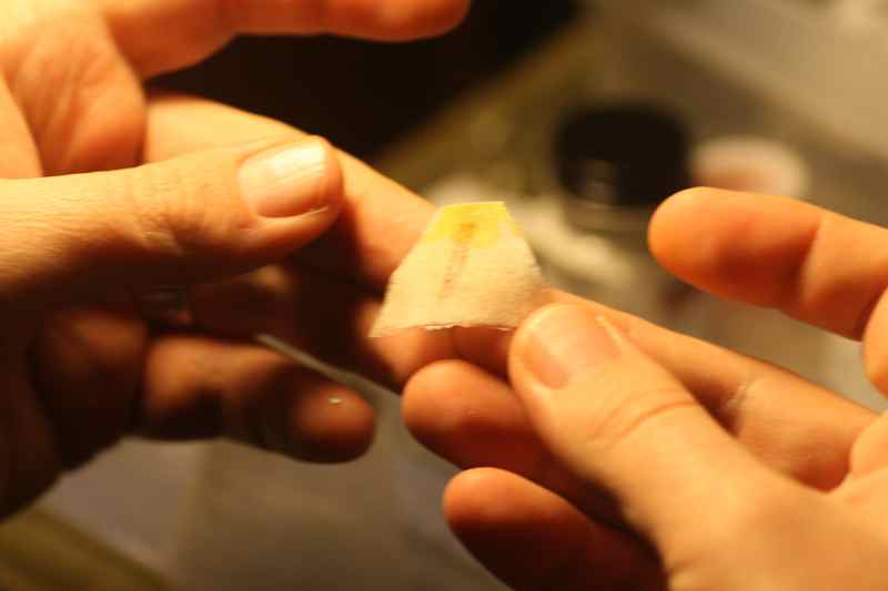

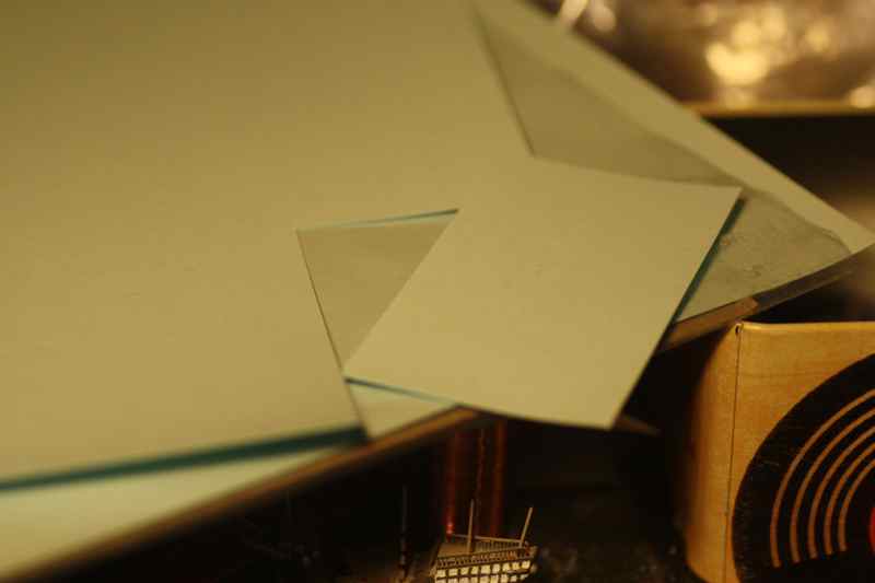

Feeling better about the effort now, I decided to try my hand at sails. This was a big experiment and I'm still looking for a really workable system, but I will show you what I have so far.
How to make 1/700th scale sails? That's the $64 question.
I remember a while ago seeing one of Jim Bauman's builds where he infused CA into paper in order to fabricate parts. This gave me an idea about perhaps using some kind of tissue infused with wood glue to create something workable as a sail.
Many many depictions of ships of the era show these wonderful blossoming sails Here are some examples:
These sails actually seem to be stretching into a 3d shape. Something I have never seen a modeler been able to capture, at least not in this small a scale before. I had the idea to create a sail out of shredded bits of paper, but what I decided to do instead was to try infusing paper towel with titebond wood glue to see if that would create a workable material Here is how it started:

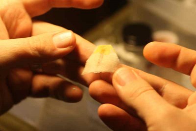

The paper towel seemed just the right consistency. It became very limp when wet, but did not disintegrate. The wood glue gave it a nice cream color and I began to realize I would not have to paint these sails. That got me thinking about decals... So I decided to do a test with some leftover detestable International Orange...
The question was, would it hold together when dry? Would it be impossible to remove from the cup?
Amazingly the wood glue helped it stick to the cup, gave it just the right amount of tackiness without forming a bond. The sail came off nicely in my hand and was undamaged. Since this was just an experiment, I decided to see what I could do with it...
What, for instance would happen if I crumpled it up?
