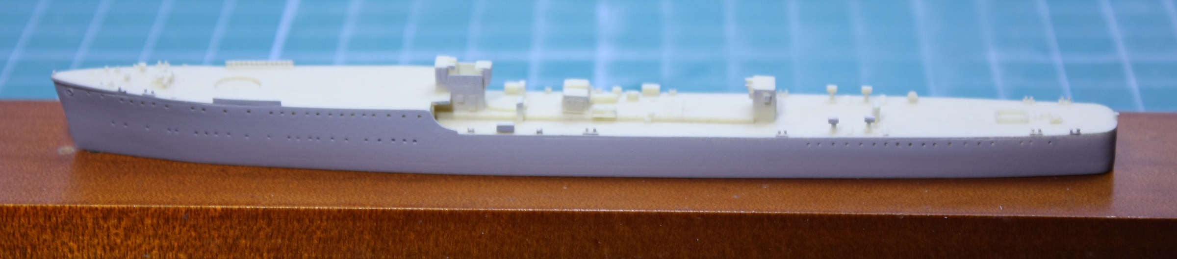

As usually, I started construction of the model with the hull. A plate of styrene was glued to the underside of the waterline hull and sanded flush to compensate for the loss of freeboard when the ship will be recessed in the seascape. Without the artificial sea the ship is riding unusually high only to be rectified when the diorama is completed.

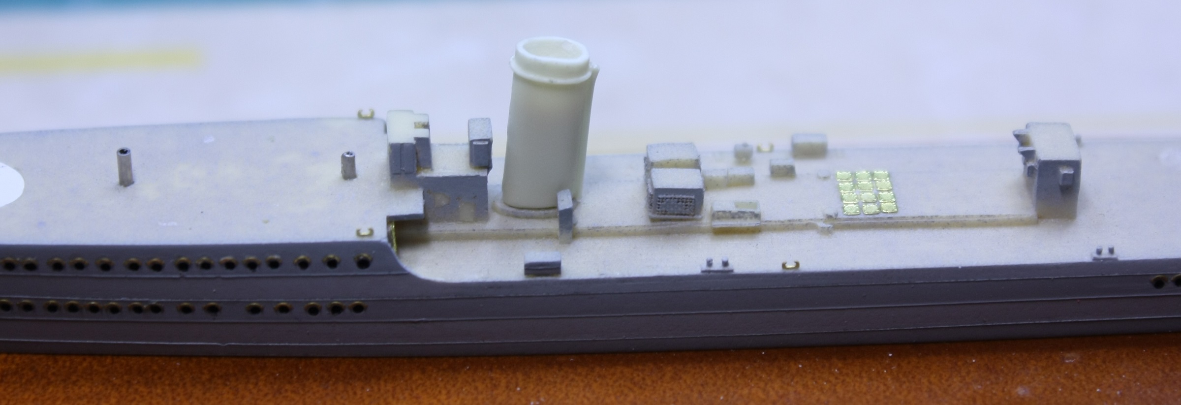

I deemed the two rows of portholes too high and not in a straight line, therefore filled them with putty and drilled another two rows directly under the original ones.
To my surprise I could not make them line up perfectly despite great care when drilling. With hindsight I should have left the portholes alone – the new ones seem somewhat to low to my eye.

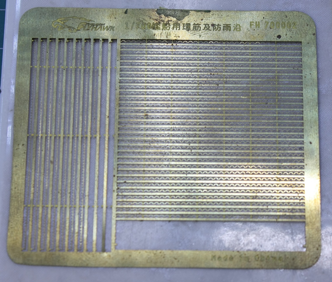

I attached PE rigols from Flyhawk
with varnish over the portholes and tried to ameliorate the irregularities in the line portholes by positioning the rigols in a really straight line.
Primer was sprayed on the hull after applying strips of Tamiya masking tape to simulate strakes.
Fittings to be replaced, like depth charge throwers and small cordage reels were cut from the upper and forecastle deck, and some PE details: small fairleads, doors and engine room vent covers attached. I glued small strips of stretched sprue around the ground tackle to simulate raised deck lines.
The major superstructure components as well as the funnels will be secured to the deck by lengths of steel tube glued into the latter which in holes drilled into the former. With these tubes in place I could move on to provide additional detail to superstructure parts.

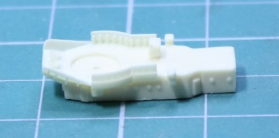

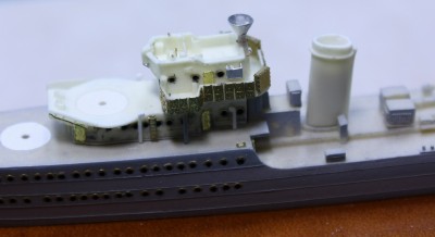

The forward superstructure is the largest structure on deck.
I glued the shelter deck and the bridge together and filled the seam. The ready-use 4.7 in shells were simulated by little bars against a low bulwark – not a bad effort, but railing must go between the two, so I cut them off (here and at every other location where it was present). The flange at the perimeter of the open bridge, acting as a wind deflector was thinned down considerably. A pair of little galleries, protruding from the bridge sides were fabricated from sheet aluminium. The same material was used to form a cone at the base of the rangefinder. Vents were fashioned out of styrene rod. Portholes were drilled out, 0,2 mm thick stainless steel bridge wing supports, PE doors, splinter mattresses, signal flag lockers, ladders, grab rails, windscreen and ship’s wheel were fitted.

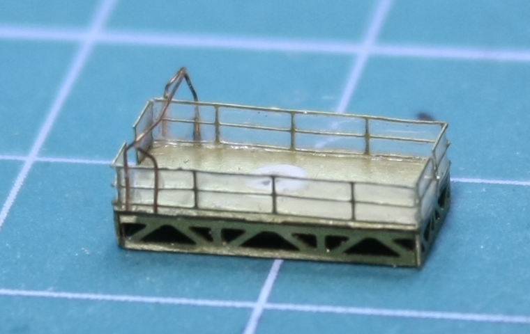

The 3 in AA platform was constructed entirely out of PE and its railing as well as that of the searchlight platform was provided with canvas dodgers made out of white glue.

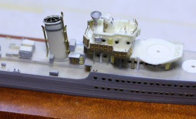

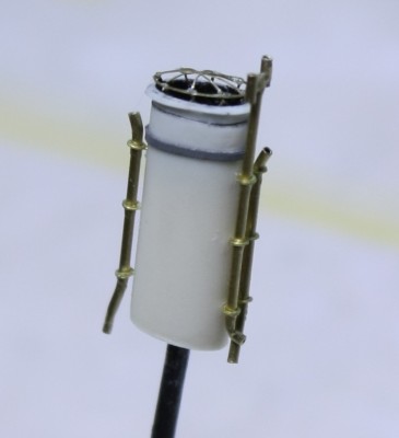

The funnels had their openings drilled out,
received multi-part PE grilles (the construction of one is shown in the pictures)
Steam pipes were constructed from Albion Alloys Brass tube and were attached to the respective funnels by PE rings with their tiny lugs glued into pre-drilled holes.
