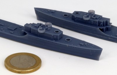

The history of my Bagley-class research and build(s) is closely related to the one of Benham-class� USS Wilson. After dismissing the Midship kit as the starting point we had some initial discussions with Justin (Red Devil Designs) and then the actual work started with Matt (Kraken Hobbies), who created the first 3D attempts on Bagley already in 2021 and provided me at first with a test set of his Midships upgrade kit that was expanded to two full 3D printed models incl. waterline hulls - just this week.

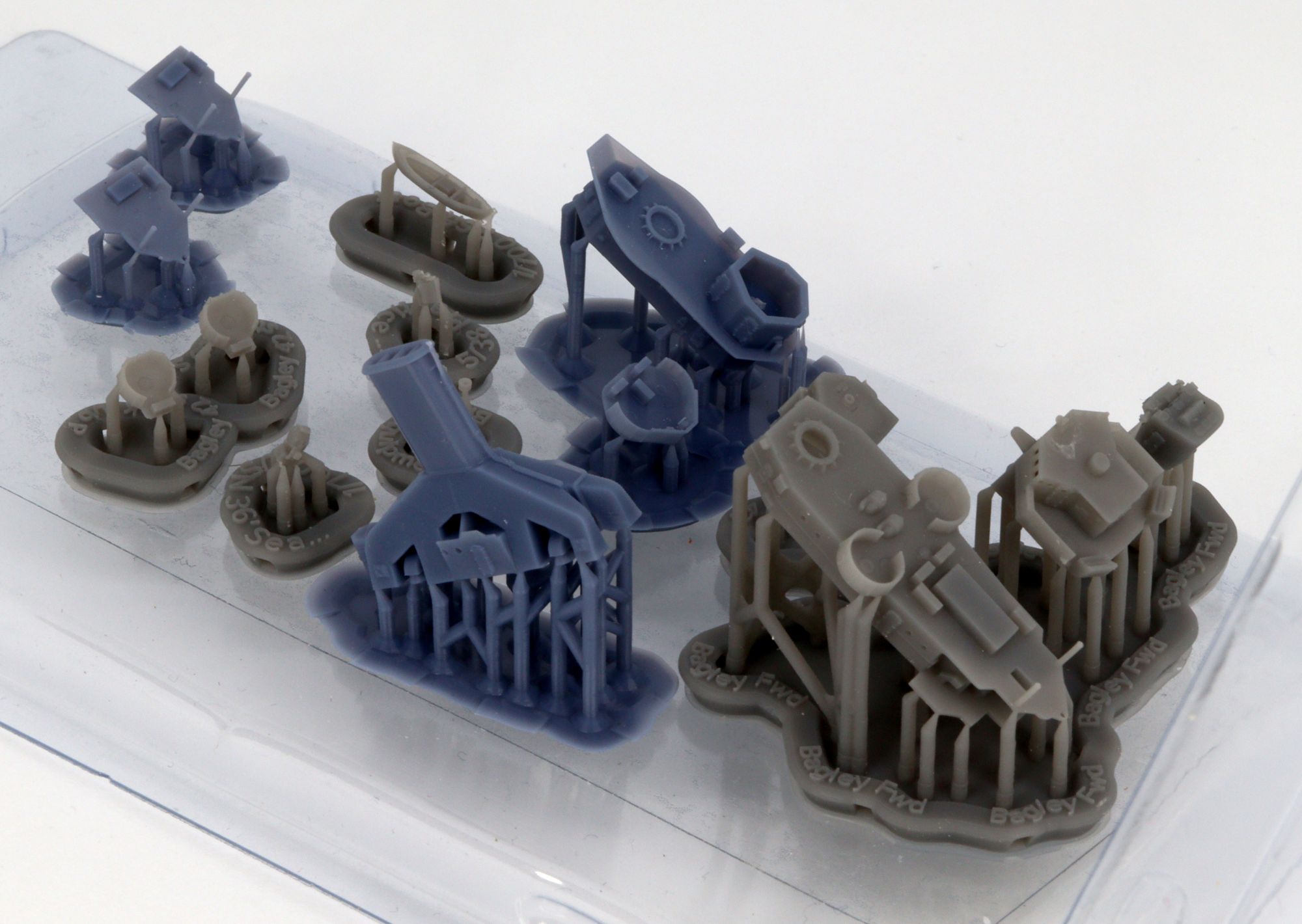

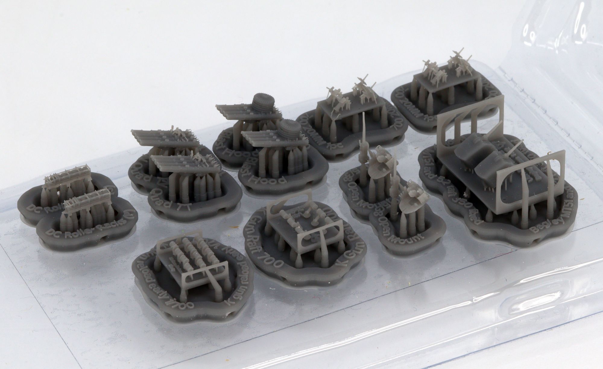

This is how the 3D parts look like (I�m not showing complete sets for two ships here). The grey-coloured parts come from Matt�s older printer and the darker/blue-grey ones from the new 8k printer. Interestingly, the print layers seem to be more apparent on blue-grey parts, especially under LED light. Perhaps it�s because their vertical sides are so shiny. But details are definitely much sharper and crisper on those blue-grey parts.

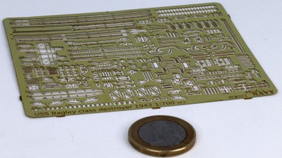

In the meantime, I prepared the design for a complementing PE set and had a prototype etched. After testing the fit an updated version of the PE sheet will be prepared and it is planned to become available at Kraken Hobbies in the not so far future. The sheet should include all necessary PE parts for all class members in 1942 incl. measured railings and radar variants.

One can never have "too many" projects! :heh:
Those parts look really good. Looking forward to seeing you work your magic on them.

:woo_hoo:
Your photography shows the details splendidly.
Looking forward to seeing them come together!

Vladi, the 3D-printed kit looks incredibly well made. The gun pits bulwarks are thin and crisp and the 3D printed weapons seem amazingly detailed. The AA's and the depth charges racks/launchers look fabulous. If you add the ad-hoc designed PE's all the elements for a most successful build are complete. Am sure there will be (small) space for some old fashioned scratchbuilding too, there's always room for that :big_grin: .Am looking forward to see the WIP pics soon. Have a great start!

There�s actually not too much to write and show about this build as it relies on our research that already went into the 3D and PE parts. As far as 3D parts are concerned, I added nuts for attachment to construction base / seabase to the bottom of the hull (there is a rather funny story related to that which I�d share later). I am currently about half-way through the PE sheet as can be seen below. Some corrections are being made to the PE design based on the actual experience and some previously omitted parts are being added.
I�ve been deciding whether a) to put most of the remaining PE in place first, then airbrush 5-N overall and then add 20-B to the deck by hand - or b) to spray the deck 20-B at this stage (all superstructures were still dry fit), then mask it and spray with 5-N, the remaining PE to be added at the end. I decided for the first option, the PE will also be better visible in photos for the instructions this way.

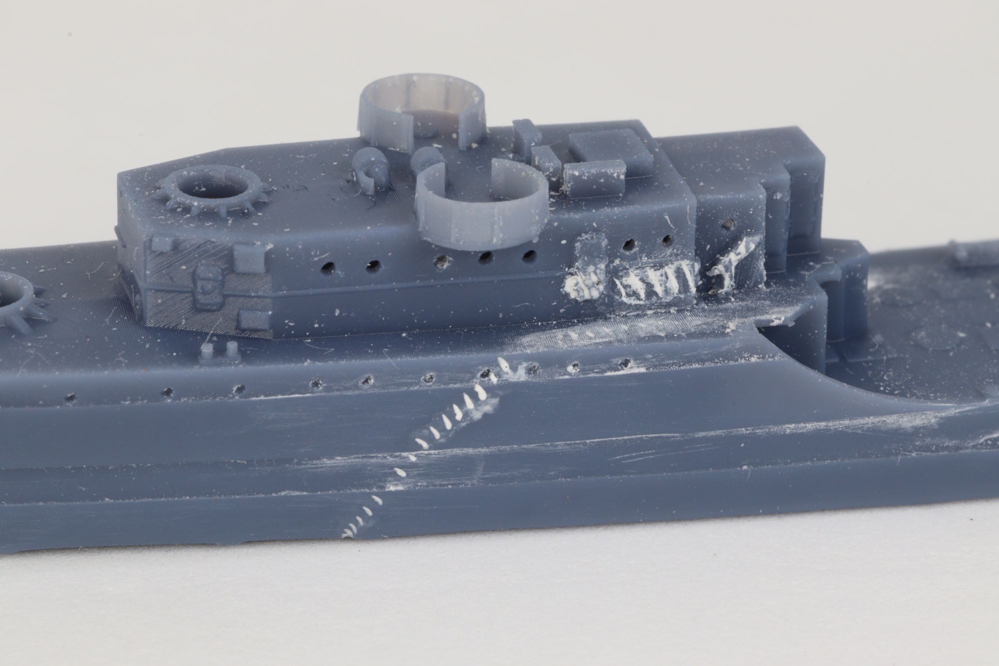

Ever heard the story of the jumping submarine off Guadalcanal?
While on a night watch, USS Bagley was physically ambushed by a IJN submarine. The vessel breached the waves, jumped nearly a hundred feet into the air while furiously scratching the port side of the destroyer�s hull with its rapidly rotating propeller. Still in midair, the submarine flipped over the forecastle and fell back to the sea, missing the destroyer but leaving another scar on Bagley�s starboard side amidships. It all happened so quickly that only one watchman saw it, but no one believed him as he had to drink his preserved rum rations to relieve the enormous stress and fear. It�s only now, over 80 years later, when the previously classified photos of the damage were released.
In fact (and not because of this mishap while attaching nuts to the bottom of her hull for attachment to construction base / seabase), I decided to put the USS Bagley part of this dual build on hold for this very moment in order to complete testing the PE parts ASAP so that I could hand them over to Matt for production. But Bagley is definitely on my list, so I�ll be back on her one day.

Clearly propellor damage indeed... ;)
:big_grin: "..the prompt intervention of the onboard repairing teams hid the damage to the enemy, historians and researchers" :big_grin: :big_grin:

Indeed, an international conspiracy, never revealed even by Japanese survivors... :cool_1:
I always wondered why there were so few photos of Bagley at the time of the Guadalcanal invasion! :smallsmile:

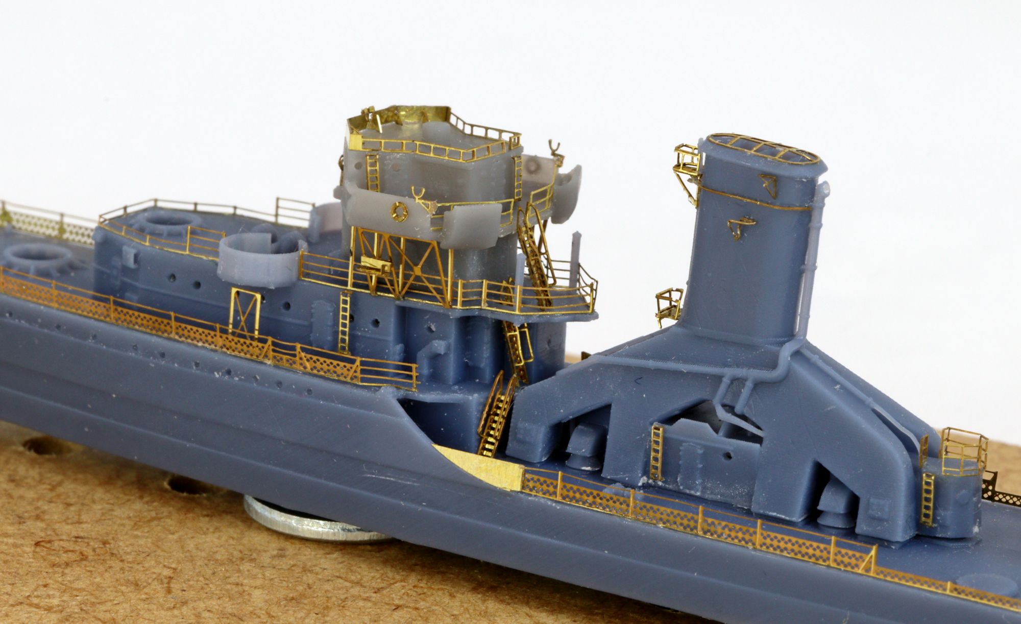

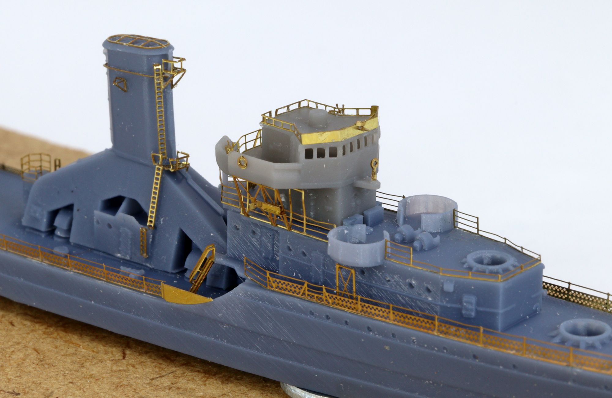

Yeah, very interesting what information surfaces even after over 80 years, right? :heh:

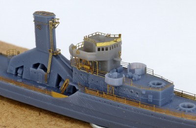

Completed testing the PE fit of Patterson today: all the torpedo handling equipment as well as life raft racks, ladders (except access to the navigating bridge, as it is still dry fit for easier painting), hose reels etc. are in place. Also all the tiny specks on the mainmast. Radar antennae and TBS are ready but not attached to the model as these will be sprayed silverish grey.
She lacks her two Lewis machine guns atop the searchlight tower as of yet, we noticed them too late for the prototype PE. They will be part of the final PE sheet along with some adjusted and other newly added parts, e.g. rudder for the whale boat.
Now I need to prepare the updated PE for production and create some instructions.
