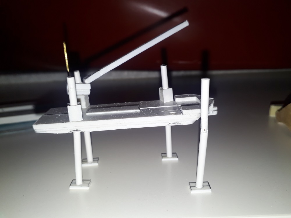

I haven't done much actual work on it, but I did some testing. I built a small prototype/mock up of the vessel, testing some engineering solutions to get it in the bottle. I also did cut the bottom off a wine bottle for testing. The latter wasn't such a smart idea, since the actual bottle was a coffee liquor bottle, with a shorter neck and steeper curve. The wine bottle gave some head-aches, while a short trial in the actual bottle made life a lot easier.
Basic concept is to make a sea floor of acrylic-sand mixture which I've been using for the dredging vessels in the past.
Then mount the vessel in jacked-up condition on top (and glue it to the sand to avoid it shifting and/or floating later on)
Pour a transparent blue epoxy layer for the water, so you should be able to see the feet standing on the bottom.

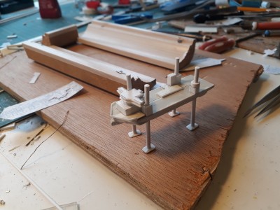

Technical solutions for getting it in the bottle, are hinged legs, with the hull sliding over the hinges as a sleeve to straighten them out inside the bottle.
The hull will also be split in 2 parts longitudinally to fit through the bottleneck. So I'll need assemble the parts inside the bottle (hence the testing inside the wine bottle). Additionally I wanted to have the crane in a higher position, not parked on top of the bridge, so I'll be adding the crane (around the portside aft leg, when the hull is inside the bottle). And last but not least, the accomodation, with a helo platform that sticks out even more, will have to go in separately and be turned 90° inside the bottle to be mounted on the hull.
Some of the seams I will (try to) hide under deck equipment, others will probably remain as they are, pre-assembly out of the bottle will need to minimize the visibility of those seams.
For the split I've decided to split it with angled parts forward and aft, so it's self centering, additionally I'll be mounting 2 pins to make it fit.
Glenn warned in one of his logs that drying something inside a bottle is awfully slow, since you don't any air flow. For the time being I'm purging my bottle from time to time with air from my air brush compressor. This replaced the humid air inside the bottle with fresh drier air and least speeds up drying a bit. The condensed moisture which accumulates at the top of the bottle also disappears when I start this process, so it seems to work...
File comment: Hinged legs to pass through the bottleneck

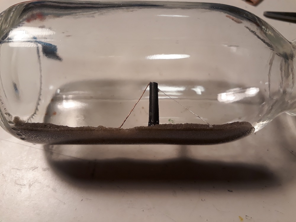

File comment: Mock-up inside the wine bottle

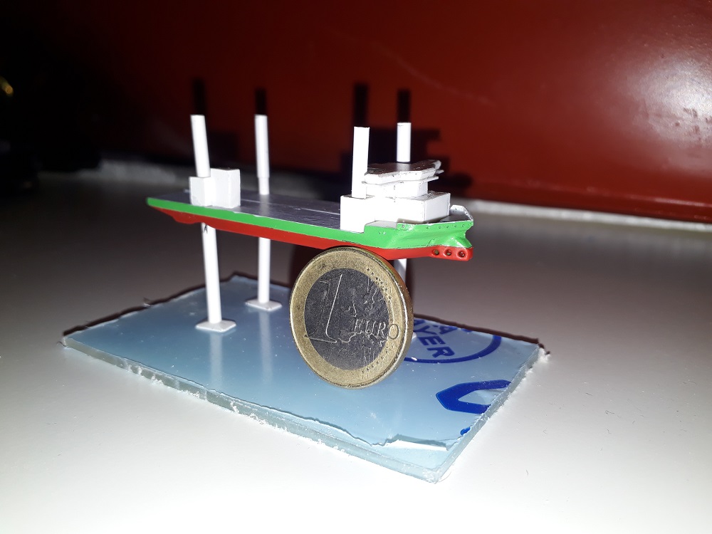

File comment: The actual thing.

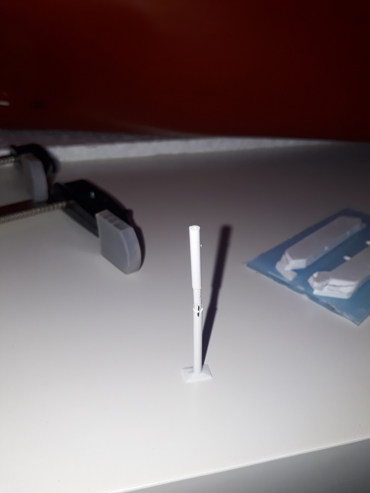

The original design of the legs that I had in mind was simply a hinged one. I would then drill a hole and add a small pin above the deck level, which would prevent the leg from falling down during bottling and it would also act as a mechanical stop when the ship was pulled down over the hinges inside the bottle.
The pin would have a very minimal clearance since it would be inside the leg casings standing on deck. You can see the leg casings dry fitted on deck for a dimensional check here. I will eventually use those casings on the final hull.
File comment: Old leg design with the prototype
I now made a new leg design by turning part of the leg to a smaller diameter and drilling the same diameter hole in the hull. This automatically prevents the legs from falling out and also creates a mechanical safety for dropping down inside the bottle, as the smaller hole would sit on the larger diameter part of the leg just below the hinge. When slid up, the smaller diameter will not be visible, since it would sit inside those leg casings on deck.
File comment: New leg design with reduced diameter near the hinge.

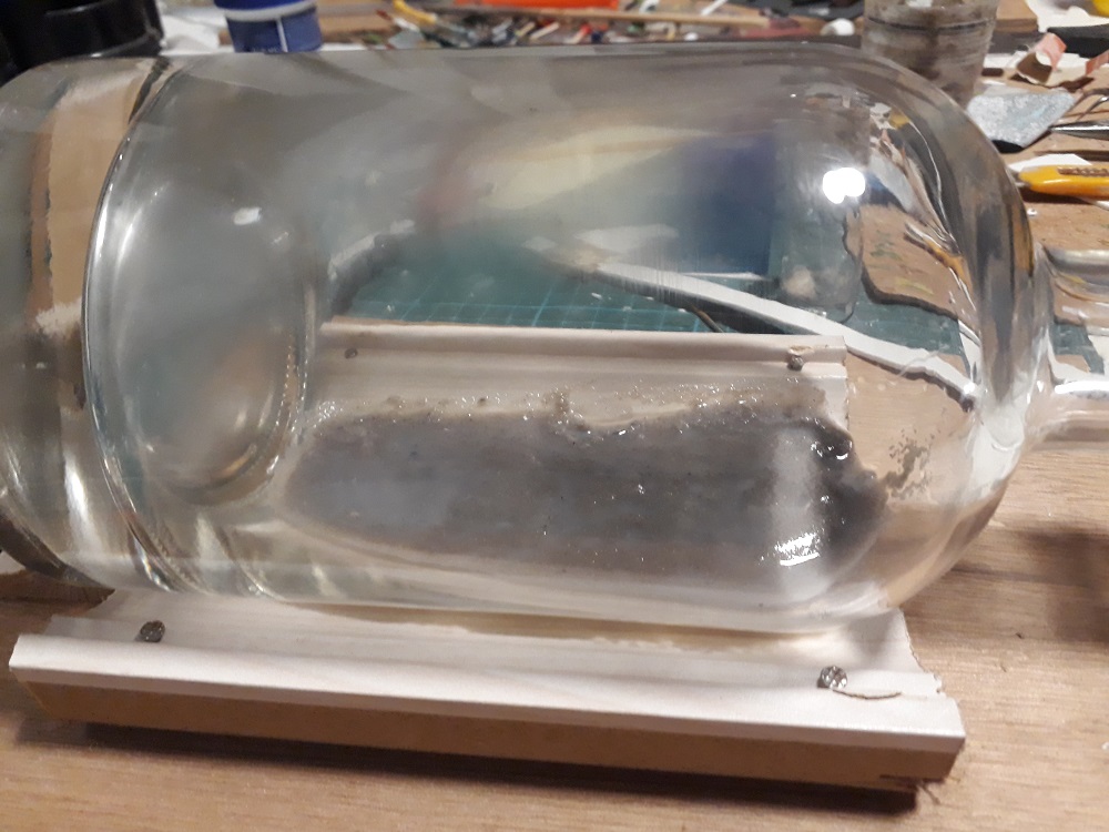

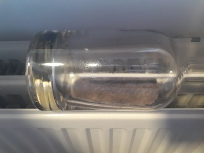

Some more progress, I'm sort of curious about this, which drives me to continue. Unfortunately a model like this may be perfect outside the bottle (which this one will not be :heh: ), but may completely fail when being bottled (glue dried before I can mount the pieces together, melting by the epoxy etc.
I therefore decided to add another tiny syrup bottle to my testing stuff. I also added a layer of acrylic sand to the bottom and will be mounted a piece of styrene inside (glued to the sand with acrylic gel), I'll then pour epoxy inside as a test to see if the sand doesn't create too many bubbles, or if the styrene rod would bend or whatever can go wrong with this mix of parts and liquids.
I've added more sand to the bottle, here a picture of the method for drying it. I put the bottle on the heater, then insert a small styrene rod and put the hose of the airbrush compressor to that hose. This way the dry air gets inserted in the back of the bottle and the moist air can escape through the neck around that styrene rod. I do this until all droplets are gone from the bottle surface. Then I repeat when new drops start forming.
The hull joint remains somewhat of a head-ache, certainly the bow gave some issues as you can see here. Eventually I resorted to putting petroleum jelly on one side of the hull and then added milliput on the other side and pushed the parts together. Afterwards, since the milliput wouldn't stick on the petroleum jelly part, I could remove that half and have a good fit.

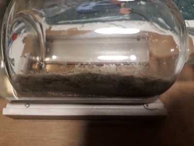

As promised here is some of the tooling and testing I'm doing.
This is the test bottle I mentioned before. I now simply put a small piece of styrene rod inside, to see whether it'll take the heat of the epoxy and also to see how it will look with the distortion of the bottle and the epoxy. This piece is slightly conical in shape as I intended to use it as a monopile in this project. It appeared however too short. So yes, the idea still is to put a monopile next to the vessel. Her deck load will consist of Transition Pieces, yellow conical shapes with a platform that are normally put on top of a monopile and which will then support the wind mill itself.
I also added different diameter wires to see what it will look like for future reference (yes, a potential next project is already growing in my mind).

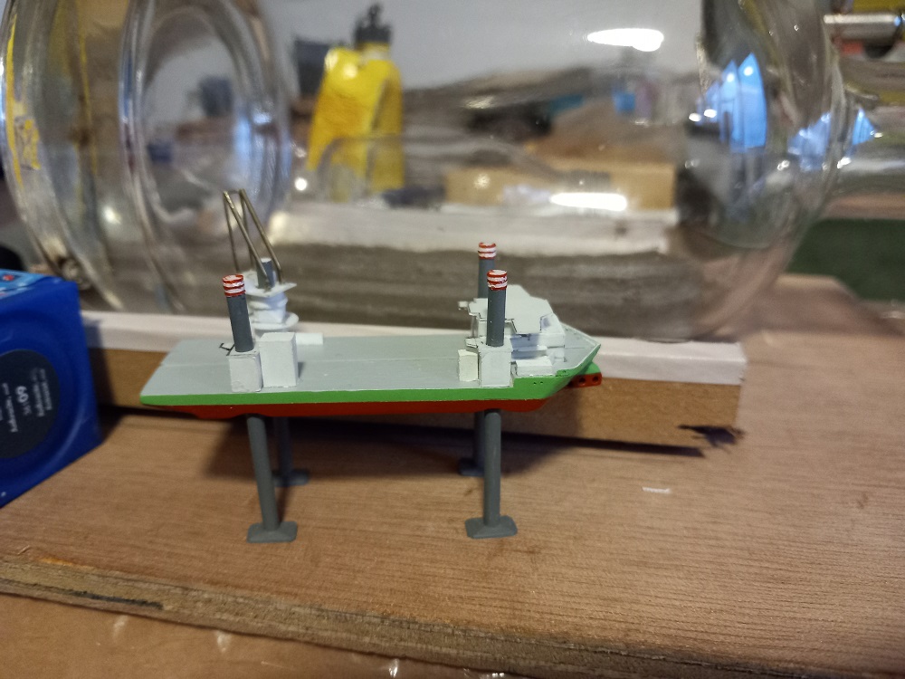

And the vessel as she more or less is now (and yes I'm aware the paint needs some touch up and the legs are crooked, that's why the top deck of those leg casings is coming last, I use them to straighten out the top part of the legs):

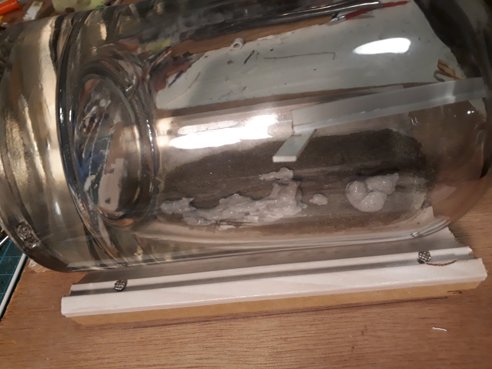

As you could see in previous post, that practice bottle looked rather crisp on the bottom, unfortunately the real bottle didn't. During my first filling with sand, I had the idea that a more liquid mixture would create a very flat bottom. I therefore made my mixture way too liquid by adding too much water (which eventually floated above the settled sand. However during that first filling, I made some errors in moving the bottle, which meant the water swooshed around a bit. The water wasn't pure of course, it was mixed with acrylic, and this left some nasty smudges which I can't seem to be able to remove as easily as pure acryclic would be.
I therefore decided to add more sand, with a much heavier consistency (much like the small practice bottle), to cover those smudges.
File comment: Smudges
Here you see the fresh mixture, with a rather heavy consistency due to more acrylic, less water and more sand. You also see how I insert the T-shaped tool to shape the sand mixture, from the middle to the end of the bottle I can use it flat, more towards the neck, I need to turn it and flatten the surface with the small extension.

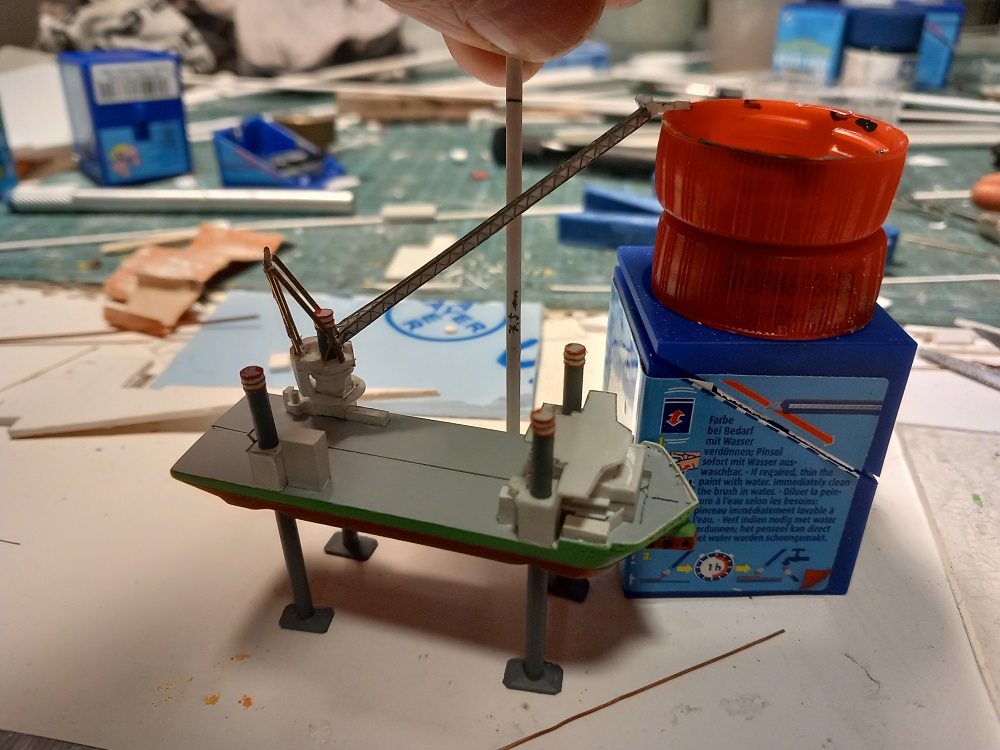

As mentioned I concentrated on the crane. I was of course aware before I started the build that without PE the crane wouldn't be perfect. However it also needed to be sturdy since I still need to manipulate it inside the bottle, using long tweezers. The solution was to make it rather solid. If injection molded companies are allowed to make big blobs of plastic for crane's than I'm definately allowed to do that as well.
It was quite a tedious job and far from perfect, but it'll do the job. The corners were made of 0.3mm steel wire, while the lattice in between is made of 0.1mm copper wire, it's easy to cut at length since it's quite soft and I used a jig to get them more or less equal in length.
The jib was then mounted on the crane base using my small measuring device from the bottle in previous post. Since I'll be mounting the crane with the hull sitting down it should give enough headroom to tumble that crane over the aft leg. I do believe the top of the crane will come quite close to the top of the bottle...

The reason I chose the Sea Installer was because of its odd length-width-height ratio, the raised crane being an additional plus (not even part of my original idea, as the legs would have been challenging enough).
I guess any modern crane vessel would be suitable, as long as you raise that crane high enough to make it fill the bottle properly.
With this build I went from idea to start of construction within 1 week, which is not what I normally do. However I've decided to live with some of its errors and learn the lessons I've learned from them. At this point I'm still happy I'm trying this, although the bottling process is something I'm somewhat afraid of.
During tests, I've always put one part of the hull sideways and push the other part on it that way. That way you can push, using only one hand/tweezer. She can't really sit upright, since both parts have the legs sticking out at the bottom, so you can't squeeze them together. However, adding all the detail on the sides now, and with the sandy bottom in the bottle, I'm hoping I don't break anything when doing this.
I'm nearing completion now, working on the helo deck. We'll soon find out how this will go :woo_hoo: :heh:
Once/if/when she is in the bottle, I'll start doing a lot of testing for additional features:
