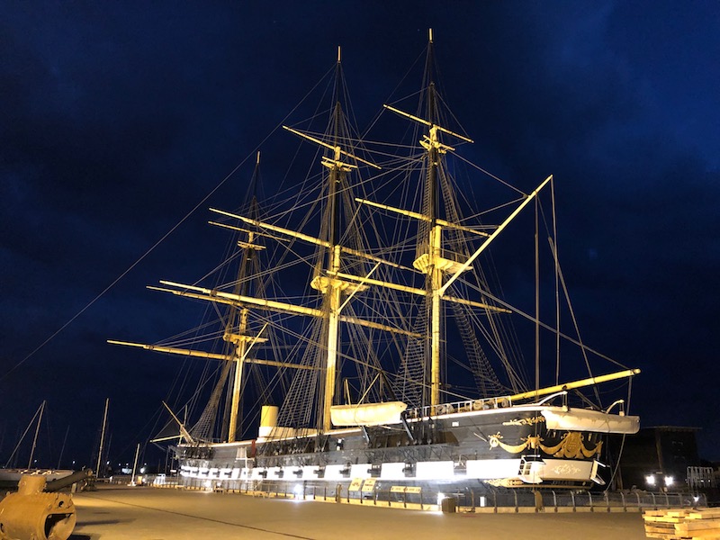

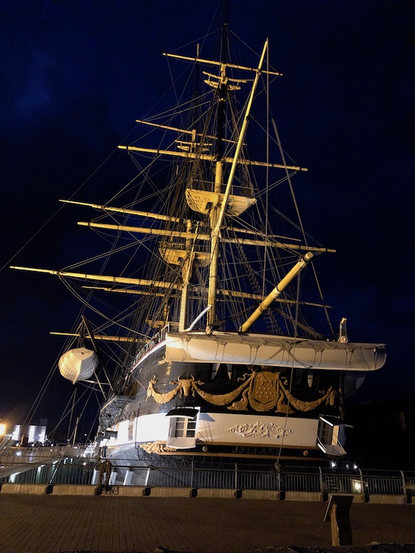

Small sign of life from Denmark: Frigate Jylland :-)
