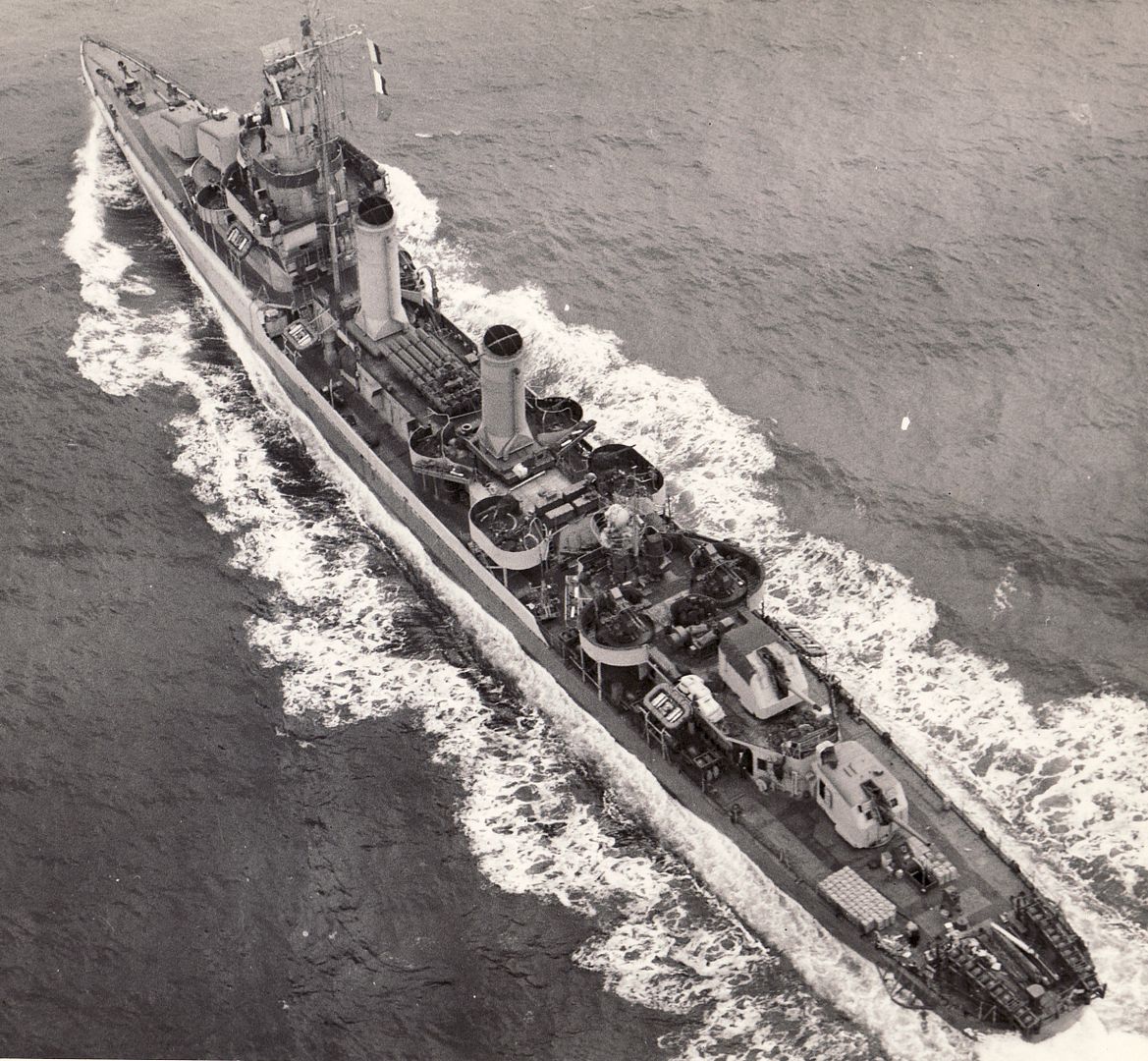

Fred only built models of the SIMS class units involved with the Battle of Santa Cruz, October 1942.
As for configurations of USS MUSTIN (DD-413) with four twin 40-mm mounts. See attached.
USS WAINWRIGHT (DD-419) had two twin 40-mm mounts and THREE single 40-mm, not five single 40-mm mounts, installed on a platform where her aft torpedo tubes mount was located from July 1944 to late in 1944 for operations in the MED. In late 1944, the temporary single 40-mm mounts were removed and her aft torpedo tubes were returned. When initially installed with the three single 40-mm mounts, WAINWRIGHT was painted in Ms 22 camouflage. Later she was painted in dazzle. See attached.

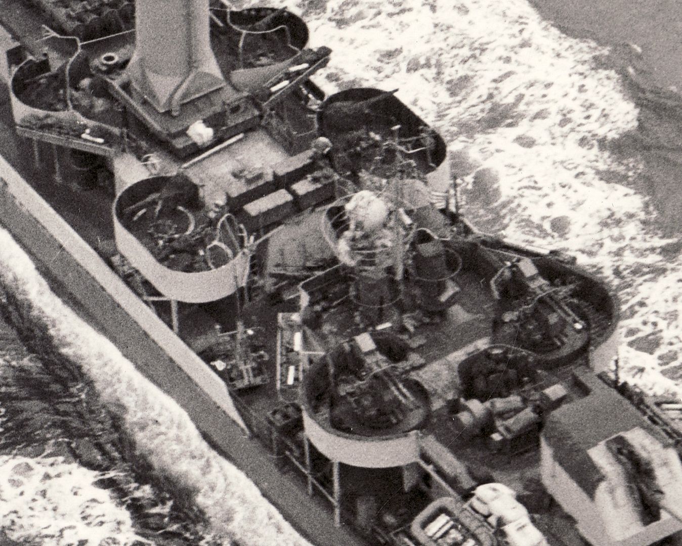

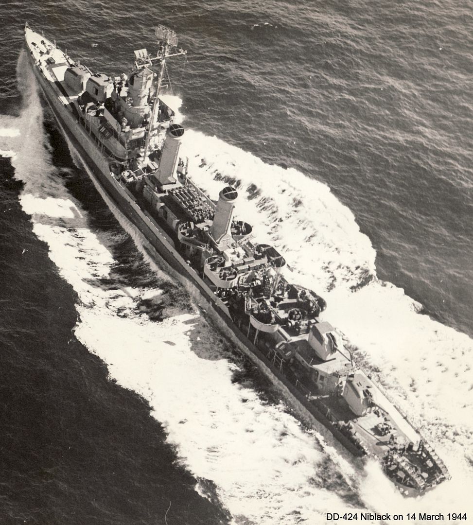

Interesting with single 40mm mounts in the 3rd pic both P/S,
And center. They're also there in the second picture. I never knew the USN used 40MM singles on ships. Between that and the great looking dazzle scheme I'm starting to want to build this one...

Might this AUG1945 Mustin configuration - Mk 25 radar antenna, four twin 40s, and no torpedo tubes - complete the Sims class evolution?
Is Wainwright's arrangement of a pair of twin 40s on the after deckhouse and three single 40s replacing a torpedo tube mount amidships one-of-a-kind?

Yes the USS MUSTIN August 1945, Anti-Kamikaze configuration was the last one for the SIMS class. As it was, MUSTIN was the only member of her class to actually receive the mod. The SIMS class survivors were part of the "now obsolete" pre-WWII built destroyers declared surplus at the end of WWII and were disposed of. So no other surviving units (five units out of the class of 12, were lost during WWII) were given any upgrades post-WWII when the sisters to MUSTIN returned to stateside.
Yes USS WAINWRIGHT with three single 40-mm guns was a "one-only" conversion. When the German Air Force made a determined effort in early 1944 to attack the allied fleets off Italy and around the MED, the "temporary" addition of more AA guns was authorized on a DesDiv basis for such units assigned to operate in the MED. Destroyer Divisions 13, 14, 21, and 25 were so authorized as were many DE's. All of these were early BENSON-GLEAVES units except for USS WAINWRIGHT, the DesDiv Flag for DesDiv 25, making her the solo SIMS class unit authorized with this upgrade.
On the BENSON-GLEAVES class units, a temporary platform for four additional 20-mm guns replaced the aft torpedo tubes bank. An additional and separate mod authorized a pair of singe 40-mm mounts added on the main deck aft of the temporary platform and ahead of the two twin 40-mm mounts. In total at least 15 BENSON-GLEAVES class units received the platform for four 20-mm guns and at least 13 units also had the two single 40-mm mounts. The augmented armament was installed at either NYNY or by USS VULCAN (AR-5) at Oran. Few photos exist of these units so armed and verification of some units listed in Armament Summaries can't be verified with a photo(s), particularly for the difficult to see single 40-mm mounts, only via textual records.
The best set of images I have come across, are of USS NIBLACK (DD-424). A series of 14 March 1944, aerial views shows her after the temporary platform for four 20-mm guns was added. See first image. Then another series of photos taken on 9 April 1944, shows that the two single 40-mm mounts have been added, requiring the relocation of two K-Guns further aft. See second image and third close-crop image from the same photo.
