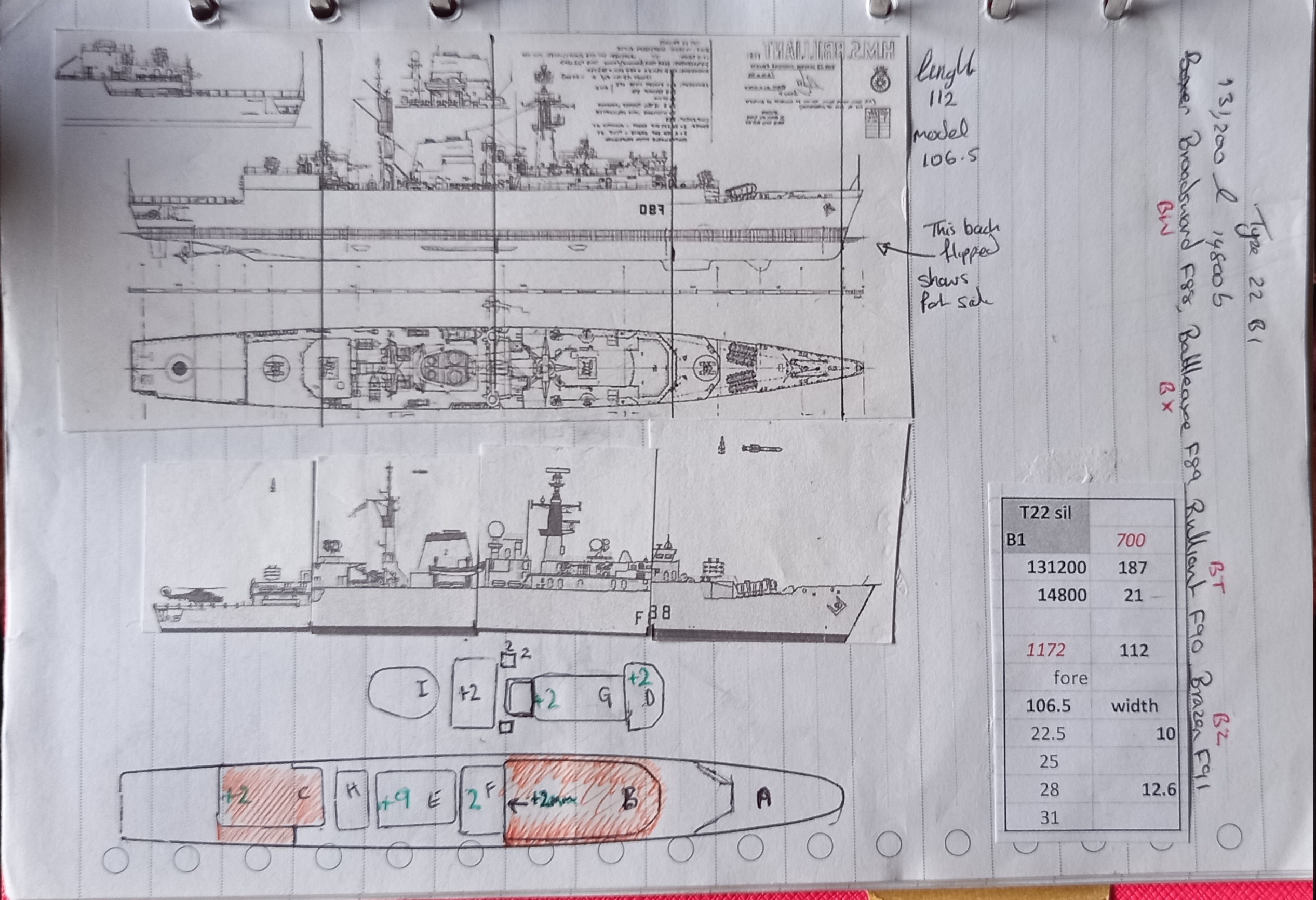

My kind of plan.

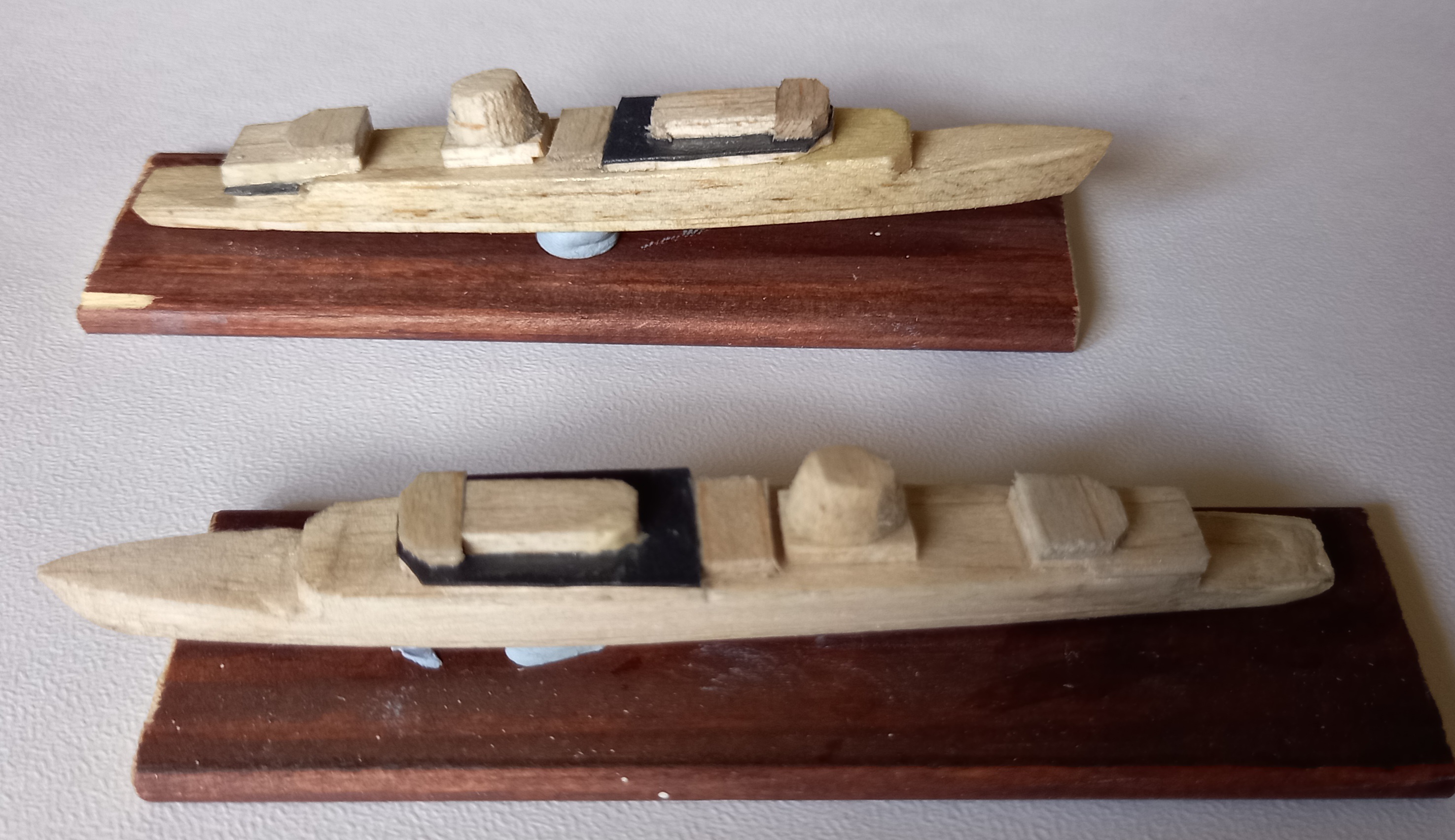

A Cut out shape of hull with side and deck angles done by knife and then slow fine sandpaper. As Balsa wood so soft I coat in “Ronseal” Wet Rot Wood Hardener.

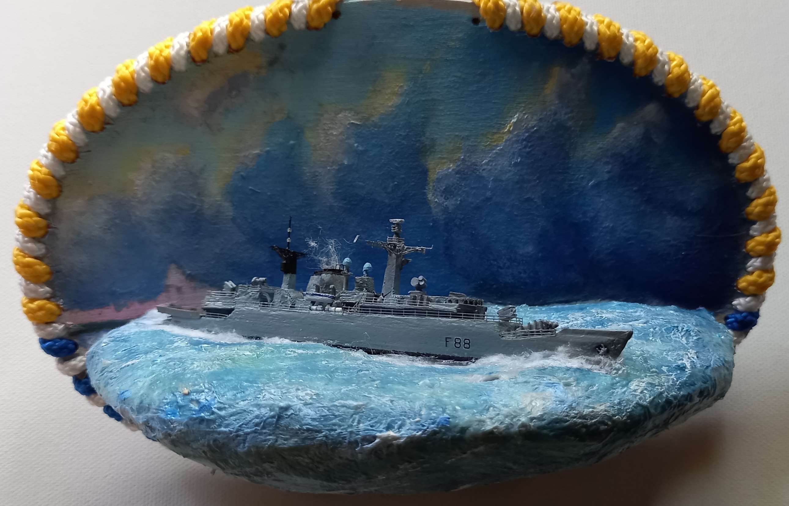

The overhanging decks I use fine sandpaper thats doubled over, superstructure a mix of balsa and plastic. Details then in etch or electrical metal core. Paint and OK

I will reply to this with finished pictures
