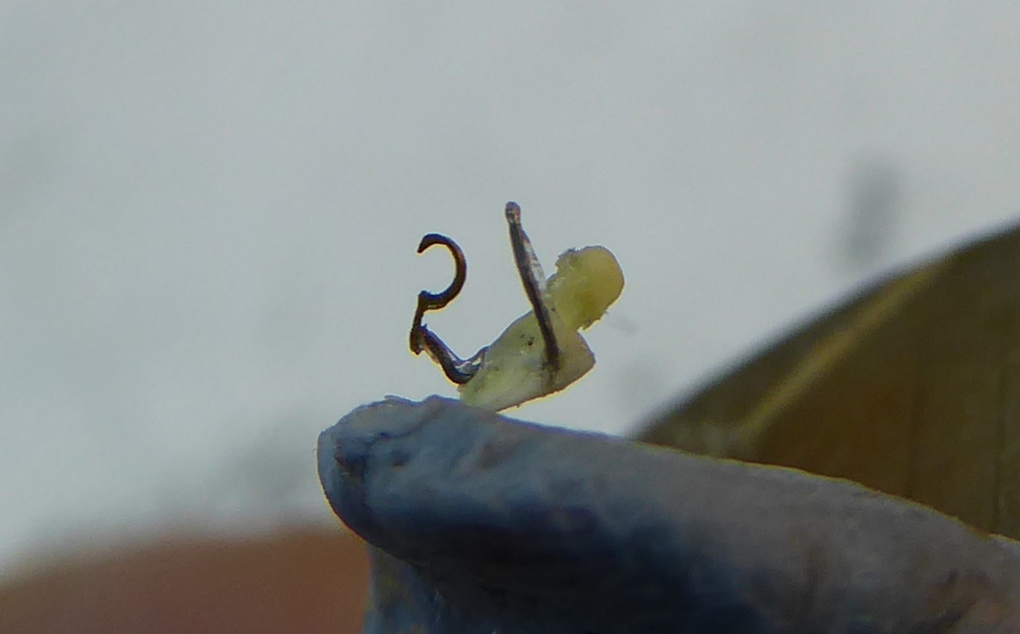

To make this figure head I used a L'Arsenal ( French company ! ) cast 1/350 figure
suitable chopped and altered;
I chopped off the arms ( ouch )
I drilled through the shoulders and made new wire armature arms
then bent the arms and thickened them with thinned white glue;
then made the sickle which was too big
and then made a smaller one...
