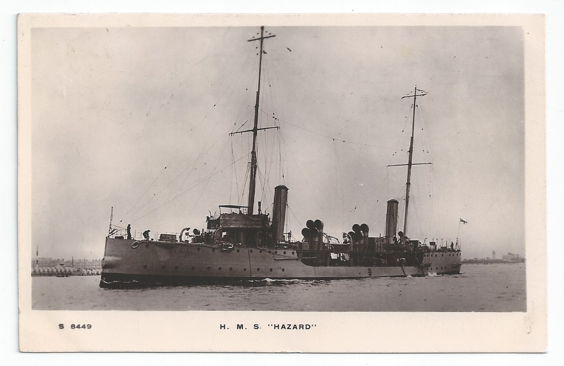

According to Perkins, the funnels were different AND the distance between the funnels were different.
Which ship is on the photo and which is on the plan?
Halycon had thicker funnels and less distance between them compared to e.g. HMS Hazard.

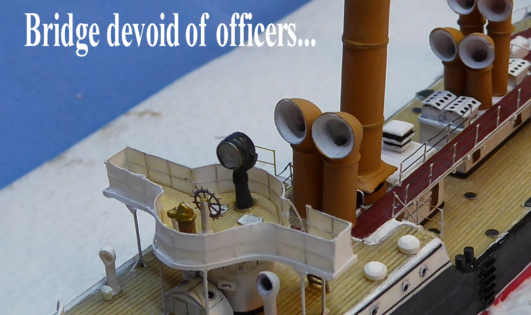

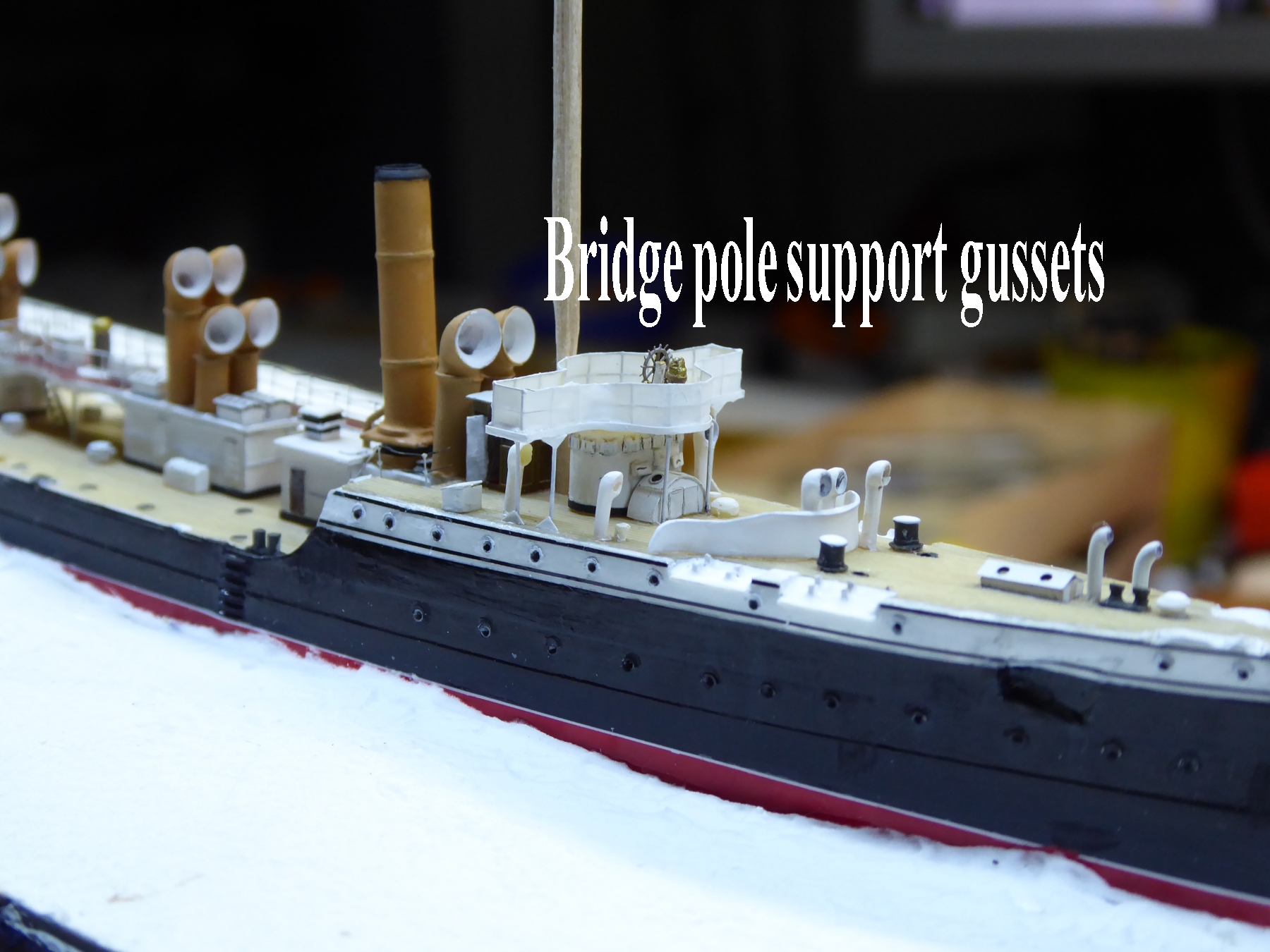

On Halcyon they were rather different
the uprights had triangular gussets top and bottom
these were orientated
lower; fore and aft
upper; athwart-ships
here they are on the model--the braces were cu of white paper
and installed with matt tacky varnish

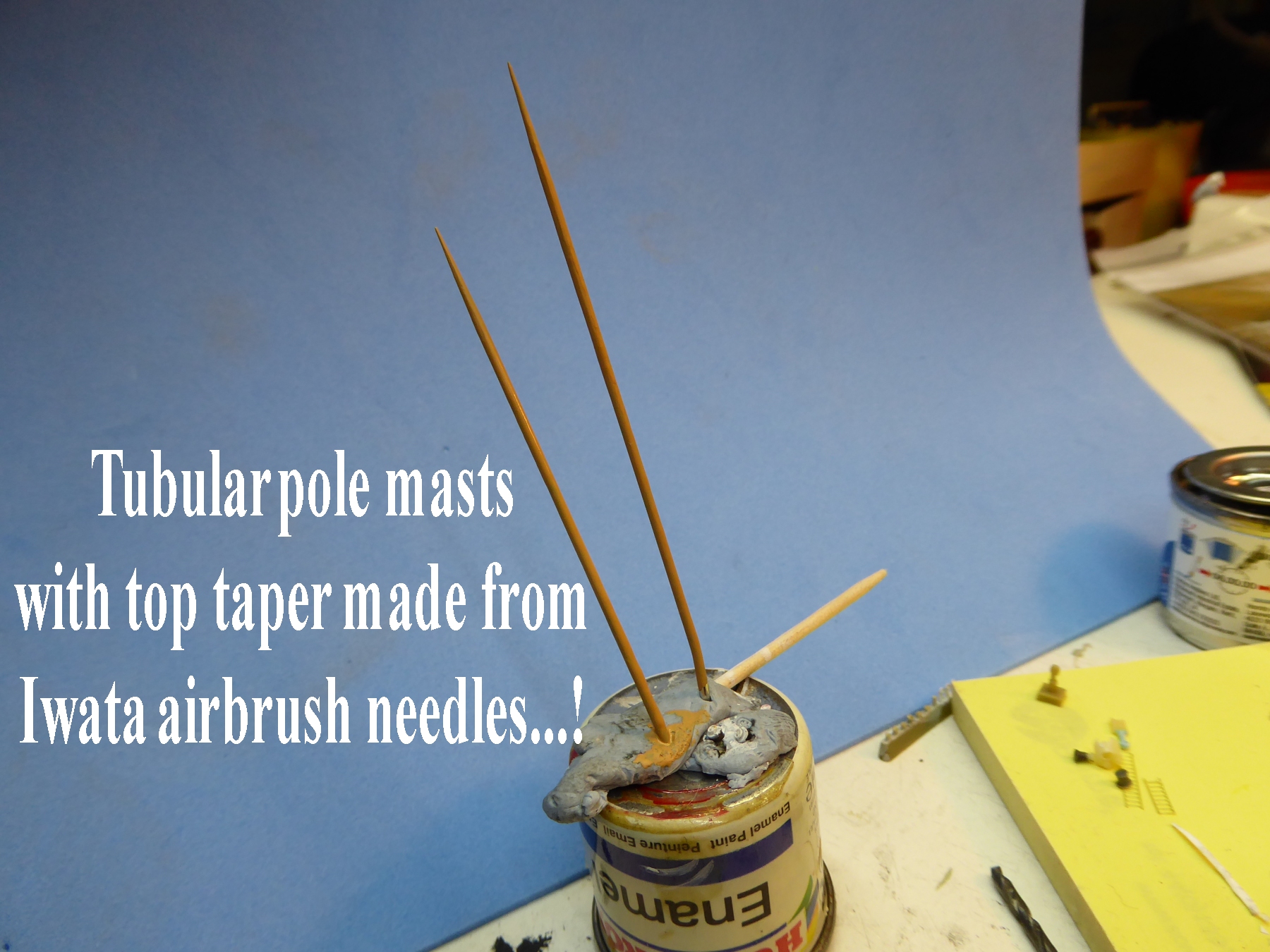

I was at the same time checking mast angles and clearances--I used a cocktail stick
( oversize to the masts but to ensure even gaps
The masts on the ship were parallel tube type with a sweeping taper at the top only rather then being conical

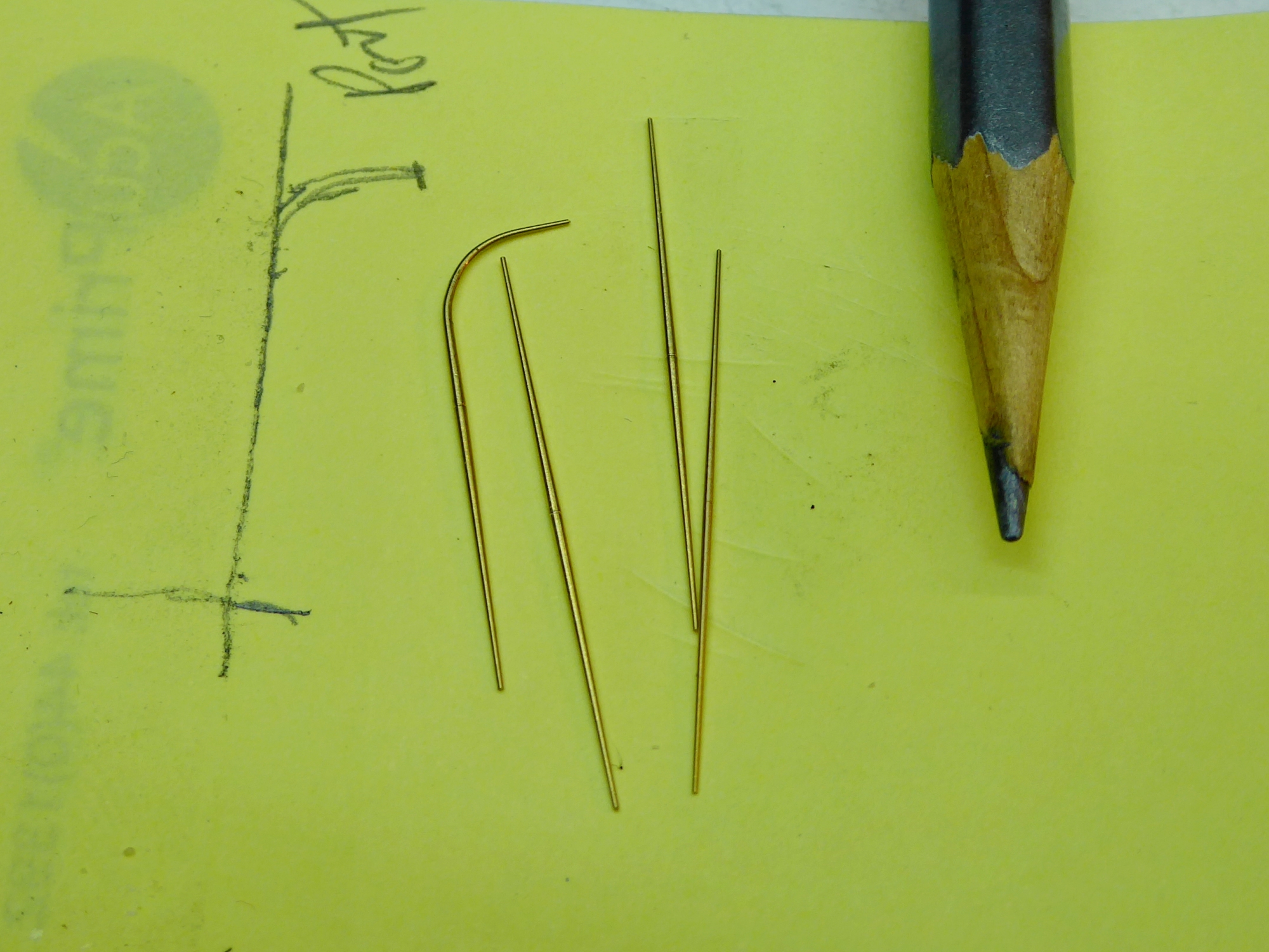

I made some masts out of stainless steel welding rod ...
but failed to get the positive curve taper....- numerous times!!
I searched for something I could use....
all knitting needles to large
and then .... found it --though this may appear sacrilegious.., !!!
but.... when on a mission...
I eyed up my spare Iwata airbrush needle hanging on the wall on its nice new packet...
and then-- after ordering an ( expensive) replacement... removed also the needle out of my airbrush !!
They needle diameter scaled up and measured beautifully...
Once I had nipped off the top of the pointy bit and made the cuts ...
there was no going back.... :whistle: :eyebrows:

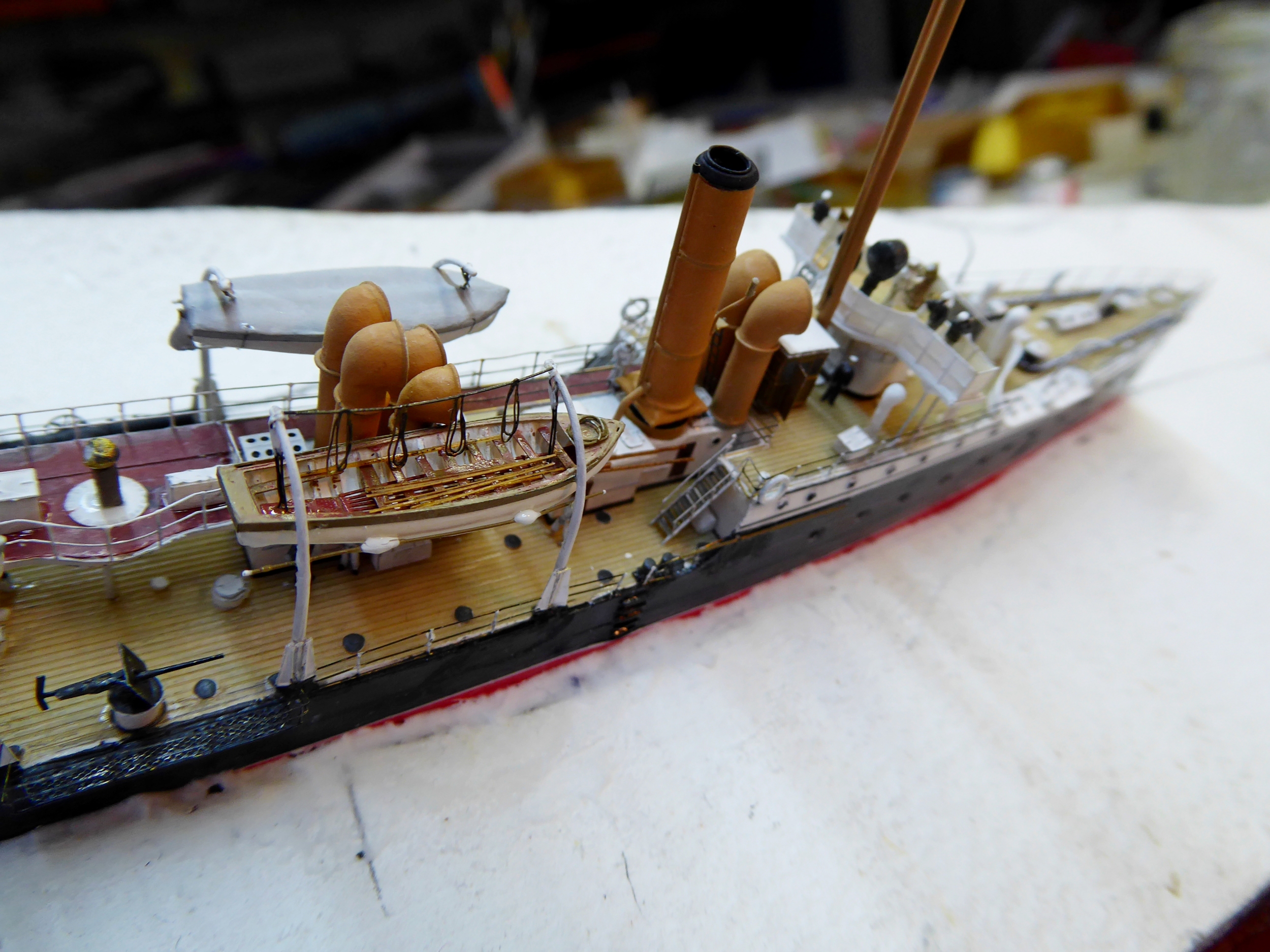

On any model-ship build -
some of the biggest time consumers are the ships boats...( still to come)
and the human aspect--the crew...
I actually actively dislike doing them both--
and nevertheless I go a little overboard on both :cool_2:
but with organic shapes in place its coming to life

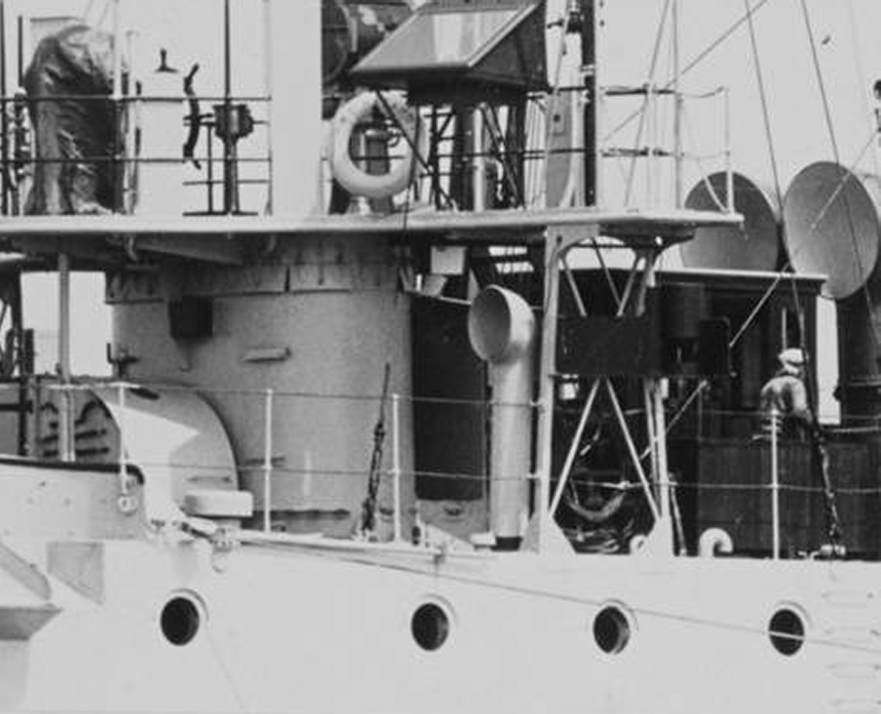

and discovered a useful davit photo

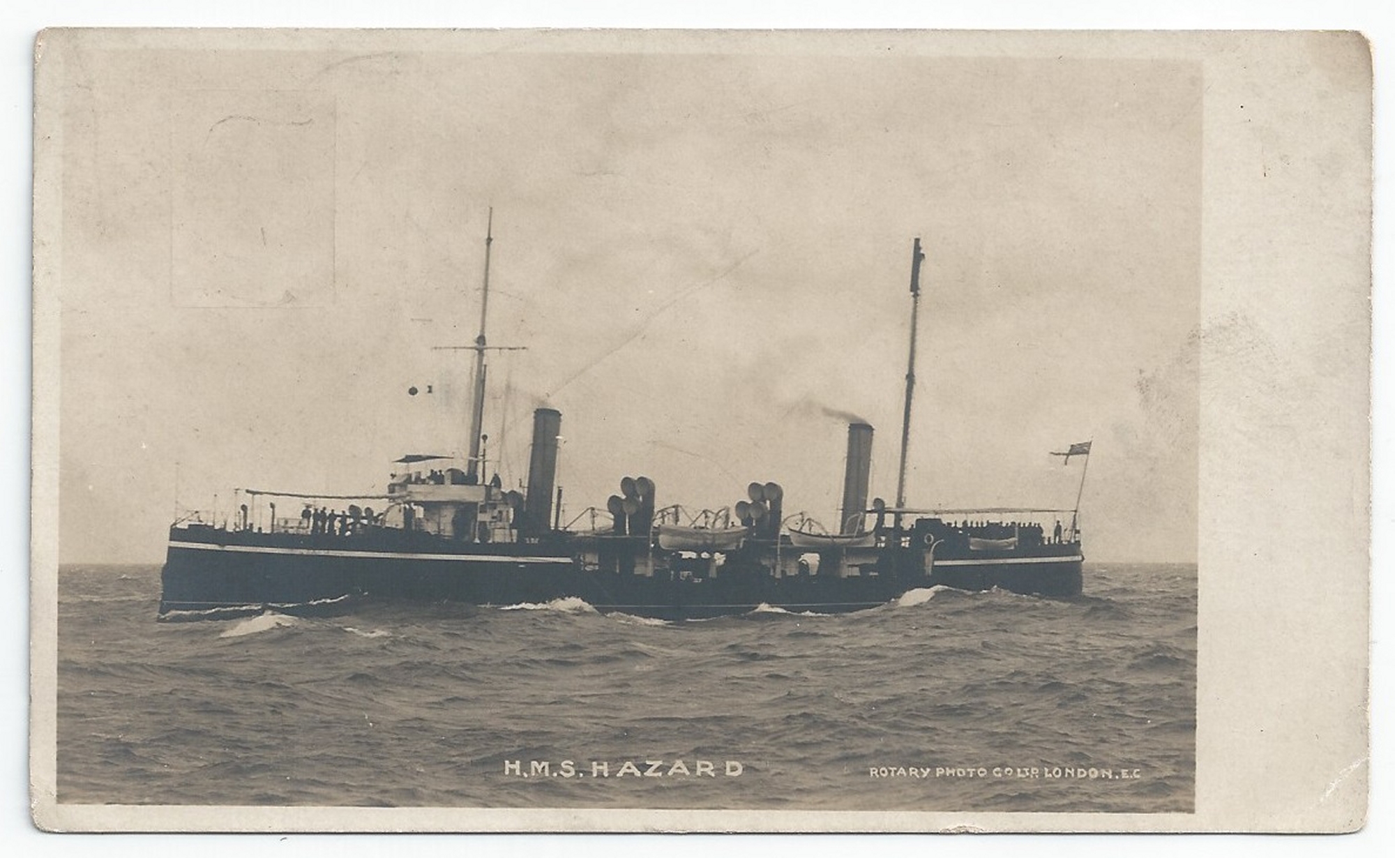

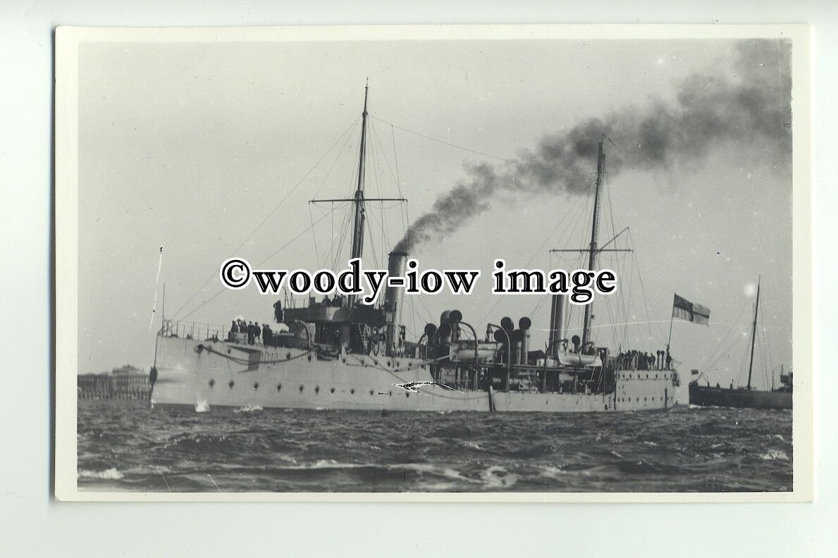

and again ---with a different member of the class
Can anyone shed any light on this flag practice--other than the obvious absence of a gaff spar...?

Looks like the main topmast has a semaphore attached . Maybe this interfered with normal flag practice.

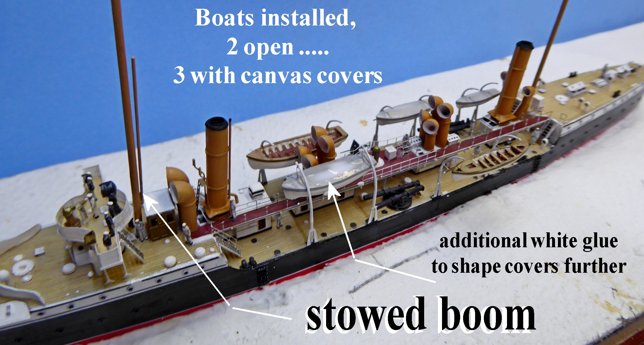

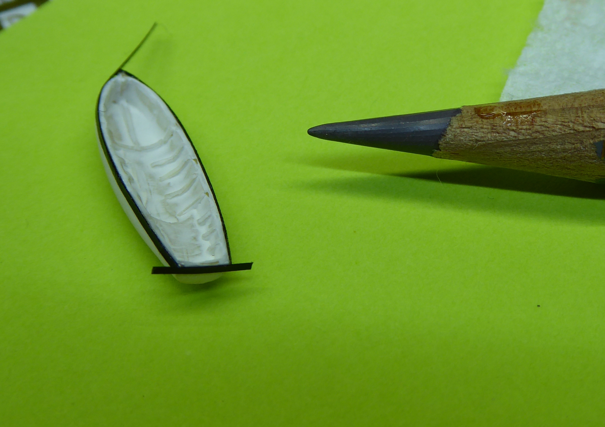

The boats that were supplied with the kit ..... had ( commendably ) a representation of ( crudely rendered) internal Ribs (overscale)
into / onto which almost none of the PE wanted to fit
This ship carried 5 boats --
Thankfully.... 3 of which -- even underway -were covered with canvas covers--Phew...!!
The Timber coamings were created using ) 0.2 mm black tapes.... sealed with CA and varnish, then snipped to size

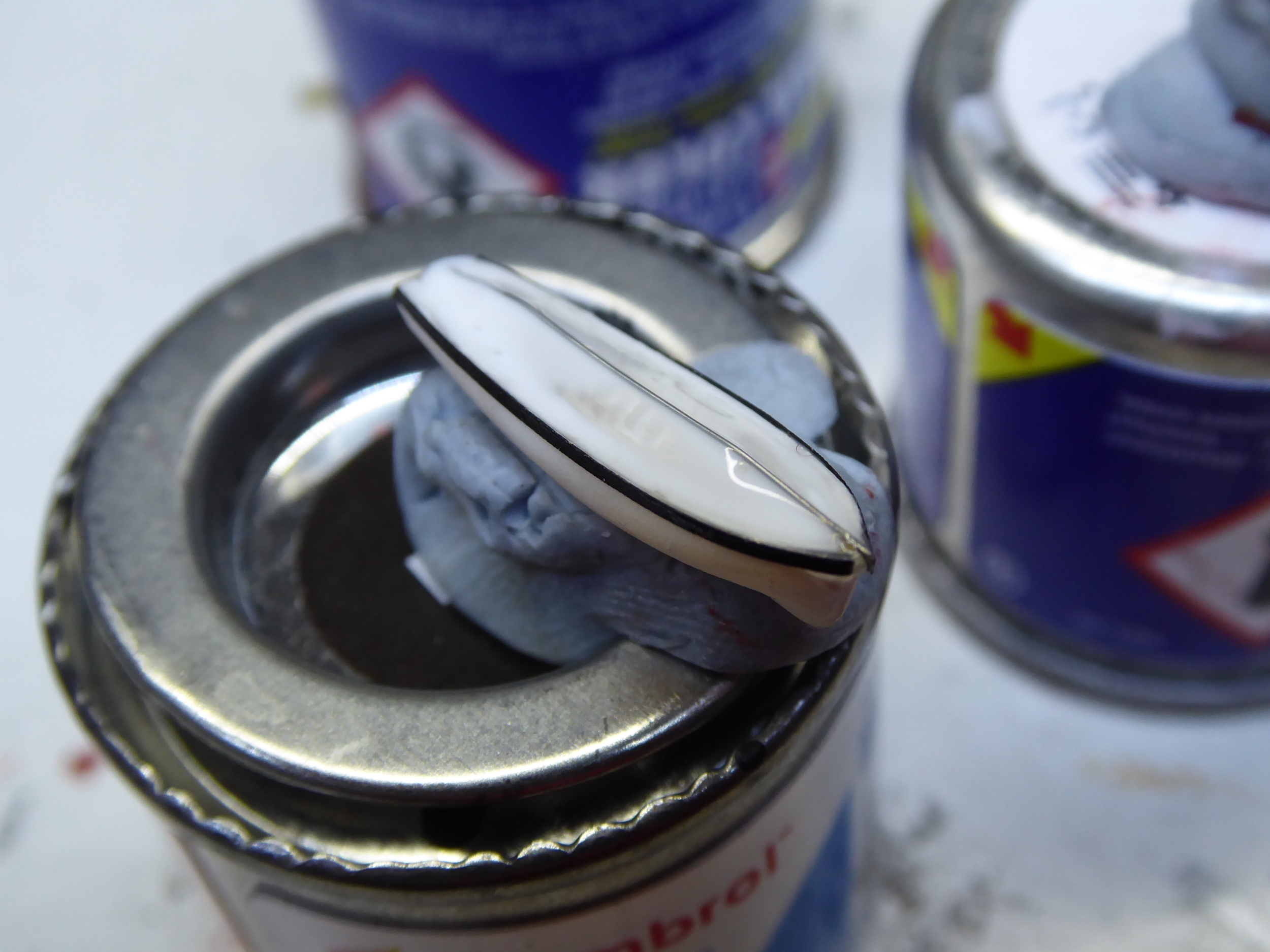

I made the boat-covers by forming a ridge over the boat
in wire and infilled with a span of white glue

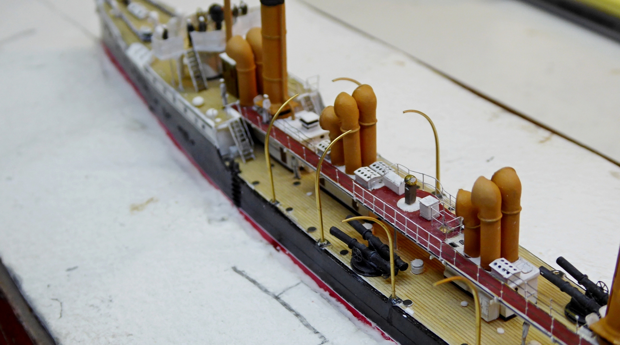

I wanted to blacken the kit supplied handrails--that were commendably thin
I used AK metal burnishing blue liquid ....
It looked good !
.... for a while..... :Mad_6:
somewhat tacken aback..........!!
:Mad_5:
I concentrated on other small stuff that was less soluble.... :big_grin:

so I made my own-using redundant elderly PE semaphores as a repeatable starting point
