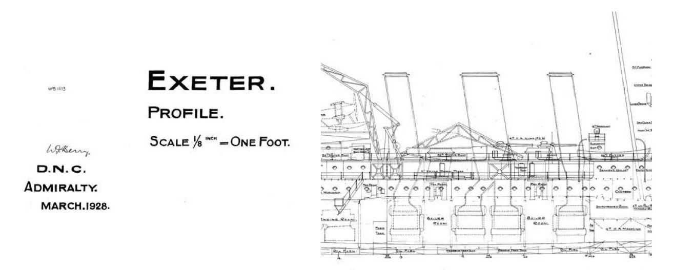

PostPosted: Tue Jul 29, 2025 1:52 am
Posts: 346
Yes, you can make an enquiry to get a digital copy emailed, but it will cost you. Probably have to pay for a copy of the whole book, after which the full digital copy is uploaded onto the site and made available to anyone, that`s the way it works. If you have those projections, you no doubt have this profile which shows what I previously posted and also shows the fan apparatus on the fan deck, they are precisely in the position of the 16 strips. Sometimes the obvious can be missed, the overhead shows `Funnel uptake "over"

PostPosted: Tue Jul 29, 2025 3:07 am
Posts: 490
Thanks again Brett! So are you saying above that those 16 'strips' are the boilers (meaning eight boilers per BR then), or as someone else said above, are they 'the base for boilers', which could then still be / 'mean' just four boilers per BR, if what we are seeing (the 'strips') represent just the 'stands / base' for the boilers (i.e. two 'stands' per boiler, four boilers per BR)?

In relation to your question dated 29th, the 16 small long rectangular boxes I earlier referred to are the bases of the fans above the boiler rooms, but more likely the actual fan uptakes. 2 boxes per fan, 1 fan per boiler. As I had pointed out the funnel uptakes are situated above the boilers. The boilers are in the positions shown in the 2 cropped profiles I had previously uploaded, your platform deck overhead clearly states `funnel uptakes "over" which would indicate they are directly over the boilers.
