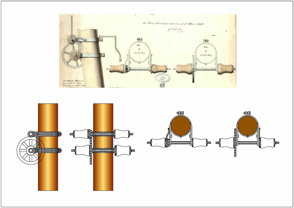

In between, I also drew the cargo winch, based on a drawing from the Danish archives for a little topsail schooner of 1852 (G-5204-17, https://arkivalieronline.rigsarkivet.dk/)
Working drawing for the cargo-winch attached to the mast
To be continued …
