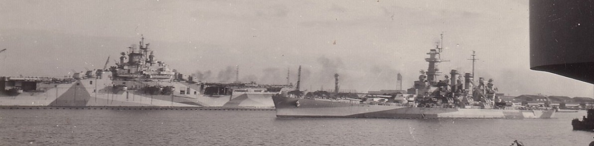

File comment: Two of my favorite warships, USS Yorktown and USS North Carolina. And, fortunately for us, both survive and are preserved as museum ships within about three hours travel by car, one at Charleston, SC and the other at Wilmington, NC. You can see them both the same day. Yorktown today does look a lot different being extensively modified post-war. North Carolina today looks very much as she does in this wartime photo, camo and all. Interestingly, the view today from museum pierside for both ships is the same as in this photo. Despite Yorktown's obvious drawfing of North Carolina in size, the battleship displaces nearly twice that of the carrier.

Painting the Hull
USS Yorktown was wearing Ms. 33-10a in April, 1945 at the time her air group, Air Group 9, helped sink IJN Yamato.
For those building Yorktown as she appeared in 1945, note that she had been repainted during the August-October, 1944 refit slightly differently than her 1944 Ms. 33-10a pattern so check your resources closely. Pictorial Histories Publication Warship's Data 5: USS Yorktown (CV-10) by Robert F. Sumrall (ISBN 0-929521-45-5), had several good photos of the ship in 1945 (post-1944 refit). Particularly useful in determining Yorktown's 1945 camouflage pattern were photos found on pages 1, 29, 35, 46, 48, & 49. They are particularly helpful as they show the ship freshly painted during its post-1944 refit cruise from all four quarters.
Still some touch-up to do but hull painting is largely complete.
The close-up photos below show the shell plating detail to good effect:
If you are building your model as the ship appeared in 1945, avoid the photo on page 60 of "Warship's Data 5: USS Yorktown (CV-10)". Although captioned "March 1945", the Bofors mount locations indicate that the photo is actually of Yorktown before the 1944 refit. The camouflage pattern in 1945 is slightly different than the pre-refit pattern.
Although I prefer WEM enamels, I am now airbrushing indoors so this model is being painted with ModelMaster and Poly Scale acrylics made by Testors. Despite reports that ModelMaster Marine colors and PolyScale marine colors have been discontinued, they are all available directly from Testors Corporation
