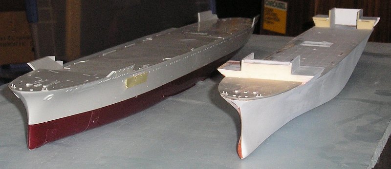

Well, here goes. I'll post a picture of my HORNET build to show the differences between the Trumpeter hull (upper) and the carved resin hull (bottom) - the artist formerly known as BWN. I'm still trying to figure out the best way to crop and export the picture to get the best resolution, so this effort may need improvements.
Believe it or not, the photo angle makes the differences appear less than they are.
I'll stop here to see how this picture posts.

I'm not happy with the picture, so I'll work on it and re-post. Hopefully this will still show how much work is necessary to match the actual hull lines. I have sometimes felt a strange kinship to blacksmiths of the bye-gone era. Wonder why.
Crap. I can't seem to get an improvement in resolution. The original is cropped to 156K - just too big - but when I reduce the size, even though it looks good enough on my photo editor, I get the same blob picture as above when posting. Help anyone?
Could you please post official the lines and body plan?

Here we go again.
It seems the transmission process is fogging up the lens or something. Just kidding - I have dial-up, that may be the problem. Trust me, though, these pictures look much better in the folder than here.
It's quite hard to see, but there is a great deal of flare under the foredeck because the hull is very narrow there. The width of the hull at the waterline under the forward edge of the 5" galleries is just about 20% of the width of the hull at the waterline at midships. You can see that the Trumpeter hull is nearly as wide at the forward edge of the 5" galleries as it is at midships.

Thank you Mr W for responding on the body plan question.
I have no idea what Trumpeter charges for the kit of the Hornet, but if I was to buy the thing and then to find out about this enormous error, one for which there can be no excuse, I would be more than upset.
What a disgrace, Trumpeter should be keel hauled for this. I can only think that they found the hull drawings scrawled on the wall of a pissoir.
This kit, as it appears in the picture that you have posted, is near fraudulent.
