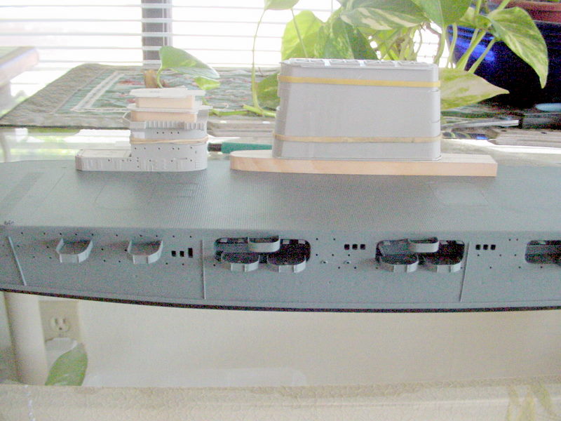

One pic of the island and stack roughed out, shot this pic primarily to show which parts were used and which were replaced.
I will be quiet for awhile, starting on the flight deck which I have been putting off because I could not figure out what to do with the life nets. Using them almost seemed as crude as using aztec stairs (which I did leave in the boat pockets - but will try to apply a PE side rail) but it took awhile to conceive of a scratch alternative.
Thanks for the interest so far.

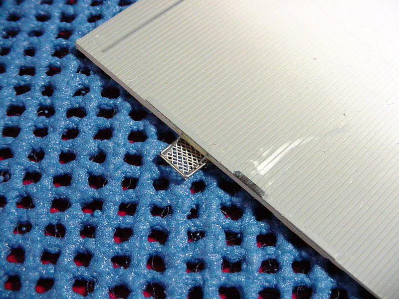

Have made LOTS of parts, some shown in first photo.
The second photo shows a test of the flight deck edge, made from black vinyl (electricians) tape. The tape is .006" thick and cuts with a very good edge. This photo also shows a test of my safety net construction. The frame is a staple and the net is the hem edging I mentioned previously. Comments pro or con accepted.
I do have a question to ask, The hull is just about done and it is a filthy mess. There is Bondo dust, styrene chips, sawdust and general grime everywhere! I am thinking about blowing off with the airbrush (unfilled) at 80 psi, followed by making some "tack rags" from an old t-shirt wet with mineral spirits. Any better ideas?

Great looking build so far :thumbs_up_1: I think the safety net might be a tad over-scale, however compared to the very symmetrical PE versions I have, yours look more realistic and I am now considering doing something similar when I tackle this project. Can't wait to see this one done.

Matt, There is a lot of "fine stuff" that is over scale. The net has a .030" opening which converts to 10 inches, the staple frame is .018' which is 6 inches in diameter! I am firmly in the "impressionistic" or "representational" school.....if it looks OK from 1 to 2 feet I am a happy camper.
