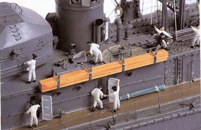

The 1/100 scale Akizuki in Gakken #23 has what appear to be, at first glance, a floating target bullseye contraption stored in this position. Of course, a closer glance makes me wonder if that's really what it is, because the "raft" doesn't look substantial enought to hold the target. But, too crude to be much anything else. Definitely not part of the deckhouse structure, that's for sure.

But the thing is not completely round, and one edge of it is shaped to follow the plan of the deckhouse so it doesn't overhang the edge. This suggests it is part of the ship, and not a raft lashed on top of the deck house.

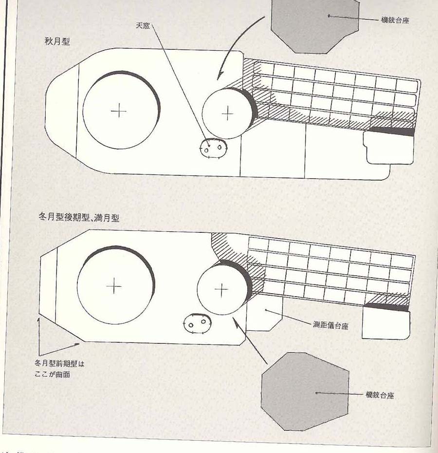

My mistake, wrong side. I'll look at my plan sets tonight as well. Perhaps it's an access hatch as in this illustration from Gakken #22.

Hmmm, the aft deck house on the Trumpeter kit would match the configuration shown in the upper drawing. The round structure in question would have been placed to the lower right-hand side of the type 94 AA director in that picture. So it does not correspond to either of the two labeled structures in that drawing. The size of the structure would have about the same as the base of the type 94 director.
