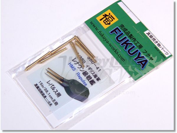

they also have the main guns available.

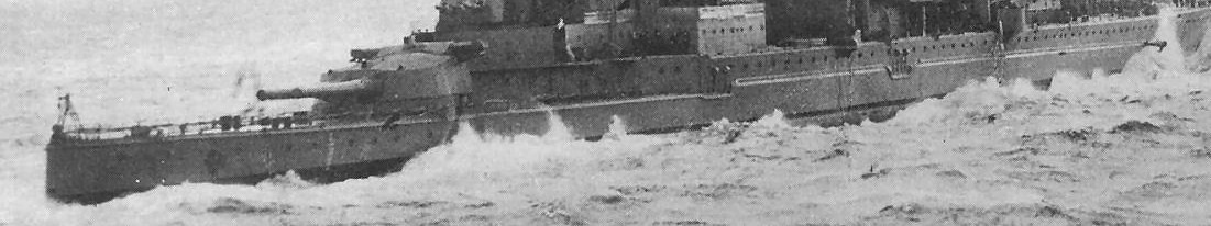

I am having a devil of a time figuring out exactly what happened to REPULSE's degaussing coil at the bows of the ship. Photos of the ship in 1940 and of the wreck are no help. This famous view seems to suggest the cables were carried up above the prow:
This view seems to confirm this:
But these views from a 1940 gunnery shoot do not show a degaussing coil anywhere in the region of the bows:
Two views of the prow of the wreck show nothing at all (unlike HOOD's coil which is still clearly visible) except for a rope apparently belonging to the divers:
I wonder if the cables were taken inside the hull at the bows for some reason?
Two final queries: (1) can anybody recommend a large scale plan which accurately shows the shapes of the ventilators on the aft superstructure fore and aft of the HADT? and (2) can anybody recommend a large scale plan which shows the correct shape of the structures beneath the aft single-barrel 4-in. HA guns? I am building a 1:300 scale card REPULSE.

Here are enlargements of the bow and stern portion of an Admiralty portrait photo taken of REP on 5 July 1941. The degaussing coil cable is clearly visible on the hull aft. The angled covering for the cable can be seen leading up from running along the top of the lower armor belt in the bow enlargement, but where it led was not clear.
