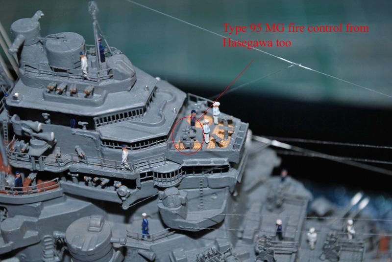

I'm in the progress of building the Maya in 44' and am just wondering if Aoshima's two little plastic knobs sticking up from the platforms and the one in the tub are in fact supposed to be gun directors?
Also, there are two circular stand placements on the forward open bridge extension, just behind the 3 pairs of binoculars and I have no idea what sits there.
- Posts: 9037
I don't have the model but, per the 1/100 model in Gakken, at least for the rear structure, those are binocular stands. Not sure what you are referring to in question #2 - can you post a diagram/photo/instruction sheet?

Hiya Kym, i don't know if the equipment i added at those places is accurate while doing my research i saw different things on all models i checked, i'm certain of one thing though, in all those models i checked they had some kind of optical equipment. i took the liberty of taking some shots from my model so you can see which opticals i added. HTH
Jose
Jose

Jose, it was your model I was using to see what they were, but couldn't quite them out in the gallery photos. I have very little reference on the Takao class and even less on the Maya, but I do have plenty of those Hasegawa optical pieces, so the problem is solved, thanks.

Only a handful of pictures of Maya remain i bought the Maru Special "Chokai and Maya" and that book left me wanting to see more pictures of her in 44, all i found there were 3 images of her at that time. there is an image which was taken right from the deck and is showing partially the starboard side of the new AA structure which replaced turret #3 and there is also another one on which the photographer decided to use a triple 25mm MG as the camera's standKym Knight wrote:Thanks fellas.

I am very certain that that all the indicated positions are of lookout binoculars, probably 12 cm. As Jose's fine model shows, the positions atop the bridge are part of the AA control platform that is typical of late war ships. Search binoculars are consitent in this position. I concur with Joese's assessment of the lack of late war Maya photos. Attached is the only one that even show the AA control positon to any detail and it is taken from below.
