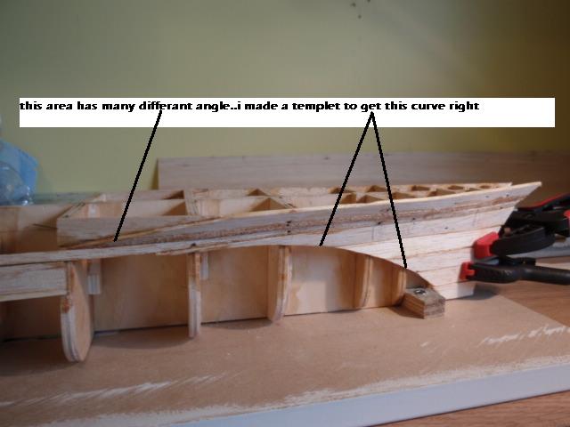

this is going to be a very complicated hull to build,i am going to really have to pay attention to all the little kinks and curves in the frames.i am going to cut the frames in half and butt join them to the center runner,i have found that trying to make the frames slid into the centerpieces was very hard to keep them sqaure.each frame has to have 1/8 in. cut off the side that butts to the center to allow for the 1/4 in. center piece.the frames also have 1/8 in. taken off.this allows for a beam of 113.3 ft. beam.now the job of cutting all the frames all 42 of them.my poor scrol saw is going to earn its worth.

heres an update.nagato has 4 indents in her hull,2 at the bow and to at the stern.i belive thay are hull bulges and armor belt,whatever they are they are a bugger to build.i spent 10 hrs on this small amount of planking,my hull frame drawing shows the bulges but my side and top view does not show the bulges.this made things difficult to line up.this has been my most difficult hull yet,i belive most battleships that had torpedo bulges added are the same e.g.warspite,queen elizabeth. it is very satisfying to spend hrs on a detail and have it come out right.heres some pics
