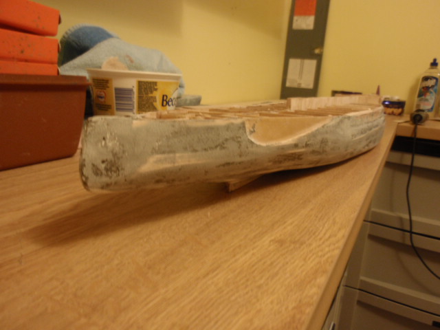

hello guys, being sort of retired give me lots of time to build,trying to get all the smelly stuff done before it gets to cold to be working in the garage.the wife complains if i do smelly stuff inside :heh: i hope what i am posting is not to repetitious or old hat.but i am sure there are some who have not built a scratch hull.after giving the hull a good coating of resin the next step is fiberglass bondo,this is allowed to set up and then sanded down,then a coating of reguler bondo,then bondo glazing and spot putty to fair the hull, this takes many coats sanded in between untill there are no dips and bumps i am sold on bondo the spot putty puts any of the hobby shop stuff to shame at a fraction of the cost.hull is sheated with 1/8" sheating which is fairly fragile,after all the above steps it is tough as nails.heres some pics ,here the hull has only the resin and fiberglass bondo on it,it already gained a bit of weight.
PostPosted: Mon Nov 09, 2009 1:17 pm
Posts: 1173
i have been fairing the hull for the last couple of days,coming along good.i have found that when applying the bondo putty on large areas i put a good amount of putty at the top and useing a credit card pull down in one motion as far as you want to go,do not piddle around with it to much,if you do it seems not to make it any better,it is easy to sand off, so if there is to much it is better.after the big areas are done then it takes 3 or 4 touch up applications to fill in the little dips.
