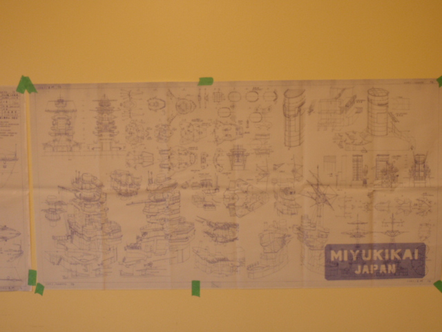

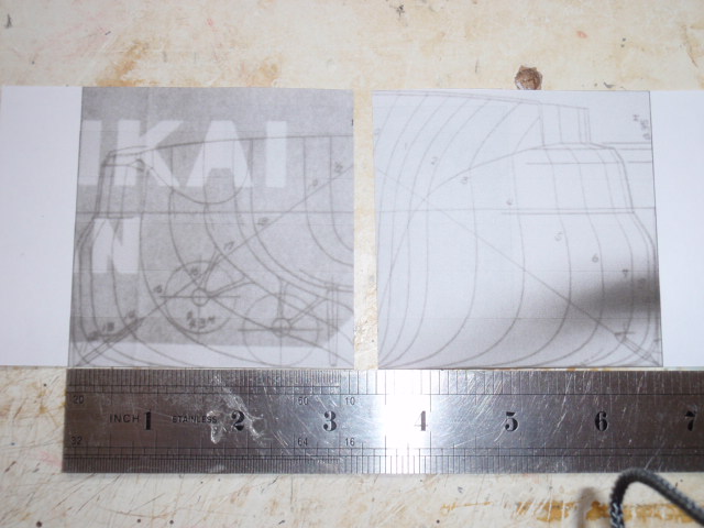

Thanks timmy,i was not sure on the right thing to do.I started printing out my frames and they always came out wrong,I was going nuts trying to fiqure out what i was doing wrong.I was taking the whole width of the drawing and it came out to big,this was because you have to take one side and double the distance.plan has front part on one side and the back on the other.heres what i mean.somtimes i go brain dead.There is also a couple of pics of my plans,they are quite good

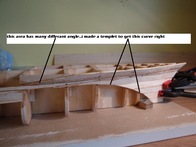

heres an update.nagato has 4 indents in her hull,2 at the bow and to at the stern.i belive thay are hull bulges and armor belt,whatever they are they are a bugger to build.i spent 10 hrs on this small amount of planking,my hull frame drawing shows the bulges but my side and top view does not show the bulges.this made things difficult to line up.this has been my most difficult hull yet,i belive most battleships that had torpedo bulges added are the same e.g.warspite,queen elizabeth. it is very satisfying to spend hrs on a detail and have it come out right.heres some pics

hi dave,yes she will be a static model.i should make myself clear on the bulges.i have drawings for then and lots of pics,it's just that the drawings are in1/400 scale,i have to scan then resize .i find most plans always seem to have some thing lacking. i have 2 sets of hull frame drawing for the same year and they are differant from each other.go fiqure.i see you are working on planes you must be getting close to seeing the light at the end of the tunnel.

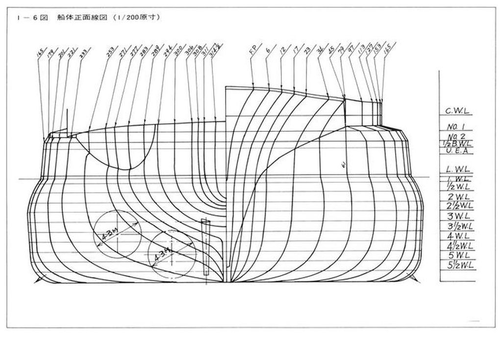

I have the 1:200 hull sections from Fuji Art plans and the Fuji Art book on the building of a 1:200 Nagato. These are the most accurate things on the planet. They were drawn from the original Nagato plans.
You got to see them if you need to work on the hull.

thanks for the help akula,i look forward to any advice or help.the hull frame drawing i went with is pretty well the same as what you show here.they come out to a beam of 113.3 ft. at the bulges.which is the correct beam after 1936 ? i belive that was the year of the big rebuild.lengthening the hull,adding torpedo bulges,trunking funnels."etc,etc".

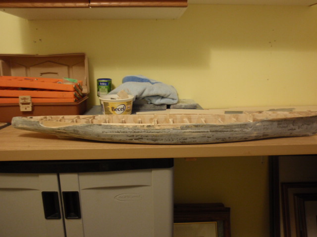

she's coming along fairly good.got all the planking done,roughed in the bow and stern,i then mixed up a batch of resin and coated the hull inside and out, this is not for strength,it is to make sure that if any glue is weak the resin has every thing stuck together .i set styrene pieces in the bow and stern to hold the shape,it is tougher than the wood so it will not lose its shape when i am am sanding. this is a trick i picked up from bill waldorf,he did this on his indiana,it makes a nice crisp bow.

hello guys, being sort of retired give me lots of time to build,trying to get all the smelly stuff done before it gets to cold to be working in the garage.the wife complains if i do smelly stuff inside :heh: i hope what i am posting is not to repetitious or old hat.but i am sure there are some who have not built a scratch hull.after giving the hull a good coating of resin the next step is fiberglass bondo,this is allowed to set up and then sanded down,then a coating of reguler bondo,then bondo glazing and spot putty to fair the hull, this takes many coats sanded in between untill there are no dips and bumps i am sold on bondo the spot putty puts any of the hobby shop stuff to shame at a fraction of the cost.hull is sheated with 1/8" sheating which is fairly fragile,after all the above steps it is tough as nails.heres some pics ,here the hull has only the resin and fiberglass bondo on it,it already gained a bit of weight.

i have been fairing the hull for the last couple of days,coming along good.i have found that when applying the bondo putty on large areas i put a good amount of putty at the top and useing a credit card pull down in one motion as far as you want to go,do not piddle around with it to much,if you do it seems not to make it any better,it is easy to sand off, so if there is to much it is better.after the big areas are done then it takes 3 or 4 touch up applications to fill in the little dips.
