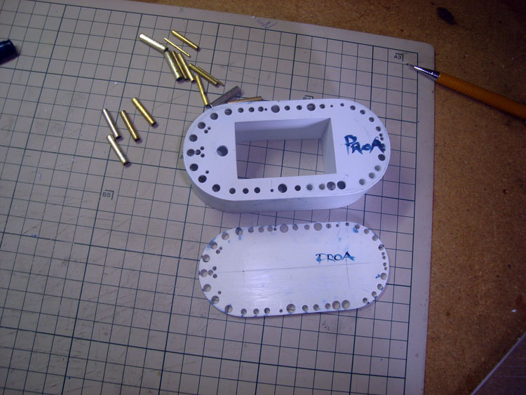

hI people..
i am posting the works on funnel's hood...
and installation of exaust or admission or air tubes on funnel.
each plate was drilled by x-acto and file and each plate have 47 holes(my hands what say) LOL..
but still incomplete this work... more progresses i post...
regards :wave_1:
File comment: component pieces. middle plate still not driled

File comment: in the drawing aferition

 Post subject: Re: Bismarck 1/100
PostPosted: Tue Nov 24, 2009 5:29 pm
Posts: 1205
Location: ATHENS, GREECE
Oh boy... this is called work for a monastery to say the least...
Great patience and skill required, both of which you seem to possess Norbert... :thumbs_up_1: :thumbs_up_1:
Where did you find the metal parts?
NIKOS (NICK)
PostPosted: Wed Nov 25, 2009 6:42 am
Posts: 1993
Location: Brasil
Hi GTDeath13
i thank you so much the kind words.
yes i having patience and discipline but this consuming more time to do.
in my case the time is short always the weekends and some weekends i need give attention to wife and childrens.
well the tube brass i purchase here. here have a shop called CENTRAL DE METAIS E FERRAGENS(central metal and ferrous) who sell all about metal.
well when more progress i post
regards to Grecia = paradise of Gods and Godesses... :thumbs_up_1:
