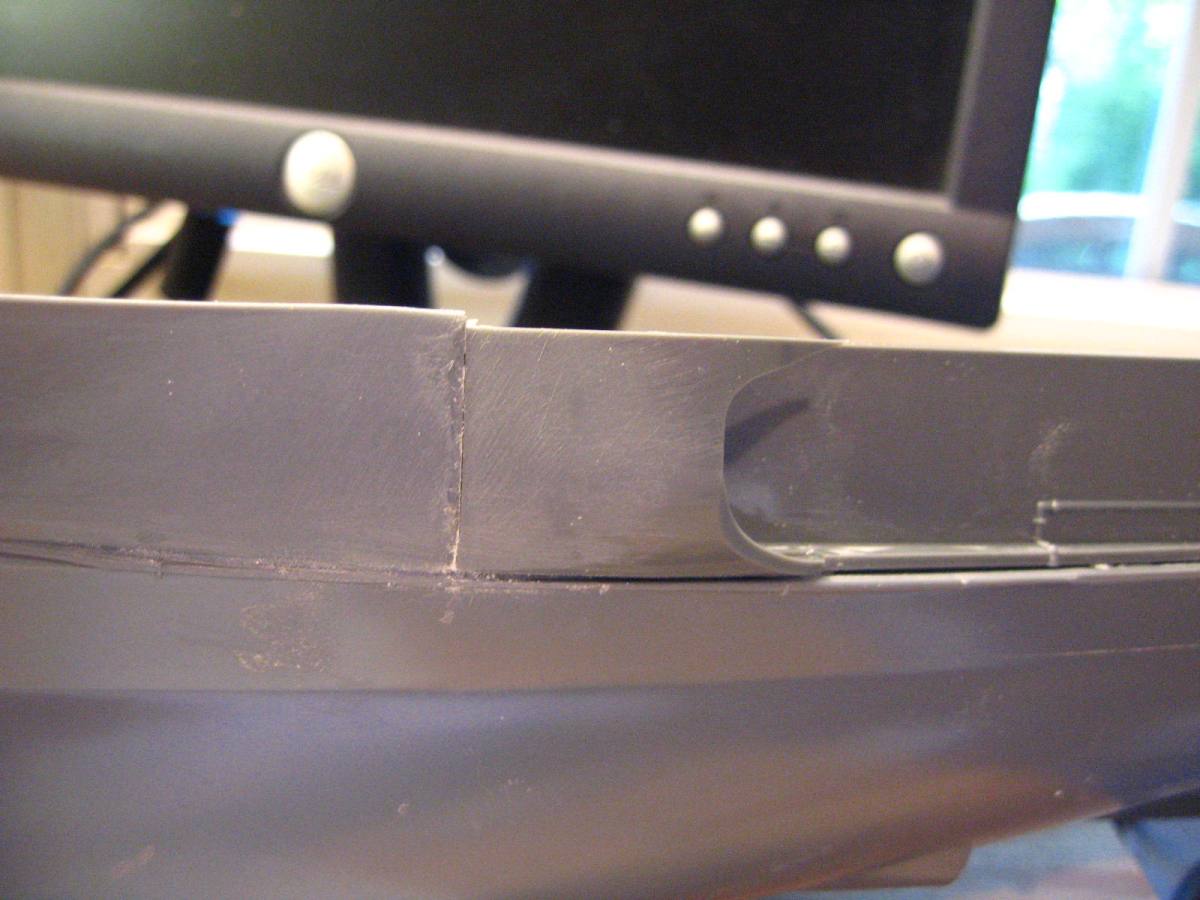

The fit of the stern sections where the boat wells are is TERRIBLE!!!! I mean this has to be one of the worst fits on a model I have ever seen. I am messing around with different attempts to clean this up, but I may just try to scratchbuild this area from styren sheet and junk the kit parts. I have also started removing the Degaussing cable that is molded on the ship, so I caqn do the hull plating, then I will scratch build a new cable with crisper details after the plating is done. Nothing is easy with this build, but it is fun, and I am learning a lot as I go.

That back area is giving me a lot of trouble, I tried something a few days ago and left it to cure the glue before I start sanding and filling again, but if that doesn't work, I am going to try to scratchbuild it form sheet styrene.
This build is fun, but at times can be very frustrating as you well know. I think the stern area should be my last major hurdle, then the rest of the build should be generally straight forward, that is until I get to the rigging part, which I admit, I am not looking forward to!
