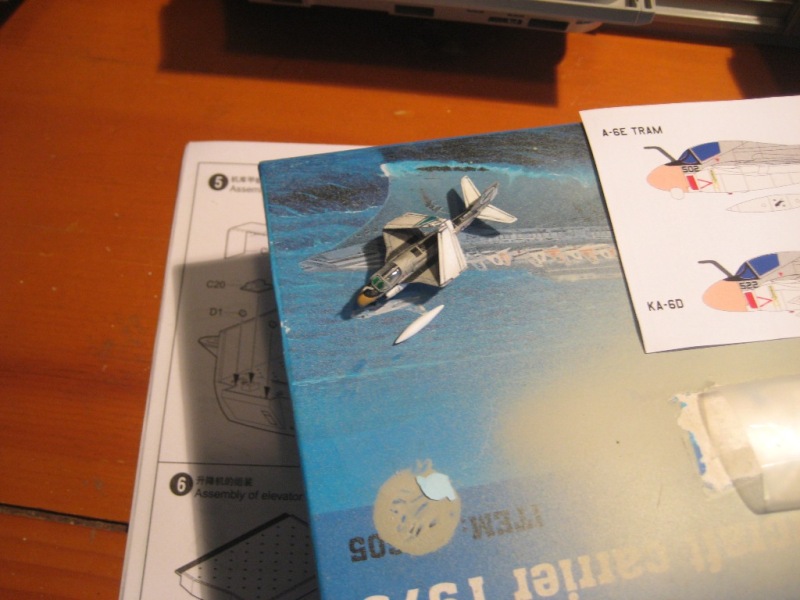

Well, figured I'd start a thread for my 1:350 USS Nimitz build as I hope to gain some knowledge, tips and tricks, and any help from everyone here.
This is my first 1:350 ship build. While a teenager in the early 90's, I built both the 1/700 Enterprise and Forrestal. After many years of wanting to build a large ship, I bit the bullet and bought the Trumpy Nimitz since I have a lot of time on my hands now.
As of today, I'm on step five in the build with some minimal PE attached. But...I started on an A-6 as a test-bed for the carrier wing.
After construction, she was painted with Model Master Flat Gull Gray and hand-painted in Acrylic white. What I learned from modeling Armor was the use of water color filters that were used on my 1/16 Tiger I build. Using a pea-size drop of water color, mixed with a drop of dish soap and some water, mixed in shot glass, the mixture was applied across the model. After drying, I dipped my small flat brush into water and wiped off the excess and began to wipe away the areas outside of the panel lines. Although the photos show the uncomplete filter wiping, the effect is beautiful, giving depth to the model and that nice-dirty-carrier-ops-plane-look :)
I ordered the WEM CVN-68 aircraft wing PE set today, so CVW-8 will get the full compliment of PE goodies. After finishing up this A-6, which includes gloss coat, Starfighter decals, PE set, she'll sit in the hangar deck. I learned a lot with just this one model and am going to try some other techniques with the rest of the aircraft.

Befoer you get too far invested in the airwing, check your painting references. I am almost 100% sure that for the timeframe you are modeling the Nimitz, all of te aircraft had the top surfaces of te tail wings painted white. The trumpeter kit does not display this correctly, they show the tail wings grey. Like I said I am almost completely certain about this detail, so check it out. The intruder and weathering look good though man! I just stated a build of te Harry S Truman out of this kit this weekend, she should have her own in progress thread soon!

You're right about the stabs being white. Trumpy has one color, Starfighter has it flat gull gray, as does many other VA-35 resources. Easy fix though and luckily it's just one plane instead of 12 :P

About 75% done, stabilizers corrected, minus filtering, droptanks and PE. Canopy not attached and hard to tell in this light, but the canopy got the Future-treatment also.
