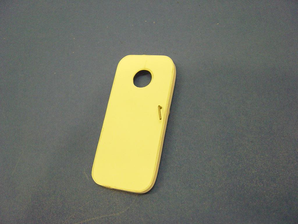

Hello again all. :wave_1: While awaiting my fibreglass hull, I decided to take on the building of the pilothouse for the boat. I call it a boat as it's a bit small to be a ship. Overall length will be about 41", with a beam of 8.5", in 1/24 scale. After an exhaustive search, there were no original drawings to be found for this later plywood pilothouse. Mr.Read and his son, who is an accomplished CAD person were able to come up with some really good drawings of what we feel this unit should look like. A best guess scenario if you will. Mr. Read was aboard during WW2 and has a very good memory of the boat. It's really quite amazing after over 65 years. In any event, going by the CAD drawings, I was able to come up with a good representation of said pilothouse. Hull has now arrived and work continues. Let's take a look...............
File comment: Portside overhead view here. House is made from balsa and sheet and strip styrene. There are 11 windows, or ports. Only two open, just behind the center one. I represented it open, while all others are glazed over with thin clear styrene. Roof is 3/32" balsa, and house walls are .020 styrene.
File comment: Stb. side overhead view here. Note the frames around the ports. I made a small mold of the frame, then Vac-U-Formed them, adding the rivet pattern with a pounce wheel after molding. I then cut them out and attached them. The three forward ports are slightly bigger than the others. The divider strips between the wall sections are .010 styrene strip.
File comment: Another view here from stb. side. Note the curvature of the roof. W/T door opening added as well as a porthole on the back wall.
File comment: Portside view here. Note the dogs for the W/T door, made from .030 steel wire. Rivet pattern around ports more visible here.
File comment: Aft wall of the pilothouse. Note the grey abs angles mounted. They are part of the supports for two platforms that will go here. Basswood grating will be used. This will be the Flying bridge. Opening in the center will be closed in and will contain the engine controls, compass and tachs, as well as a voice tube of two. Steering wheel will go in the center just below this. Hole you see is marked wrong. Porthole will also be glazed from inside.
File comment: Inside view of the pilothouse. Built much the same way that the original was. A bit more interior bracing to be added. This will all be painted white. Lots of other details to add, but you get the idea.
File comment: Stb. side view. Again, more detail to be added as I go along.

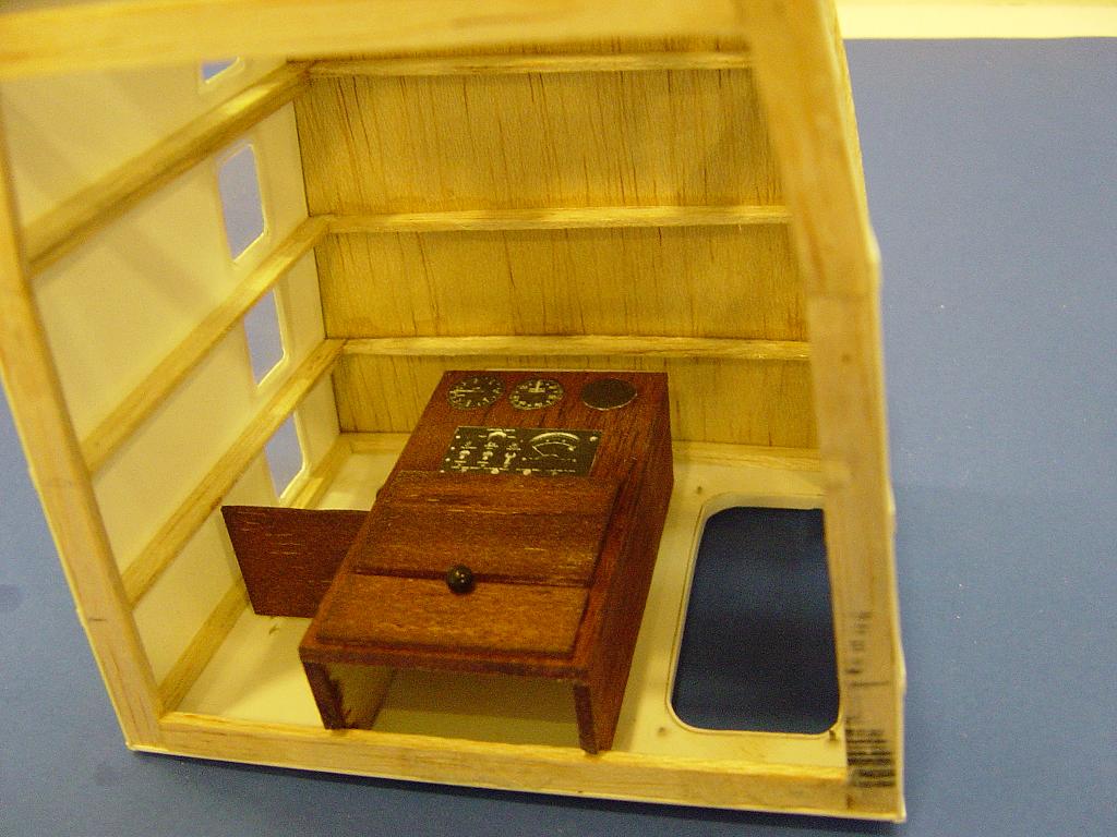

File comment: Heres the radio, desk, chart compartment and storage area located inside the house on the aft wall of the Pilothouse. Dials are clock, barometer and radio speaker with the square unit being the radio. Knob on drawer too big, so I'll replace it with a smaller one.
File comment: The above compartment in its position. Not yet permanantly attached. More to come on these inside details later.
File comment: W/T door outside. I will attach this in its open position for display.
Well, there's the rough-in on the pilothouse. Many more goodies to be added, so stay tuned! I continue on.................. :wave_1: :thumbs_up_1:

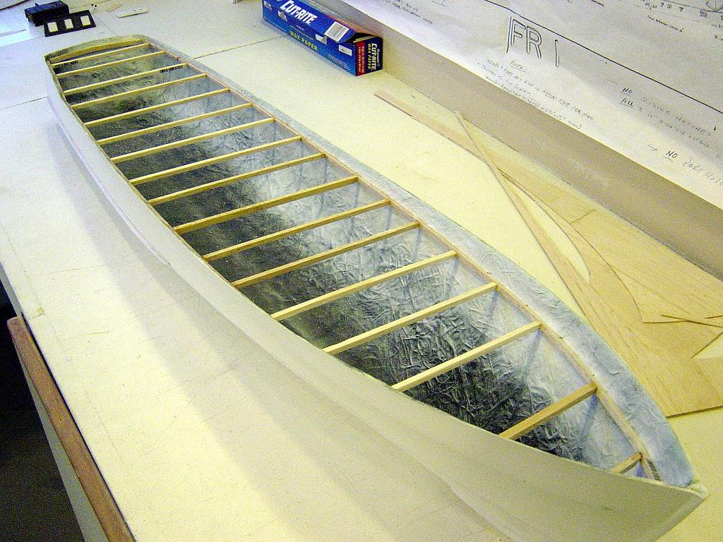

Well, I am quickly back :cool_2: As I said above, the fibreglass hull has finally arrived after 3 weeks. A screw up in shipping, but nevertheless, it is here. It was advertised as a "very clean product". The verdict? Well, it is clean. But it has no details on it whatsoever. Up to the modeler to add those. Thats Ok, we can do that! It also has a slight twist to it from fore to aft. I will compensate for that during the rest of the build. I have never used a fibreglass hull before so this is new for me. All in all, I think it will work out. The general shape looks accurate, and the finish is good. A bit of sanding and tweaking here and there. Lets take a look.............
File comment: The first order of business with this was to sand it out smooth. I then had to plot out where the deck would go. There is a line molded in the hull that shows the break between the hull and the bulwark, but it does not go all the way aft. I drew lines on the outside of the hull where the deck should be, then drilled small holes that would be visible on the inside of the hull after a coat of white primer. I then added the framework you see, plotting along the small holes already drilled. 1/4" balsa stick used here. Frame work is flat right now, I will add the camber before I secure the deck to the hull.
File comment: Another view of the deck framework. Note how rough the inside of the hull is. I will cover the inside of the bulwark with some thin sheet balsa with a styrene overlay after deck is installed to cover this roughness. Bulwark bracing and details will be added after that. Note the lower rub rail installed.

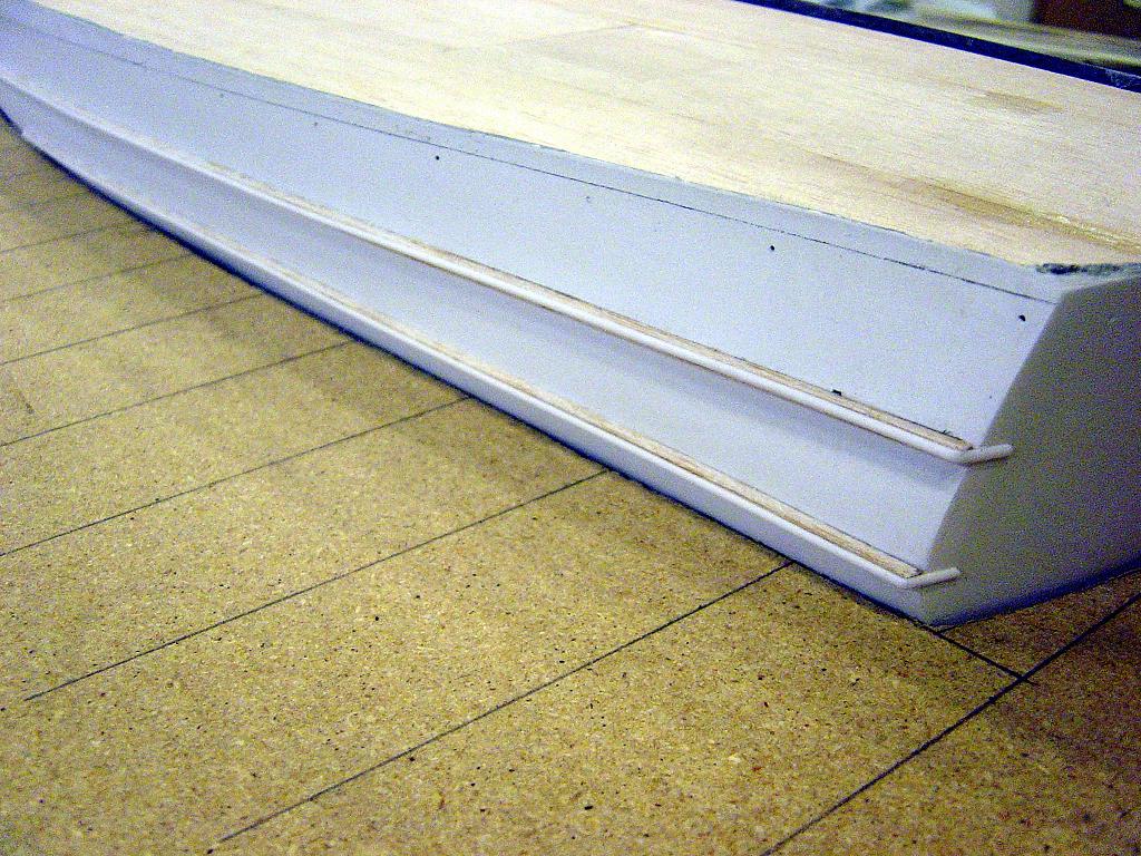

File comment: Portside aft, looking fwd. Again note the rubrails. Deck is 1/16" sheet balsa. I will cover this with 1/32" scribed basswood,to simulate the plank lines at 1/8" spacing, then add the camber to the deck using 1/8" balsa stick. More on that later.
File comment: A close up of the intermediate rubrails. Made from 1/8" sq. balsa and faced with .080 1/2 round styrene to simulate galvanived iron as on the real boat. Note the holes drilled for the deck plot and the plot line for the main rubrail, which will cover the holes.
