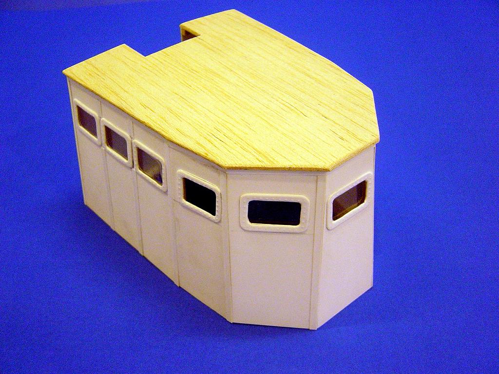

Hello again all. :wave_1: While awaiting my fibreglass hull, I decided to take on the building of the pilothouse for the boat. I call it a boat as it's a bit small to be a ship. Overall length will be about 41", with a beam of 8.5", in 1/24 scale. After an exhaustive search, there were no original drawings to be found for this later plywood pilothouse. Mr.Read and his son, who is an accomplished CAD person were able to come up with some really good drawings of what we feel this unit should look like. A best guess scenario if you will. Mr. Read was aboard during WW2 and has a very good memory of the boat. It's really quite amazing after over 65 years. In any event, going by the CAD drawings, I was able to come up with a good representation of said pilothouse. Hull has now arrived and work continues. Let's take a look...............
File comment: Portside overhead view here. House is made from balsa and sheet and strip styrene. There are 11 windows, or ports. Only two open, just behind the center one. I represented it open, while all others are glazed over with thin clear styrene. Roof is 3/32" balsa, and house walls are .020 styrene.
File comment: Stb. side overhead view here. Note the frames around the ports. I made a small mold of the frame, then Vac-U-Formed them, adding the rivet pattern with a pounce wheel after molding. I then cut them out and attached them. The three forward ports are slightly bigger than the others. The divider strips between the wall sections are .010 styrene strip.

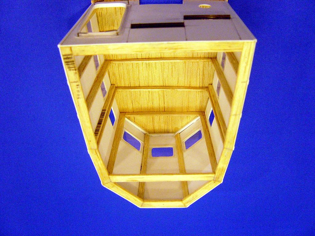

File comment: Inside view of the pilothouse. Built much the same way that the original was. A bit more interior bracing to be added. This will all be painted white. Lots of other details to add, but you get the idea.

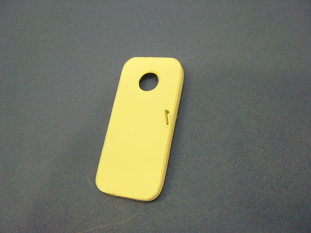

File comment: W/T door outside. I will attach this in its open position for display.

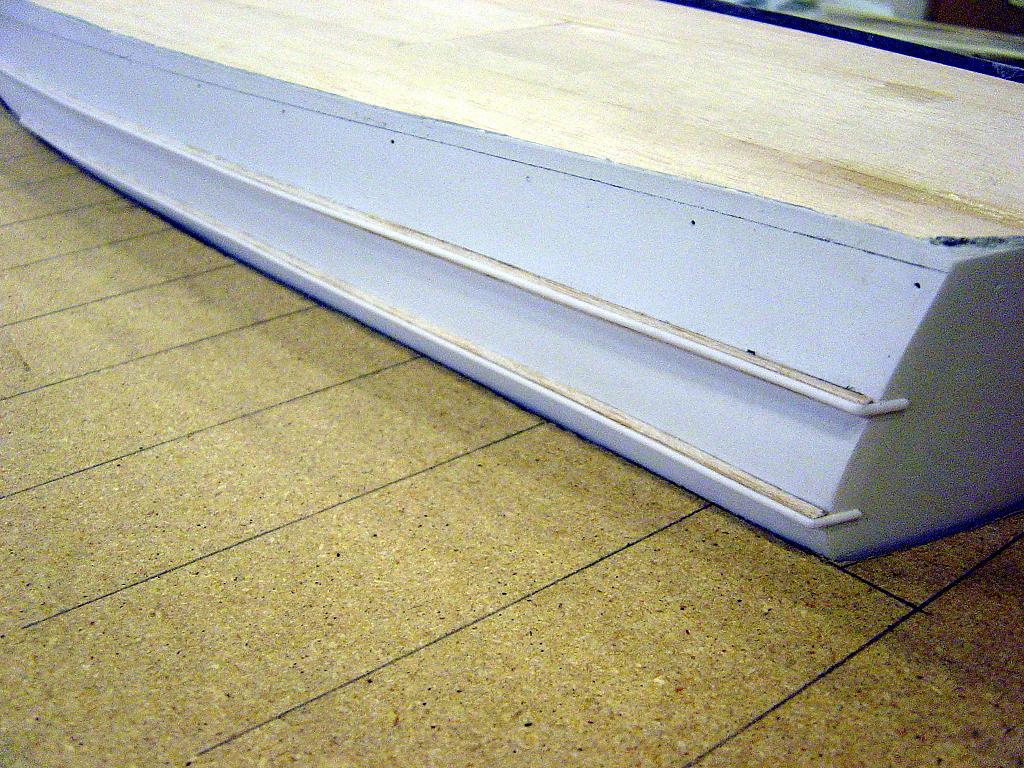

File comment: Heres the preliminary waterline base for the boat. 3/4" particle board. I plotted lines on the hull at 2 inch increments on the bottom of the keel. I then drew these same 2 inch increments on the board with a centerline. Using a pair of large dividers or calipers, I plotted the width of the waterline as it goes down the hull then transferred these dimensions to the board to get the waterline profile. I did this as I did not want to cut thru the fibreglass at the waterline. This way, I can adjust the rise of the ship as she goes thru the water, high speed or low.
File comment: Portside aft, looking fwd. Again note the rubrails. Deck is 1/16" sheet balsa. I will cover this with 1/32" scribed basswood,to simulate the plank lines at 1/8" spacing, then add the camber to the deck using 1/8" balsa stick. More on that later.
File comment: A close up of the intermediate rubrails. Made from 1/8" sq. balsa and faced with .080 1/2 round styrene to simulate galvanived iron as on the real boat. Note the holes drilled for the deck plot and the plot line for the main rubrail, which will cover the holes.
File comment: Portside overhead view. Note the boat does not fit tight into the base as I want to be able to adjust it slightly as I begin the model the water.
