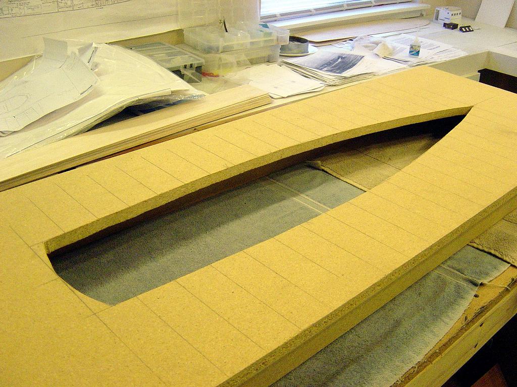

Well, I am quickly back :cool_2: As I said above, the fibreglass hull has finally arrived after 3 weeks. A screw up in shipping, but nevertheless, it is here. It was advertised as a "very clean product". The verdict? Well, it is clean. But it has no details on it whatsoever. Up to the modeler to add those. Thats Ok, we can do that! It also has a slight twist to it from fore to aft. I will compensate for that during the rest of the build. I have never used a fibreglass hull before so this is new for me. All in all, I think it will work out. The general shape looks accurate, and the finish is good. A bit of sanding and tweaking here and there. Lets take a look.............
File comment: The first order of business with this was to sand it out smooth. I then had to plot out where the deck would go. There is a line molded in the hull that shows the break between the hull and the bulwark, but it does not go all the way aft. I drew lines on the outside of the hull where the deck should be, then drilled small holes that would be visible on the inside of the hull after a coat of white primer. I then added the framework you see, plotting along the small holes already drilled. 1/4" balsa stick used here. Frame work is flat right now, I will add the camber before I secure the deck to the hull.
File comment: Another view of the deck framework. Note how rough the inside of the hull is. I will cover the inside of the bulwark with some thin sheet balsa with a styrene overlay after deck is installed to cover this roughness. Bulwark bracing and details will be added after that. Note the lower rub rail installed.
File comment: Heres the preliminary waterline base for the boat. 3/4" particle board. I plotted lines on the hull at 2 inch increments on the bottom of the keel. I then drew these same 2 inch increments on the board with a centerline. Using a pair of large dividers or calipers, I plotted the width of the waterline as it goes down the hull then transferred these dimensions to the board to get the waterline profile. I did this as I did not want to cut thru the fibreglass at the waterline. This way, I can adjust the rise of the ship as she goes thru the water, high speed or low.

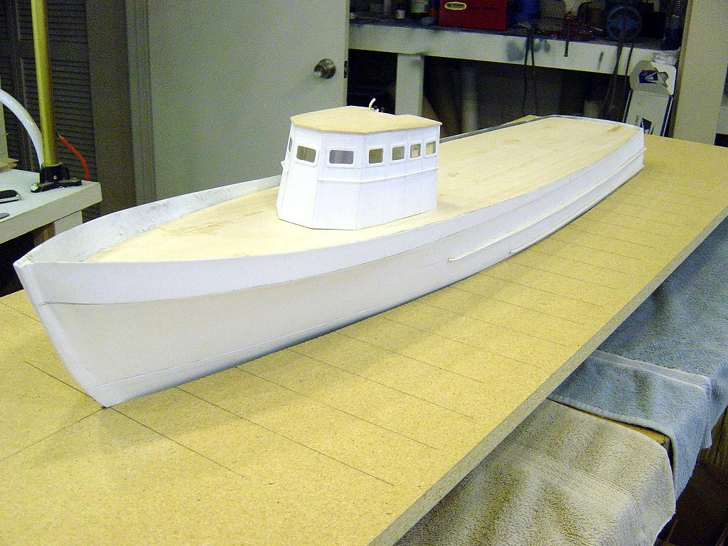

File comment: Portside overhead view. Note the boat does not fit tight into the base as I want to be able to adjust it slightly as I begin the model the water.
And theres the rough-in so far. Things going to plan Ok, if I can just get these people to send my stuff to the right place. :heh: More to come............Stay tuned...........I continue on................... :wave_1: :thumbs_up_1:
File comment: Now we have the hull, pilothouse and deck dry fit together and placed on the base. All loose fit for now. Note I have added the intermediate rub rails on this side. Still have to do the upper one which is slightly wider.
