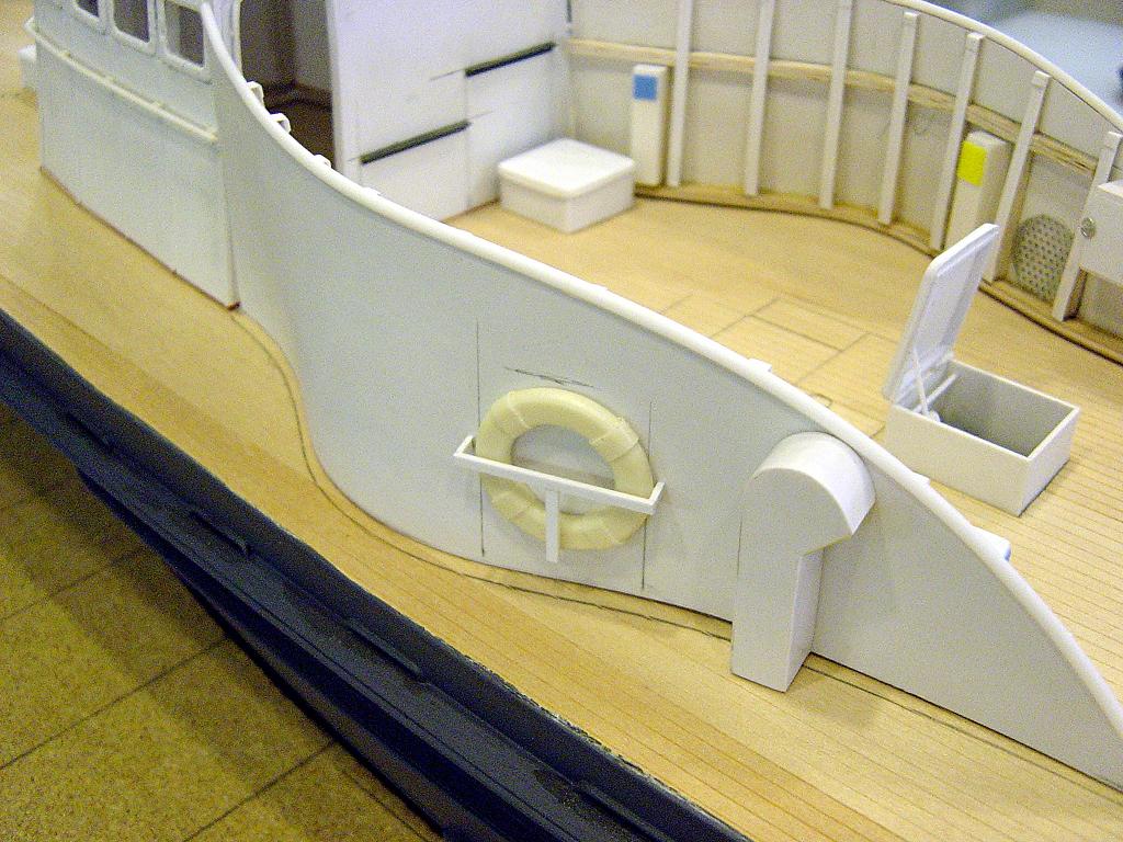

File comment: More details added here. Life preserver is cast resin. The holder is styrene strip. Vent you see is engine room blower exhaust, made from balsa block and again wrapped with thin styrene. They had to run the exhaust blowers for engine room for at least 10 minutes, except in emergency situations. Note the forward engine room hatch, open.

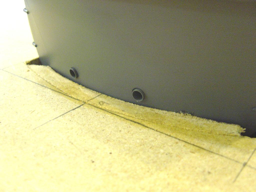

File comment: All rub rails now completed and I have added the scupper openings and anchor hawses. Hull has been sanded and primed. All deck hatches installed.
File comment: Another view here from port. Small hole in side of hull is generator discharge, both sides.

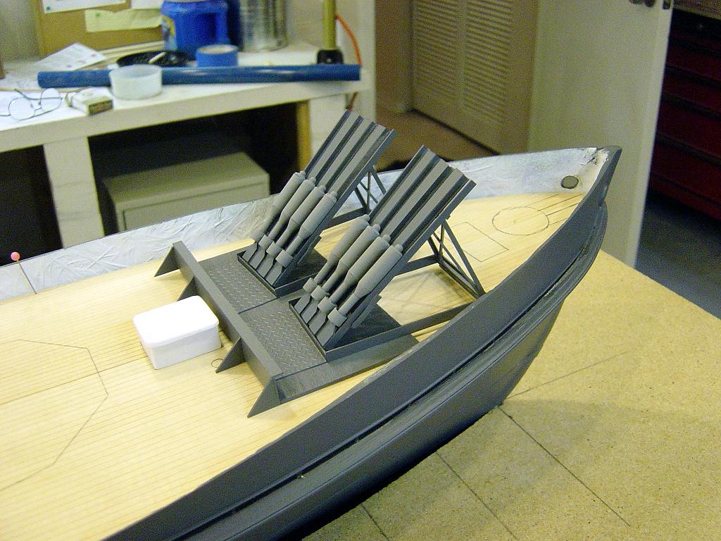

File comment: A shot of the 7.2 rocket projectors. Let me give a brief rundown on these........At the beginning of WW2, the standard anti-submarine weapon was the depth charge. One useful development for this type of weapon were called "projectors" - devices which could throw a pattern of depth charges ahead of the attacking ship, thereby avoiding the time lapse between the detection of a submarine at some distance and the actual attack.The US Navy's standard projector was the "Hedgehog" from 1942 onwards. This was reasonably effective, but the large recoil prevented its use on smaller craft, I.E., patrol boats. The solution was a rocket propelled depth charge. Enter the Mousetrap. this was a standard hedgehog charge fitted to a 2.25" solid propellant rocket motor. The name "mousetrap" was derived from the launcher, which was simply four steel rails mounted at a fixed angle, about 2 degrees, to the ships deck. The rails were raised or lowered manually. On small craft this system was used until the end of WW2. Range was about 300 yards. Photo shows assemblies pretty much finished. A bit more fine tuning on the rockets themselves.

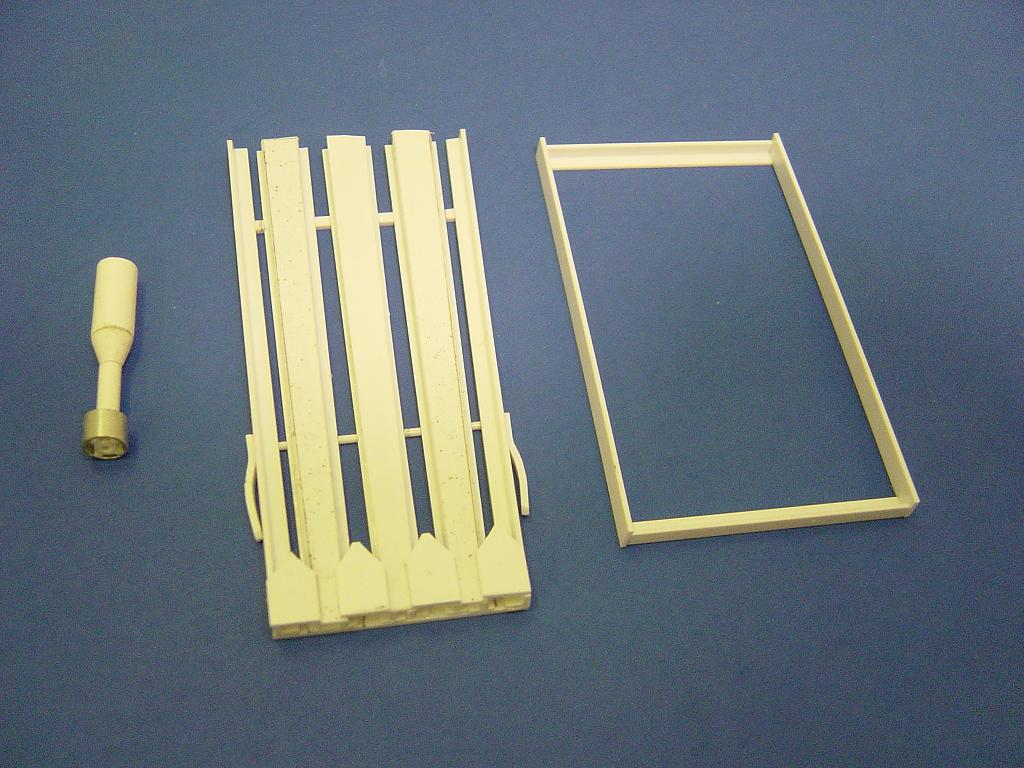

File comment: Heres the three main parts to the assembly. On the left the rocket ,not completed. Middle shows the rails and to the right is the rail frame. All styrene used here.

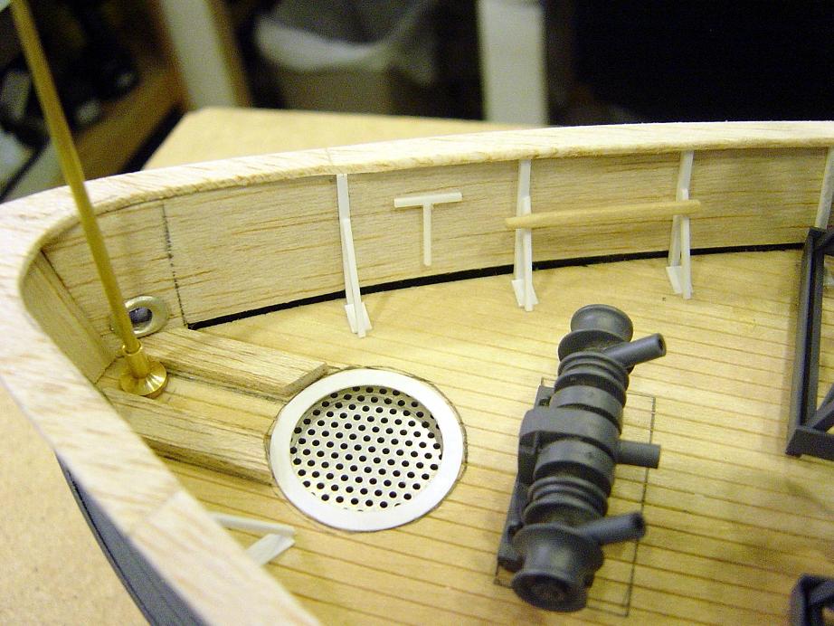

File comment: A close up here of the bow area. Small T is a scuttle plate wrench, to the right of that is the winch handle, they were manually operated. Also added hawse lips and skid plates for anchor lines. Forward jackstaff is turned brass. Scuttle grating is perforated aluminum.
