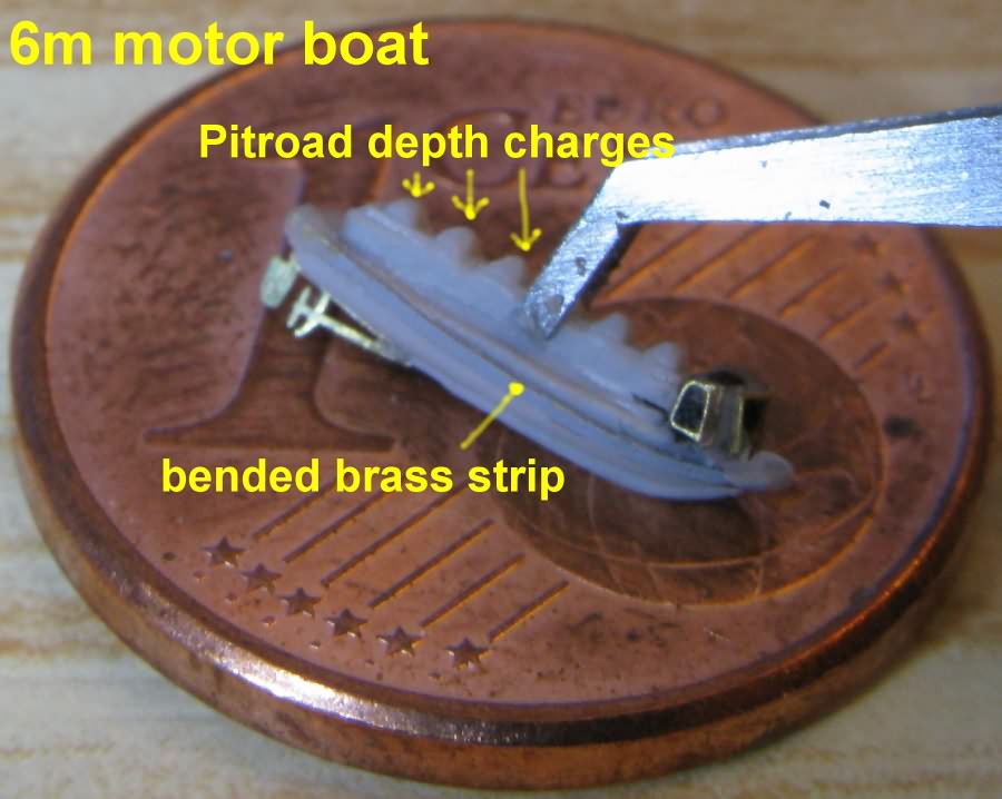

Now I started to detail the rear area. Because no place for my huge fingers I glued the ship to a metal tool.
File comment: Subchaser12
I decided to use the Fine Molds davits.
File comment: Subchaser13
Finally I found a solution for the twin 13mm. It was part of the Lion Roar 25mm AA gun set II (LE70042).
File comment: Subchaser14 - LionRoar twin 13mm
Lion Roar made a mistake here: The guns are only deep etched from one side. Therefore, they should be mirrored. This is not the case. If you want to assemble both with the etched side out one has to be upside down with the magazine pointing down. I fixed this partially.
Depth charge magazine is from Lion Roar, depth charge thrower from Flyhawk and depth charges from Voyager.
File comment: Subchaser15 - Depth charge equipment
Dirk
