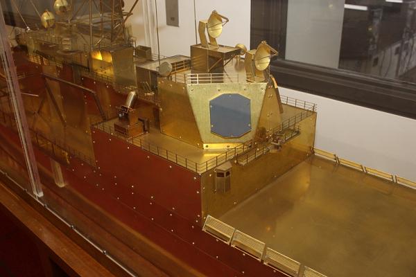

Despite the four existing ships being ruined and destroyed, eleven ships of this class were initially ordered. Construction halted after the initial 4, because there was a concept to continue the class but equip it with the Aegis weapon system! This would have provided nuclear powered Aegis ships...“unlimited steaming Aegis platforms”. These ships would have been heavily armed and capable escort ships for nuclear powered aircraft carriers.
The ships would have been armed with the same weapon system as before: 2 Mk26 launchers, at least 8 Harpoons and 2 5”/54caliber guns. Because this debate continued into the 1980s when the Mk41 VLS was coming on board and the Mk26 was discontinued from production, there was a suggestion that the ships would have been armed with Mk41 VLS in addition to Aegis while being nuclear powered. If that modification had been constructed, the ship would have carried TLAM, SM-2, ASROC, and at least 8 Harpoons. With the addition of large amounts of TLAM via VLS they would have bordered on "capital ship" status.

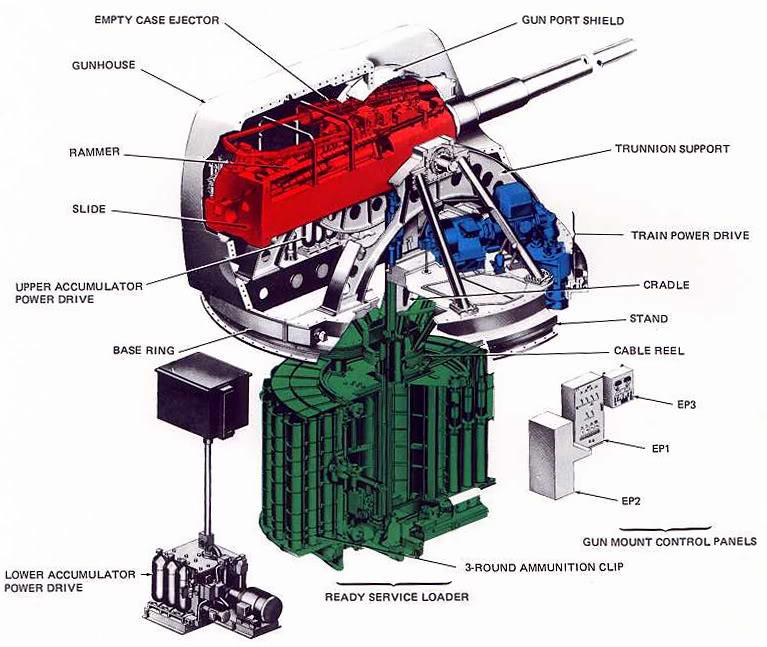

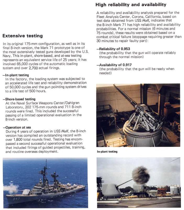

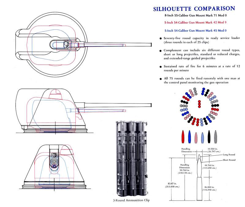

I propose instead of sinking years and years and billions of dollars into reinventing the wheel, why not take the Aegis modification of the Virginia-class CGNs and update them with modern SPY-1D, Mk41 Mod15 VLS, and 16-32 harpoons in order to fill the role of the next class of cruiser. This would begin construction years ahead of other schedules, require less R&D costs, only require modification of vertical and 90 degree edges to reduce the ship's radar cross section, and if the Navy had the testicular fortitude provide the ships with a modern version of the Mk71 8" Major Caliber Light Weight Gun, the ship would indeed be a capital ship capable of not only performing missile strikes but major caliber gun strikes as well. With each 8” round carrying the equivalent of a Harpoon ASM impact and destruction, the 8” gun provides a very effective anti-ship and a land-attack capability. The best thing about the Mk71 is that it is 100% proven and ready for employment aboard USN ships. I would only suggest its electronics and gun shield be modernized.
One might suggest the Advanced Gun System (ASG) instead of the Mk71. When one examines the capabilities and level of development one discovers that AGS is a terribly large gun system that provides inferior fire for ship roles, both in NSFS and NSuW. However, since the Mk71 8" gun is simply an expansion of the Mk45 5" gun, delivering 75% more ordnance than a 155mm (AGS round) and 250% of a 5inch round, incorporating the 8inch gun would only require a larger base ring than the Mk45 5", a slightly larger magazine, and it would deliver a far superior precision guided round onto either ship or shore targets. The large amount of surplus volume inside the hull, 600 8inch rounds forward and 475 8inch rounds aft, would provide this ship with an anti-ship and NSFS capability unheard of since the WWII designed heavy cruiser USS Newport News!

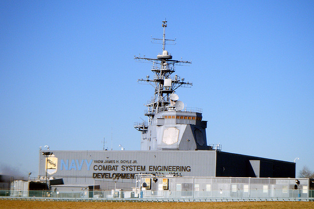

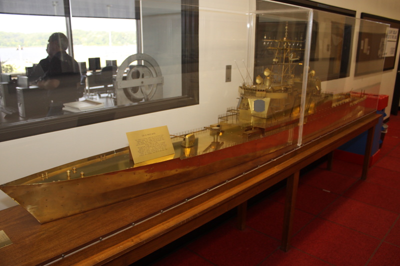

Because the Ticonderoga-class was literally an Aegis adaptation of the Spruance-class destroyer, and the Arleigh Burke-class DDG was "the great compromise ship", the expanded Virginia-class CGN with 128 VLS tubes, 2 8" guns, facilities for 2 HH-60 helicopters, SQQ-89(v)15 sonar, 8-32 Harpoon missiles, thicker armor protection, and nuclear power, actually steps into a true "cruiser"-like capability. The rest of the ship literally falls into place with little R&D costs.

Where is that brass model?

Oh, and the brass model is in the Rickover building at the Naval Academy.

Mmmmmmm....sex.
With exception of the mast, this is what the forward structure will look like.
